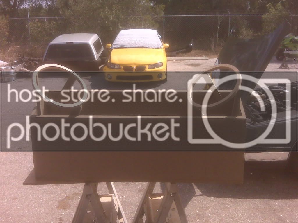

i think im gonna make my own, and i used a calculator online, and i got the dimensions so that with the ports, i have about 1.8 cubic feet per woofer
The easiest would be to do a common chamber single slot port. Go to http://www.reaudio.com and use their box calculator. For two 12's with 1.8 cubes each, you'd want around 45-50 sq. in of port area and then fiddle with the dimensions until you get 3.4 cubic feet (net) with a port that's around 50 sq in. area tuned to your listening preference, anywhere between 32 and 38 Hz will be great on music.
what would happen if i had 58 sq inches of port space, because thats what i got when i put in my demensions and got it to my frequency ( 36Hz )
The easiest would be to do a common chamber single slot port. Go to www.reaudio.com and use their box calculator. For two 12's with 1.8 cubes each, you'd want around 45-50 sq. in of port area and then fiddle with the dimensions until you get 3.4 cubic feet (net) with a port that's around 50 sq in. area tuned to your listening preference, anywhere between 32 and 38 Hz will be great on music.
and if you use the calc it will give you almost the same dims I did (I just put port in center for looks)just go see csu87 he's in your home town he'll fix you up. besides will be easier w car in front of him maybe he can squeeze some cubes out of your "max dims" good luck
p.s. dnick by the way 1.8 +1.8 does not equal 3.4 lol just bustin your balls lol
Dnick454 you still the man though cuz now i can do this
