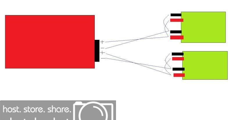

well basically on Sonic the only 10 inch alpine type r's you can get is either a dual 2 or dual 4. ohms is impedance. as ohms go up, power goes down. MOST amps can handle two ohms easily. ill work on a diagram in paint.
so the amp is red, the subs are green, the positive terminals are red, and negative is black. the blue lines are wires. the way a drew out is called wiring in parallel, to reduce ohms. those green subs, are 4 ohm voice coils. because its a dual, then you need to wire them in parallel, making each sub a 2 ohm sub. then you plug them into the amp. the amp sees a pair of 2 ohm subs, and outputs the power it needs to.

i understand alot more now because of your diagram
and as an example, you could also further reduce the ohms, by wire the 2 subs in parallel with eachother. to do that you would take the negative wire coming out of the first sub, connect it to the negative on the 2nd sub, and the same with the positive. then run those 2 wires to the amp, and bridge it( or use both channels, to get all the power you can). that would however make the amp see 1 ohm, which many cheap amps cannot handle, and theyll burn up and stuff. that was just an example though.
