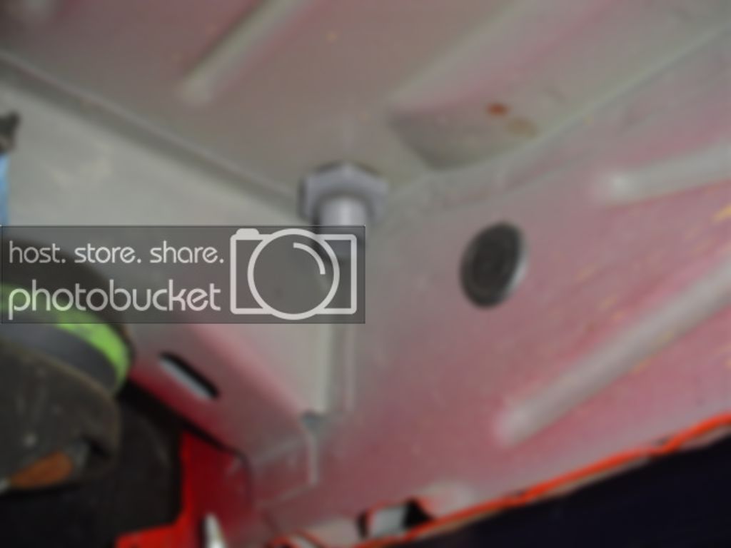

re doing my ground
Any metal you can find will be good, try to use a pre-existing bolt, so you don't have to drill (and possibly drill through your gas tank...its easier than you think).
MAKE SURE to sand down the metal and clean it.
