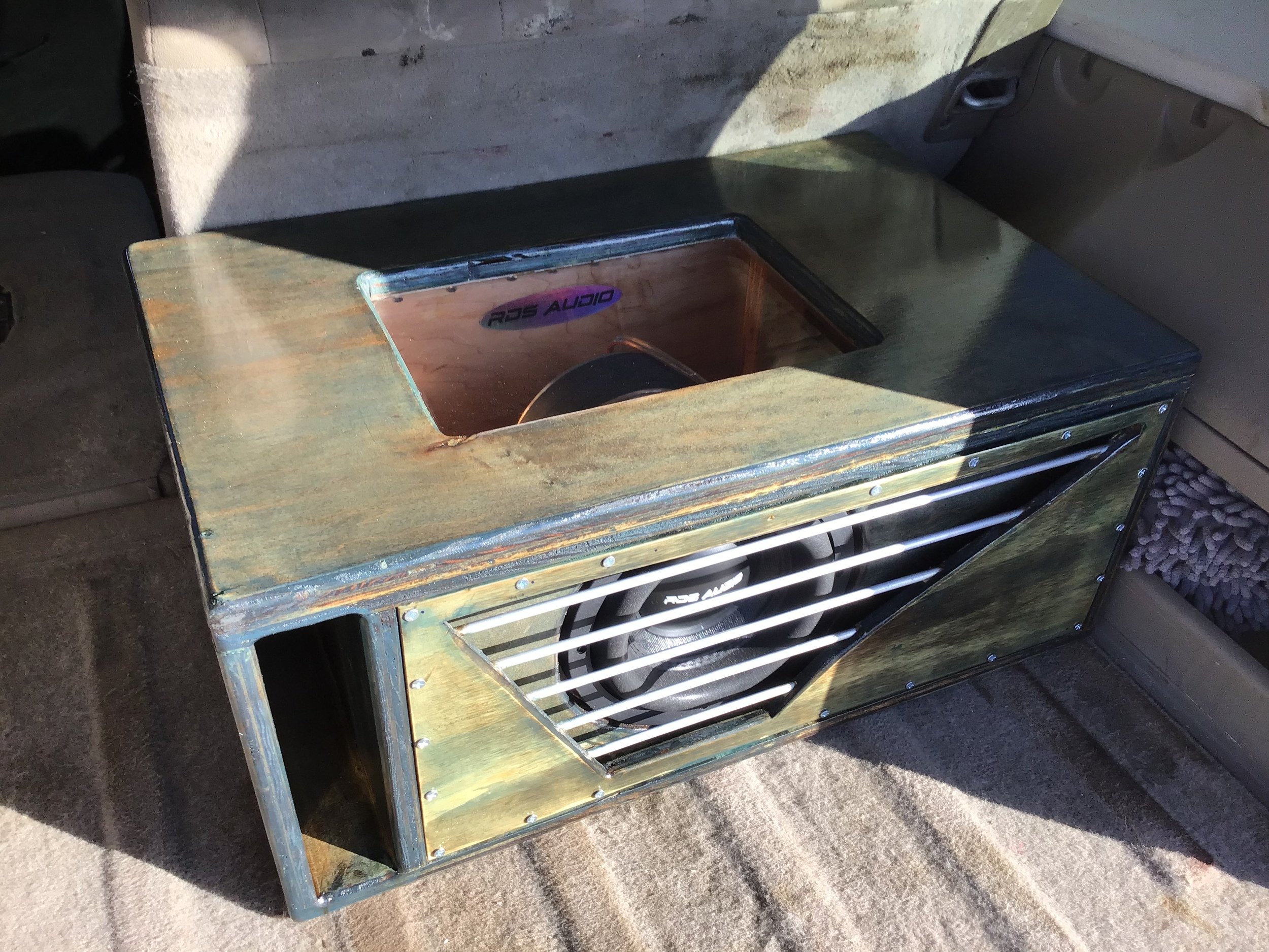

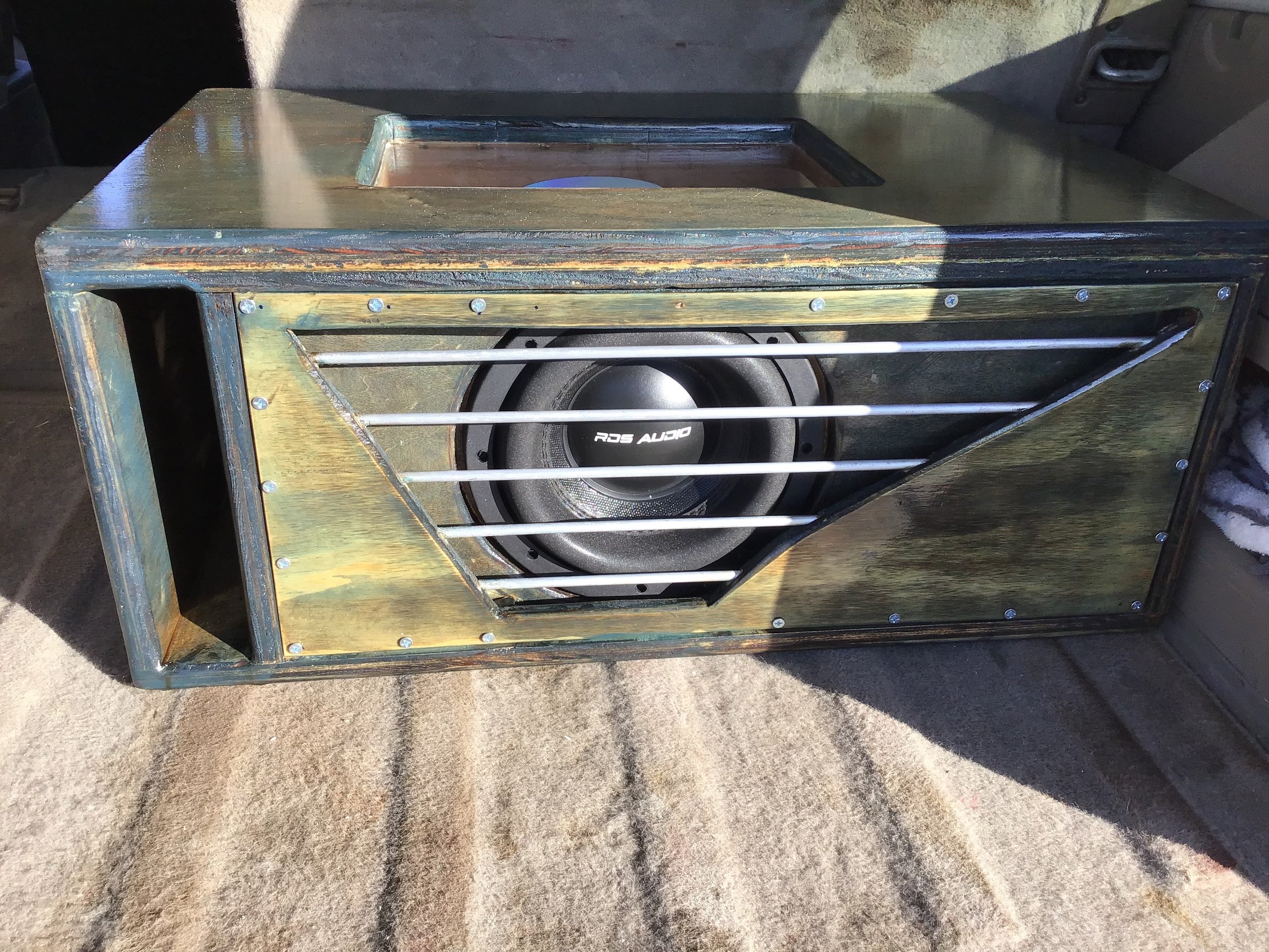

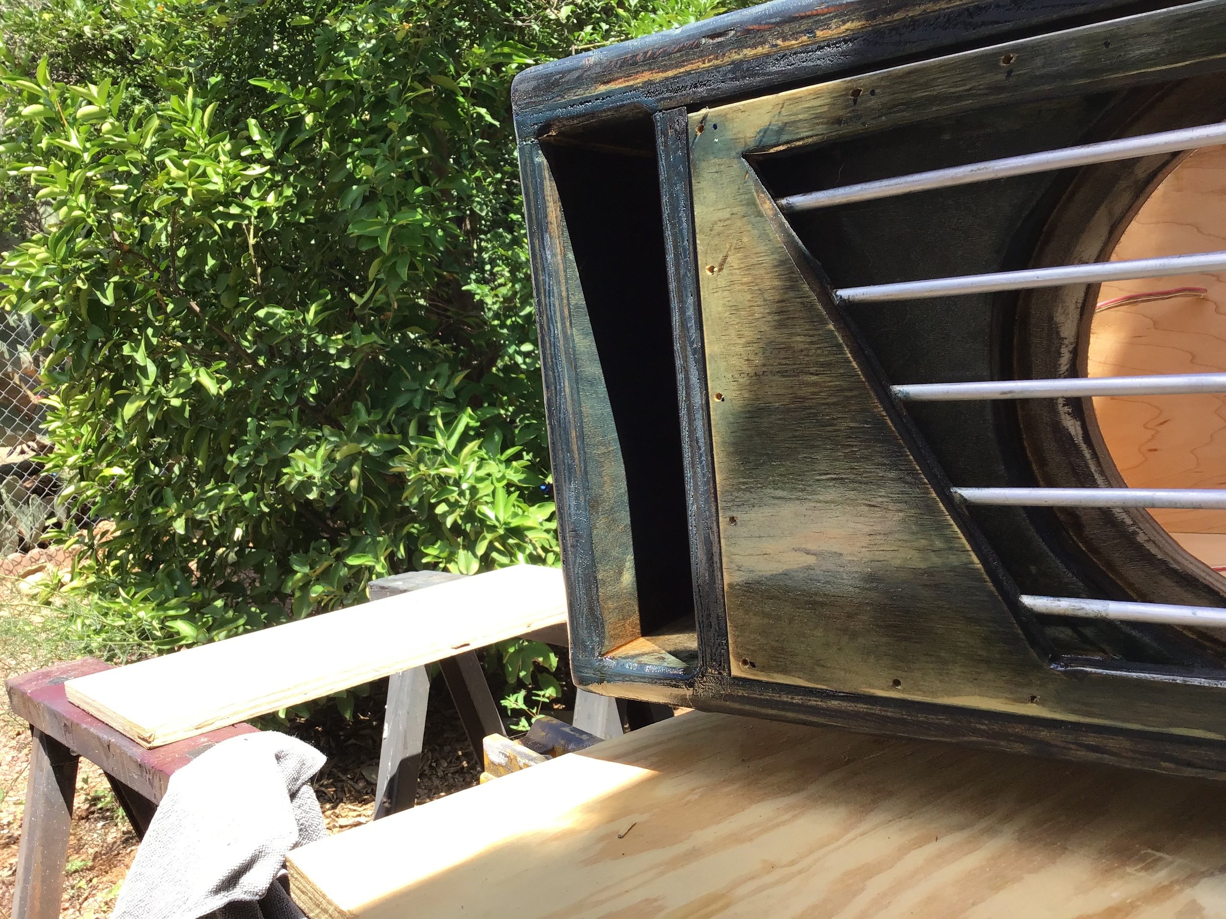

making sure the lexan doesn’t flex or rattle. The mint isn’t bouncing so that’s good. The grill doesn’t rattle either and the sub doesn’t hit it, but it’s close.

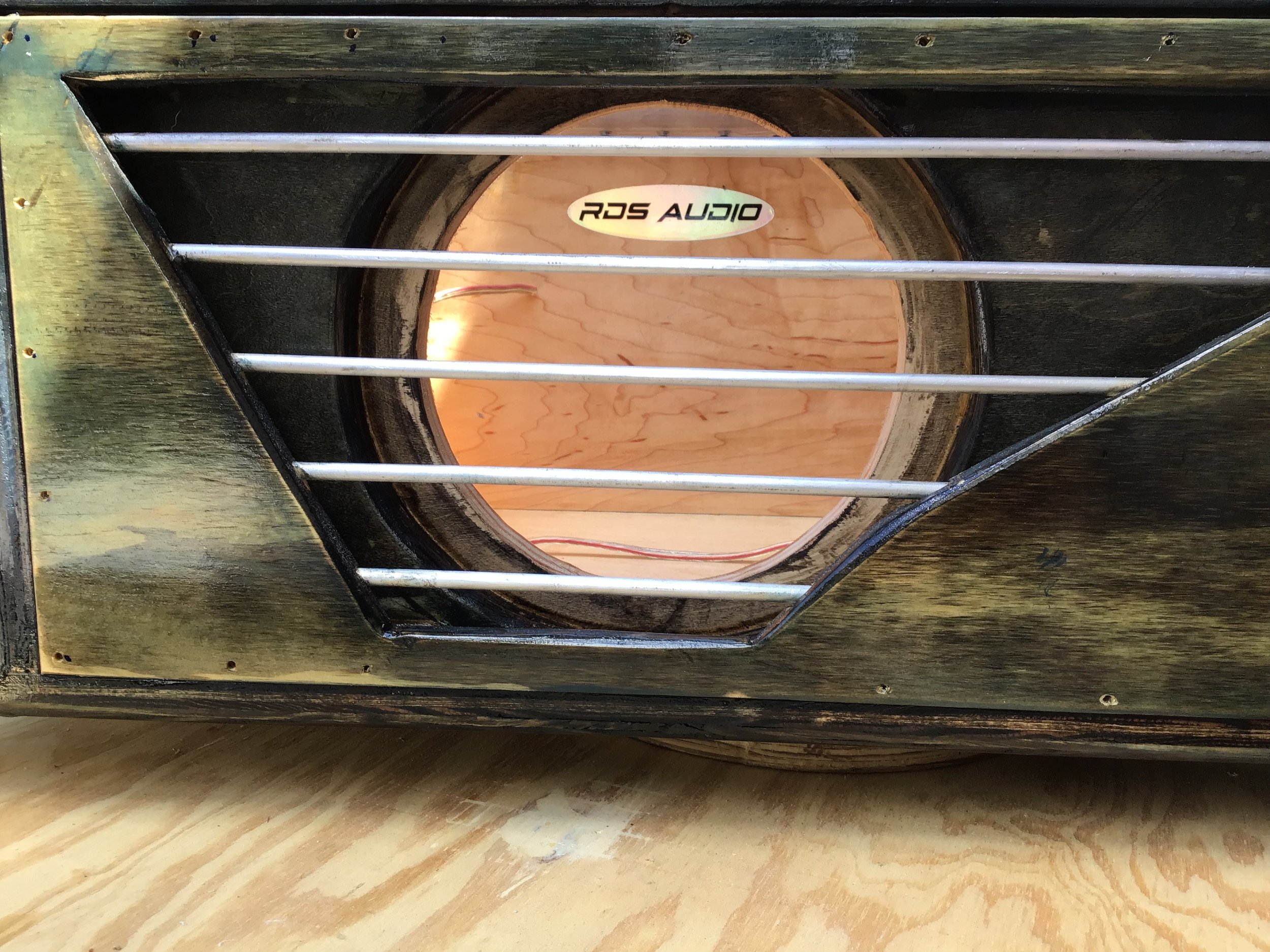

You're grills with the bars are so damn clean dude! When I finally get around to building the box for my buddies accord, I have to ask how you go about doing them and what materials you use. Seriously dude, so f*cking clean!
Thanks man. I should’ve taken pictures of the back side. I basically just make the wood frame then router in slots from the back side for the rods to sit in. Fill the slots with some clear silicone, push in the rod down and staple it.
