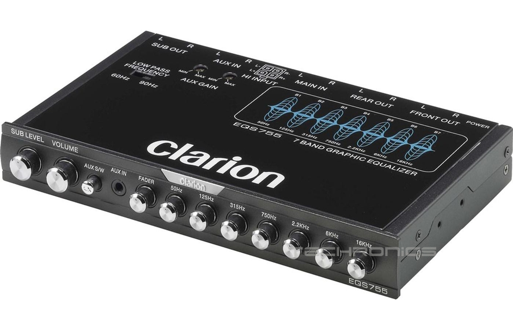

i ran 2 RCAs out of my deck. 1 to my sub amp, one to my EQ. then 1 RCA from EQ to main amp. i didnt want to EQ my sub. i can tweak how the sub sounds with sub volume and xover with my deck
i have this mounted under my seat, love it
So you used y's to do this??? I never thought of doing it that way...I really am not as interested in the eq part as i am the levels, and fade...Its hard for me to change things on the fly with my deck...So 25 percent eq, and 75 percent controls....I must admit this seems to be a well built little unit for the price...The specs dont even look to bad...Thanks to both of you guys for the help...
i didnt use Ys. i used 3 pairs/sets of RCA jacks
1 set from deck to sub amp
1 set from deck to eq
1 set from eq to main amp
i dont have rear speakers. 1 set of comps upfront, 1 sub in trunk
