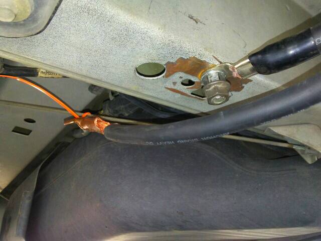

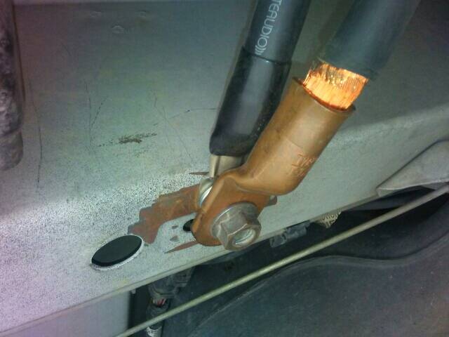

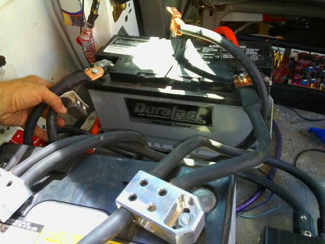

I have 2 neg. runs both going to the frame from both batteries in the back. Everything is 3/0 except one of those neg. runs to the frame is zero sky high wire. The lug on the 3/0 was loose so im in the process of fixing that and disconnected it.
Now its only the one 0 ground going to the frame. Now it is louder my output has improved tremendously with only this one ground and voltage is fine. Why?
One thing i forgot to mention was that the length of the 3/0 neg i removed looks to be kind of long than should be..maybe this is the reason?
Pics below of the 3/0 with loose lug and with the 3/0 removed (currently).

sounds like the 3/0 run was loose and since its at the same location, its making the bolt securing the 1/0 and 3/0 both loose as well even though it feels tight. I'd do a seperate dedicated ground for the 3/0 if you put it on. Might want to sand the ground area down even more as well.
