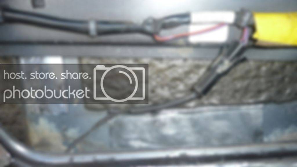

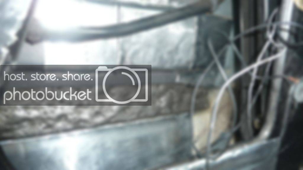

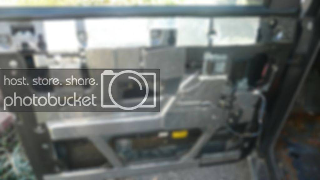

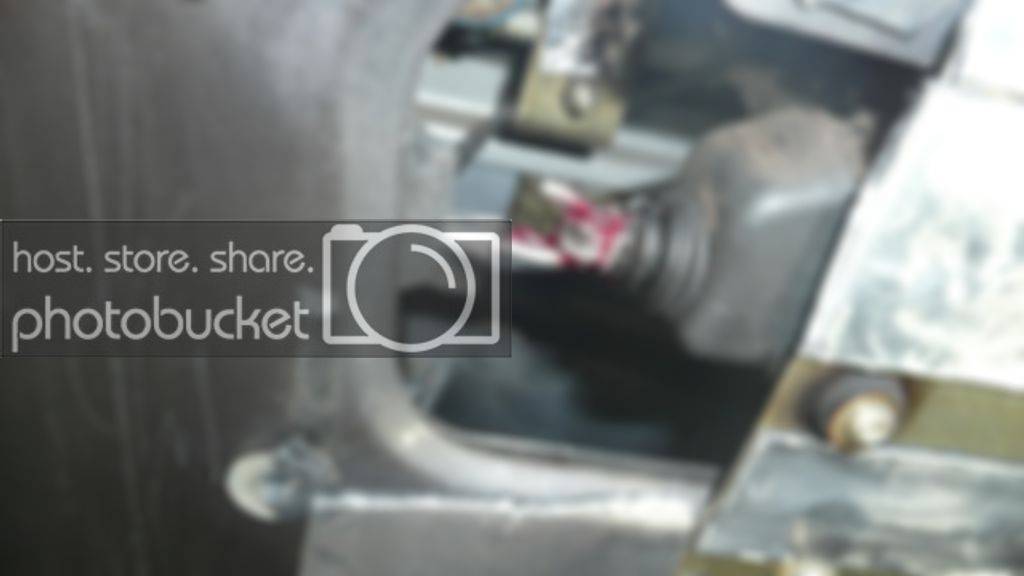

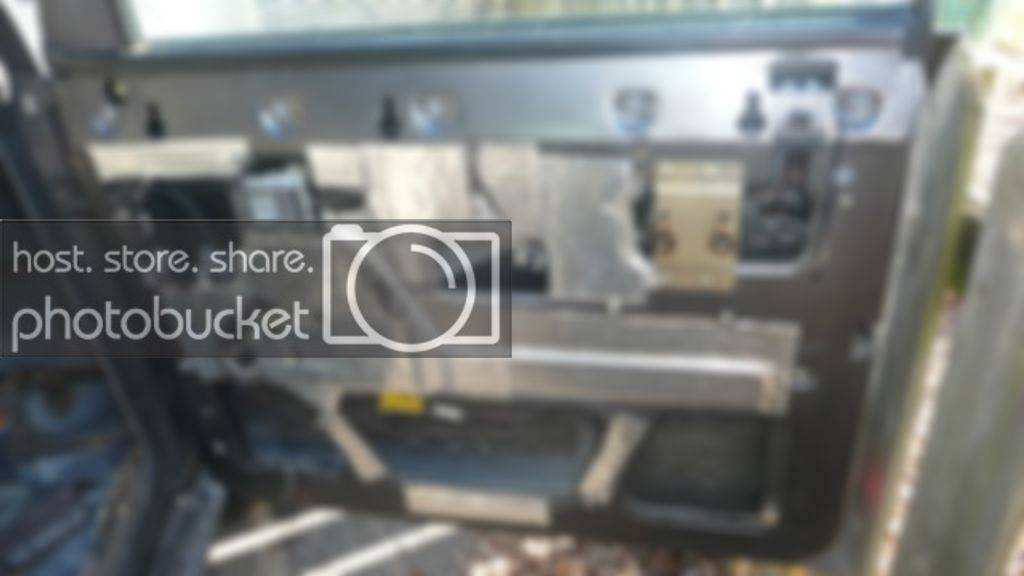

This is my first time really doing doors, if you could post what you think and SUGGESTIONS TO MAKE IT BETTER would be great!

Grease on annoying rattles (thanks "how to properly sound-deaden doors")
Weird Insulation
Passengers (not finished)

Try cleaning the outer skin with some ***-E-TONE and make sure it is clean and dry and try a small piece to see if it will stick to the OEM dampening, if it does, finish the outer skin and if it doesn't don't worry about it.
If you can remove the OEM dampening...I suggest doing so....I know in my car we had to use degreaser to get rid of that poor excuse for dampening....500 Square feet later....
okay, did you watch the vid? The outer skin seems pretty good, I also have damplifier on spots where there is no OEM stuff
Is it hard like plastic, or sticky/gooey?
What vehicle is this?
Its in a 1991 Range Rover, its somewhat hard but seems tar based and is a little greasy if you rub it hard
