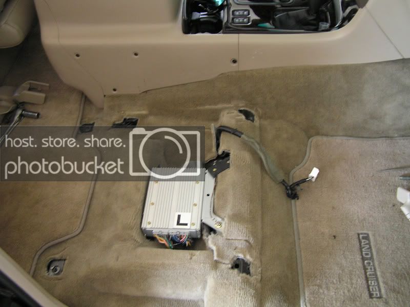

i do have a size restraint. I would like to keep it under my passenger seat. i do not have dimensions yet, but i do have pictures:
here is the stock amplifier:

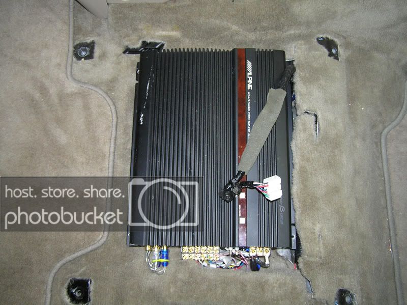

And here is an after market amp in the same spot.

Edit: i just went out for a quick measure...i only have like 12" x 10" for an amp at that position
