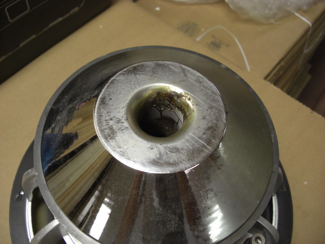

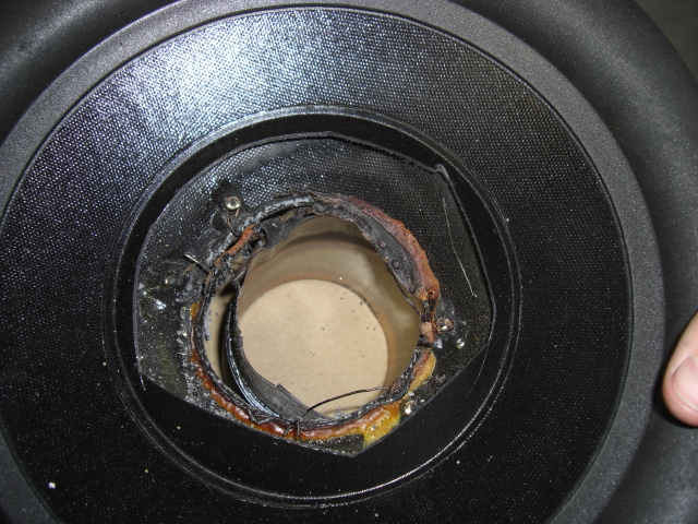

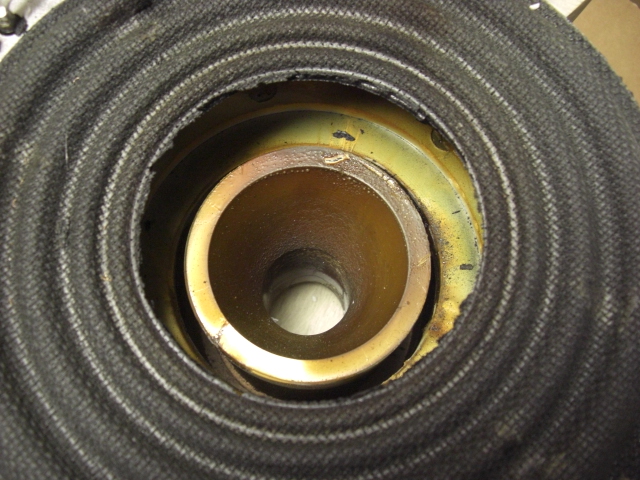

Yes... "Blownest" may not be a word... but I think it needs to be after seeing this woofer.

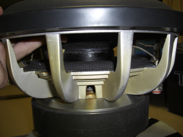

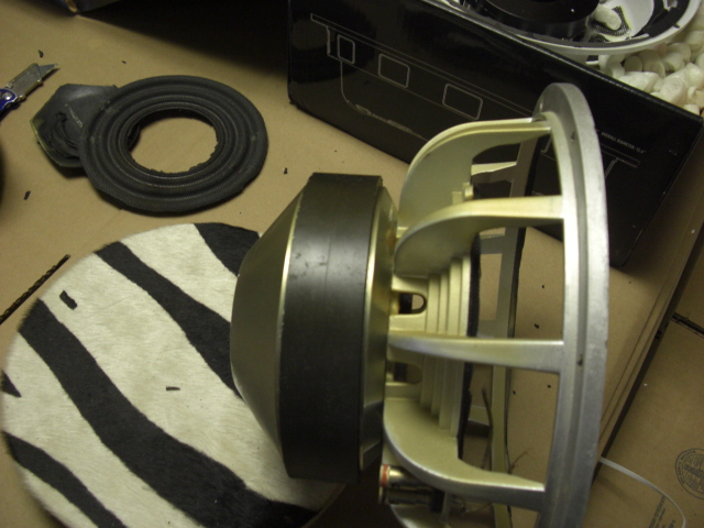

I do not know who this belonged to exactly but Nick @ SI is re-coning it at my shop today so we thoroughly documented the carnage. Just had to share.
* Thats not so bad, right ?

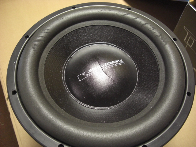

* Well... that isn't normal.

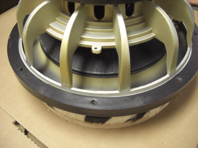

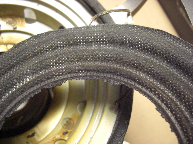

* Back of the surround should be gray.

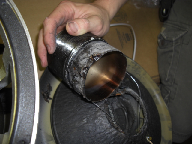

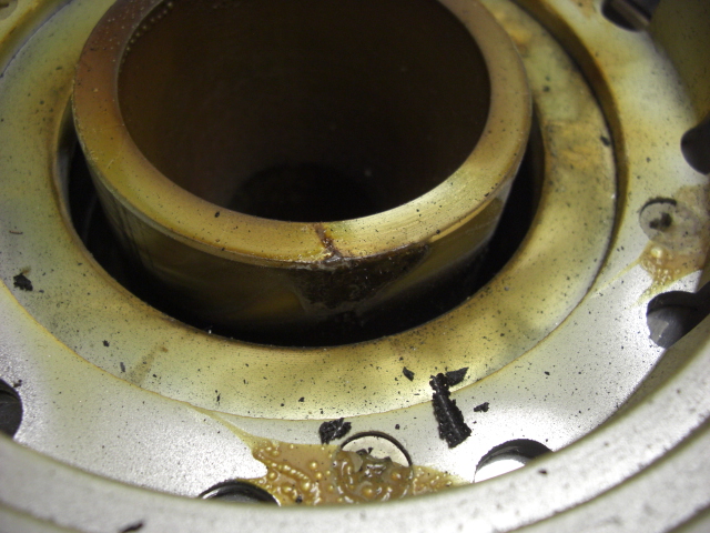

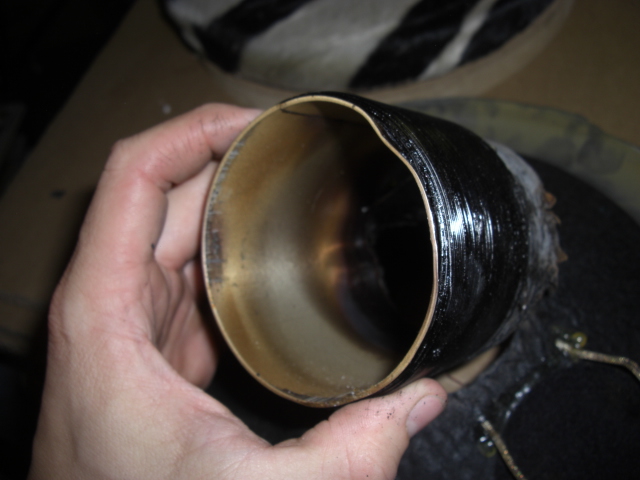

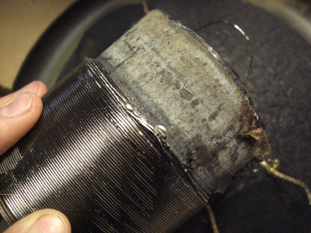

* Melted material and discoloration on the pole.
* Wow.

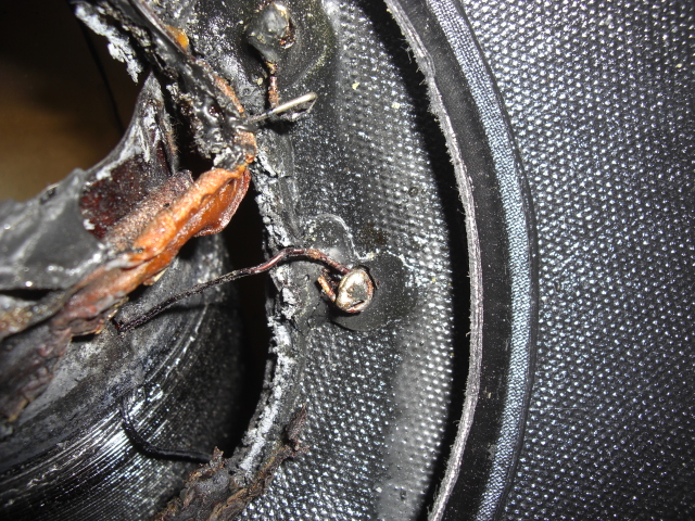

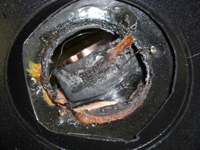

* Kapton wrap of the former is melted and puddled up on top of the triple joint.

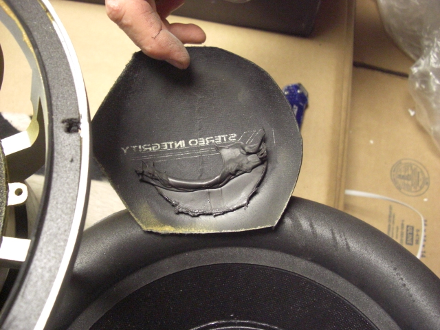

* That used to be a plastic former cap from under the dust cap.
* The solder actually re-melted...
A wall socket won't do this... I've wall socketed a ton of subs and nothing even comes close //content.invisioncic.com/y282845/emoticons/smile.gif.1ebc41e1811405b213edfc4622c41e27.gif
We aren't really sure what happened.
