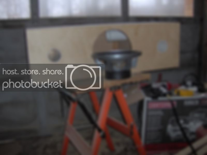

Well I finally got some wood and decided to build an ABC box for shits, grins, and giggles. I have to say, sounds pretty good.
AND BEFORE ANYONE JUMPS DOWN MY THROAT ABOUT THE INSTALL AND EQUIPMENT, it was just something to play around with. It was some old crap I had laying around. I am aware that its a cheap azz 10" Bazooka sub and an old Crunch V-200 amp. I still haven't broke out the good equipment yet. waiting for the right time.
I am still using the stock audio system, I just add a sub and amp via a LOC.
So, heres the pics.

hows it sound different to a regular ported or sealed, nice workshop/build.
First time Ive ever built a ported box of any kind. But it acually has a very smooth sound to it.
nice, how does the bazooka sound? i have two of those laying around and haven't herd them yet.
See above //content.invisioncic.com/y282845/emoticons/smile.gif.1ebc41e1811405b213edfc4622c41e27.gif
Very nice build!
Thank you!

What I understood/did was figure a ported box then add the second chamber 1/2 the size of the first and use the same size ports to join them and to port the 2nd chamber.
basically, you model a ported enclosure of optimal size with two identical ports. Then you divide the box into 2/3 and 1/3 and put one port in each chamber. Then connect the two chambers with a third identical port. viola ABC
