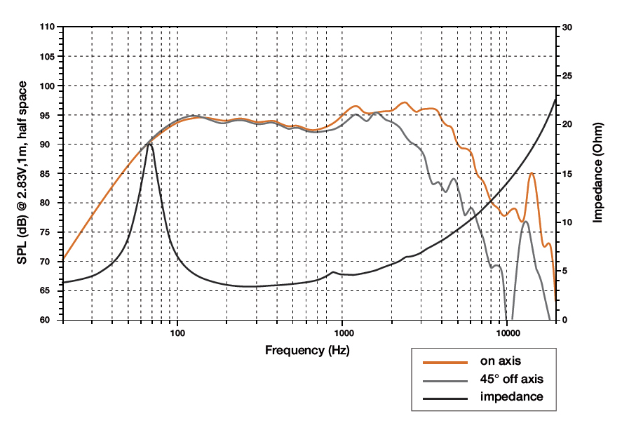

Well. My issue seems to be that I have a horrible peak in my 1-3khz range and I cannot figure out what's causing it. I can drop my door speaker to 1.25 khz and -12 db and that helps lower that peak but the 80prs doesn't allow mids to be crossed over any lower. I even have both 800-1.25khz at -6 on the eq. Still super peaky. I've been fighting this forever.

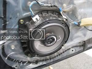

Install is on point. Everythings proper. i did leave the factory baffles because i didnt want to make mdf ones. It doesnt cause any resonance so i havnt bothered with it.
^^ not my car, just a google pic of the factory baffle.
Ive used the eq. 2-3khz can be tamed with the -6 db drops but 1khz is more than 6db at its peak and i dont understand why. its not a phase issue of boosting because i can switch phase all day long and it doesnt change. my best guess is that its just the speaker. It might even just be the passenger door because its on axis. I cant remember but i feel like if i brought down the volume on the just right door speaker, then it takes a lot of that peakyness away.
If you look at the response graph of the speaker. it goes go up about 3db at 1khz.. so maybe im just getting in phase speaker response from my l/r speakers and its boosting that particular freq band.
Don't be afraid to make fairly drastic cuts on the EQ if that's what it takes to make it sound better. You don't have unlimited crossover choices so keep those tweeters healthy and EQ away the peaks.
