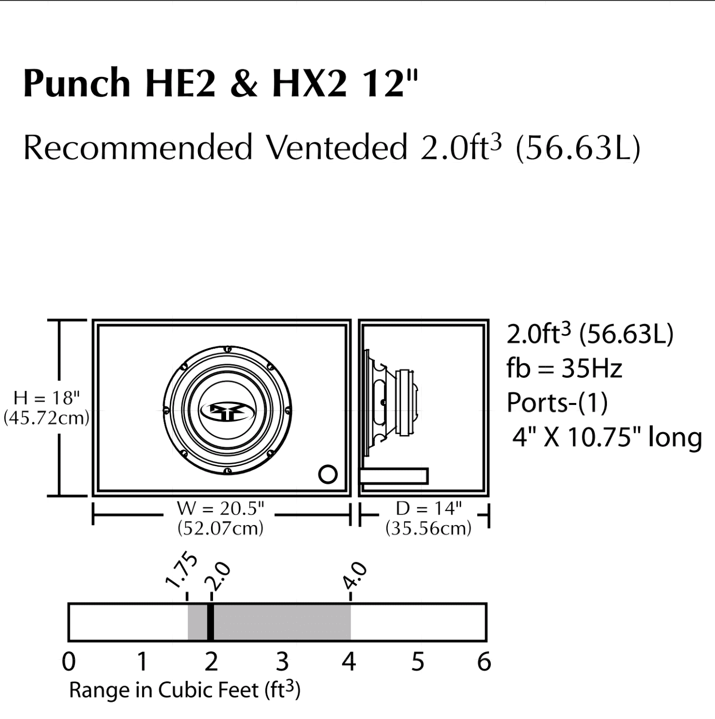

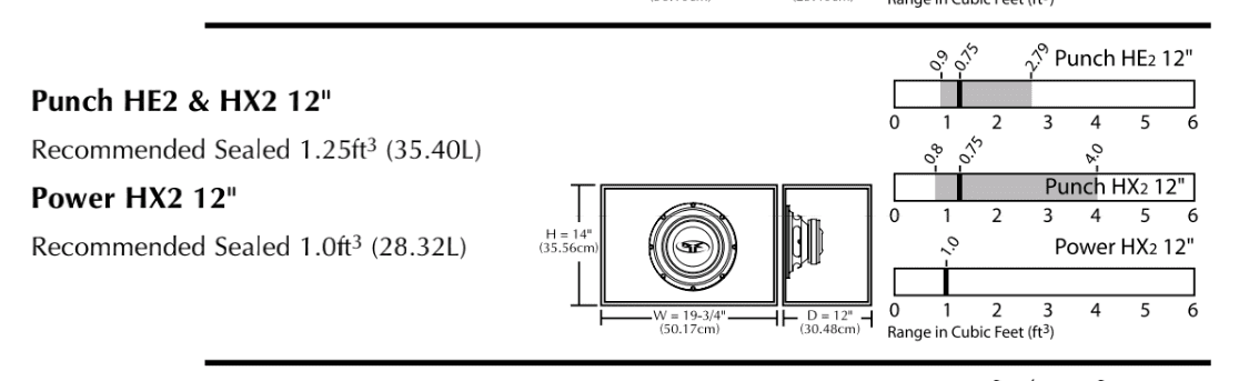

I only have experience with the Power HX2 10s, they get very low. I love that the HX2 series is very forgiving regarding box size. Rockford does not make junk and the HX2 series are very capable of impressive bass. Here are some specs:
