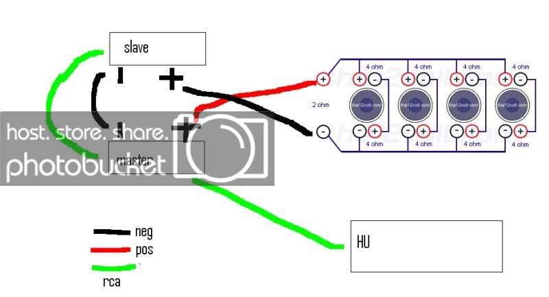

im getting two aq2200d, and am going to strap them. how does the wiring go on that? i know the 'strapping' wire goes between the amps. but, how which amp does the sub wire into? two each amp (4 subs going to be used a 2ohm)?
POS from subs goes to POS on Master, NEG from subs goes to POS on Slave. BOTH negs on amps connected together, RCA's to Master which controls everything, and single RCA from Master to Slave...

jsut to make sure, is this right?

....you didnt read up on my earlier post. im laying out the wire ahead of time, so i dont want to wait for the manual. so, i was asking if my picture above is correct
Yes, the pic is correct.

Doesn't strapping amps increase impedance rise?
Most 1 ohm stable amps are rated to do their power @ 2 ohms strapped (1 ohm per amp). Strapping is nothing like bridging a 2-channel amp, but it follows the same idea of the need to increase the ohm load.
