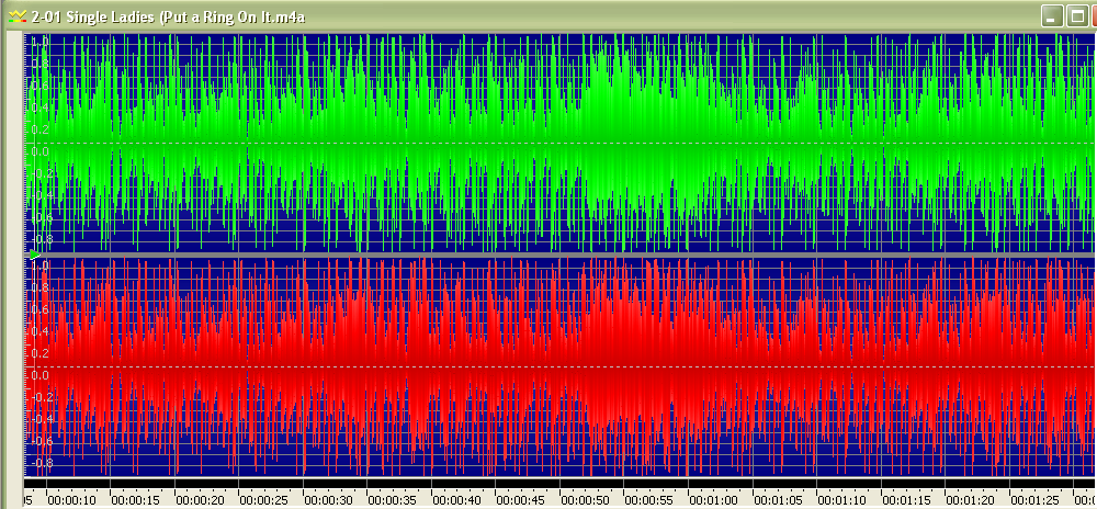

some more proof. modern music - Beyonce - All the Single Ladies. first bass beats - clip. why? because when you view the track after a 200Hz Low Pass Filter, you see a clean bass note near -0dB

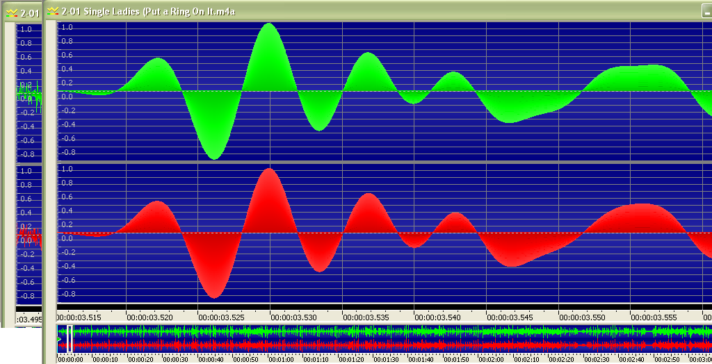

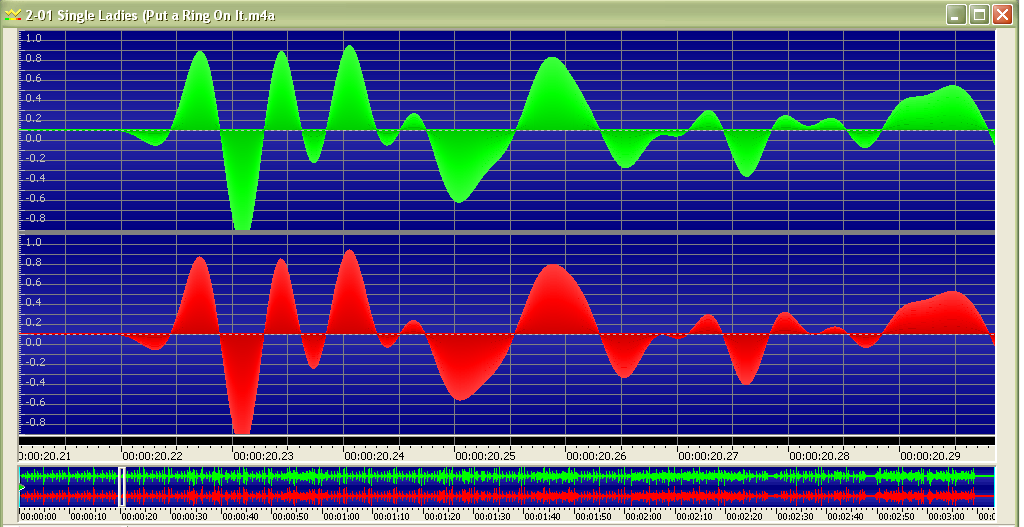

zoomed in. - clipping evident (and audible)

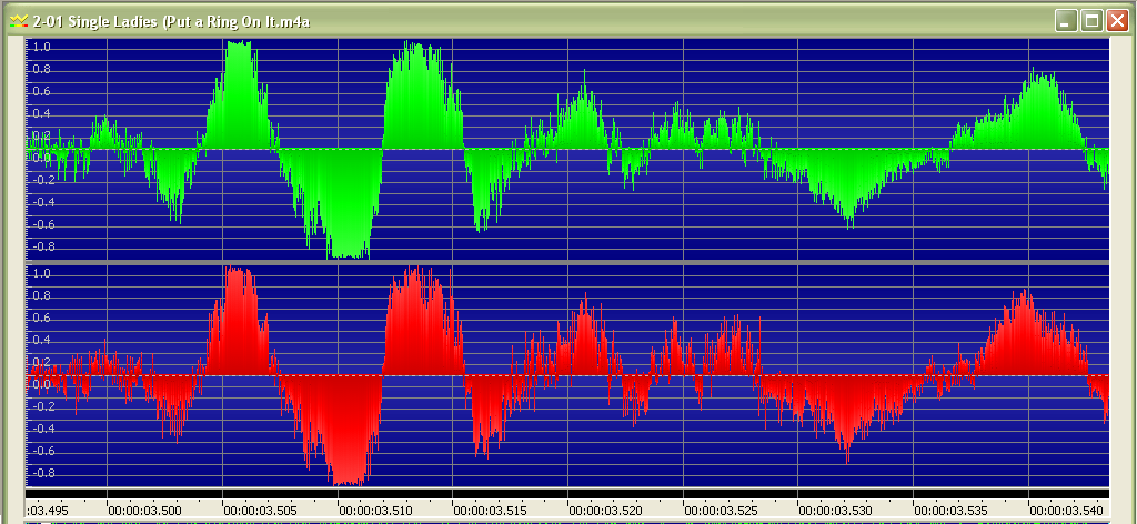

after a 200Hz low pass filter.
