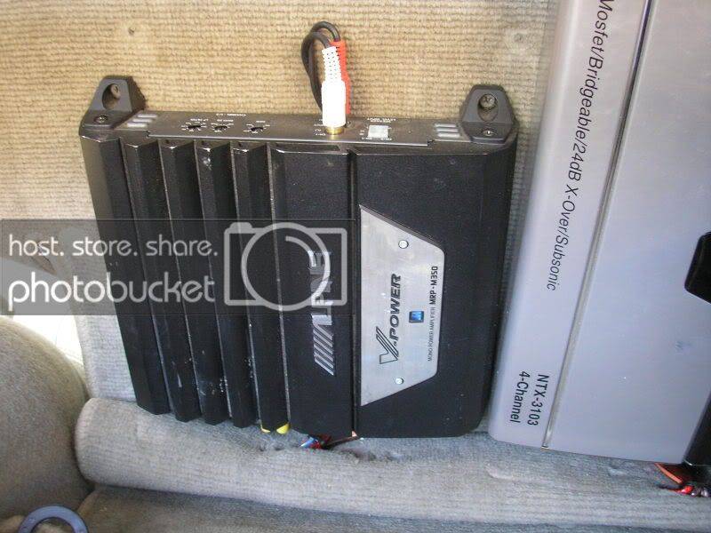

Just bought a pair of OZ vector 10's, single coil 4 ohm... got a hell of a deal I think
Anybody know the #'s on these subs? The box says 500W MAX but i dont know if thats RMS or peak....
Right now I am pushing these with a small Alpine MRP-M350 which pushes 350 watts RMSx1 at 2 ohms
(2 4ohm subs wired in parallel would make 2 ohms right?)
Is this amp dangerously small for this setup? I do plan on upgrading the amp but wondering if the Alpine is safe to use as a temporary (and to break in the subs)

max and peak mean the same thing. you want to find out their rms/continuous rating
the newest Vectors ratings are 350rms, 700 peak per sub
i bet yours are 250rms, 500 peak per sub
either way, youll want a much bigger amp
id probably get this for $250
http://www.audioque.com/aq/AQamps.htm
just go easy on the gain until you find out for sure what their rms is
Great link - thanks 4 the advice - why should i wire it in series, to quadruple the impedance before setting gain? Does it make it easier to hear or something? I do not understand this.
so youll only feed the subs like 75 watts vs 350 or more
its just to be safe, just for a minute, to set your gain, then wire them up in parallel and youre done
