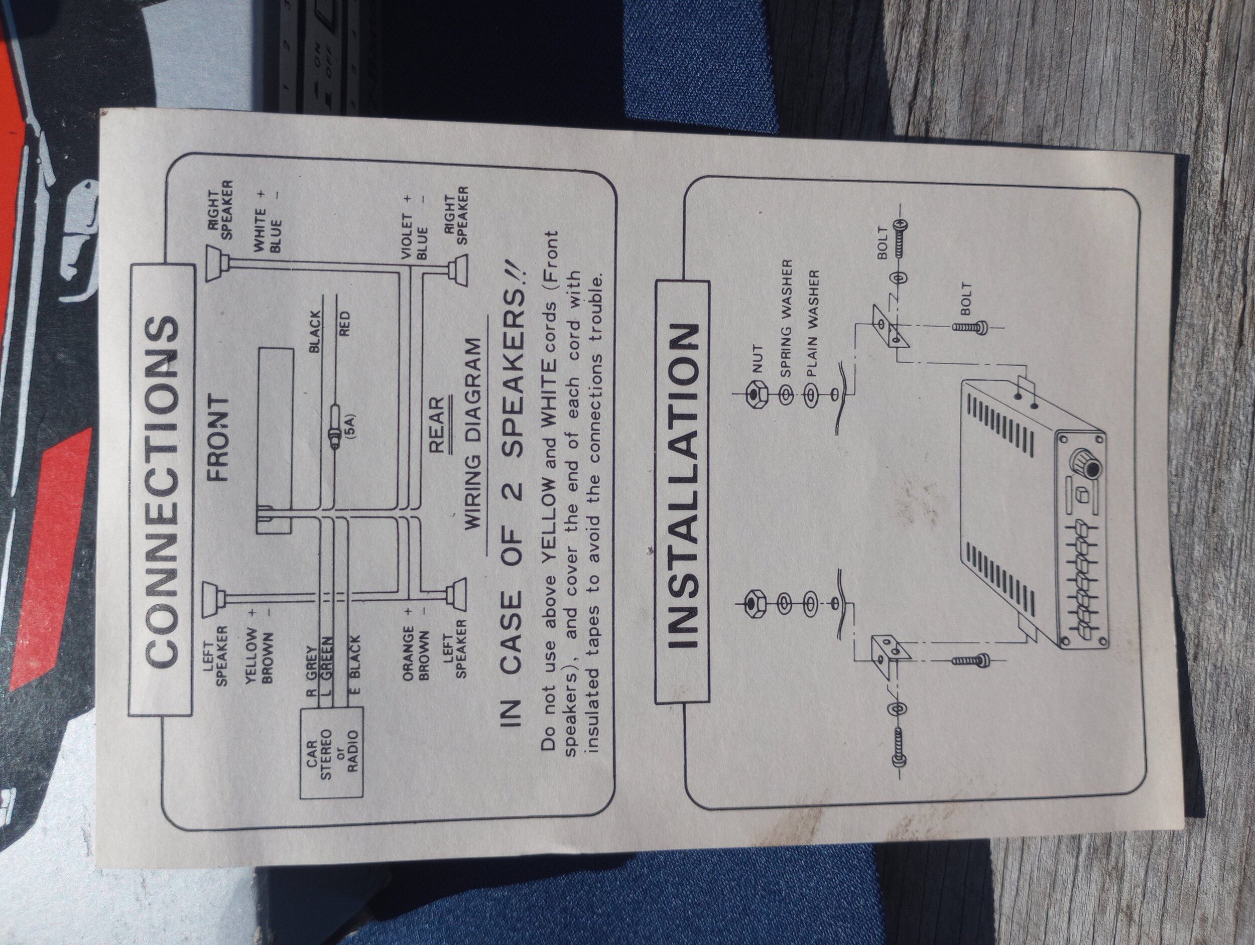

Hi, I was just given a Pyramid x702-L 300 wat amp/eq. It is old school, and there is no manual or wiring diagram that came with it.
Besides the red+ and black- there are 9 other wires.
white,yellow,orange,purple, (these go into fader)
brown, green,blue,gray, black, (go to 18 pin block which also has power switch)
Apparently it does not follow standard wire code,
Does anyone have any idea how to wire this?

I am trying to put this in a classic car and want to keep it era correct with the old school cassette head unit. I realize it isn't going to sound like the modern units I have installed.

I have 7 of these units brand new old stock for sale
