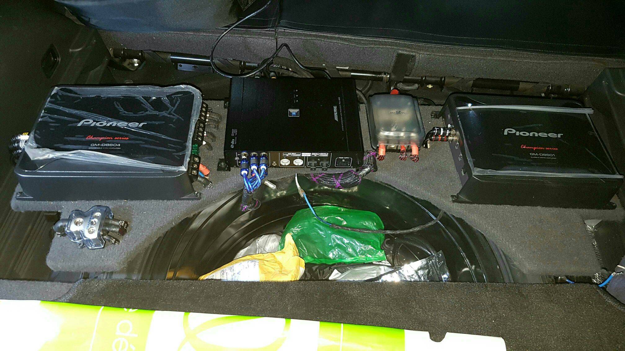

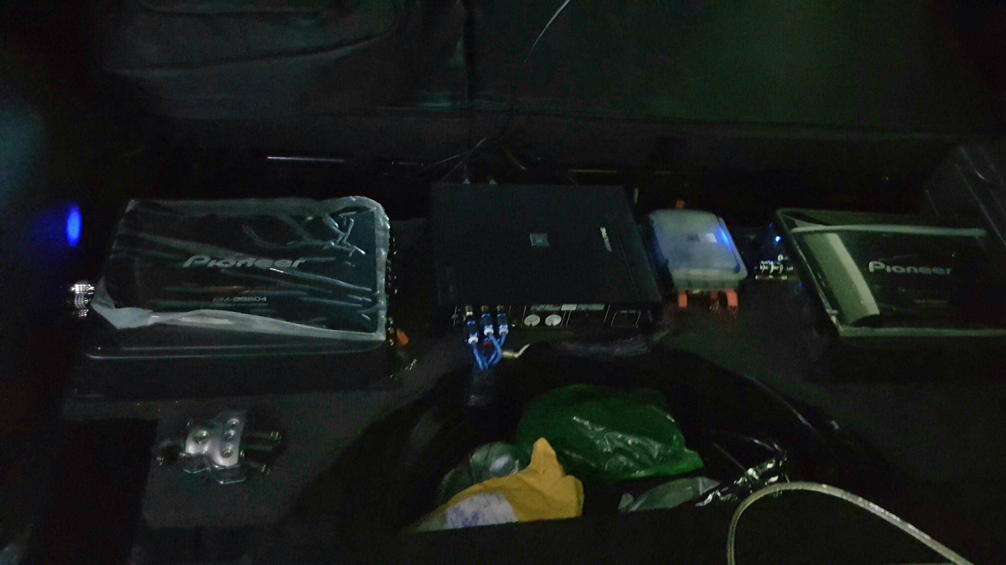

I have a 2016 tucson with an aftermarket headunit. It has a 6 channel RCA out. I was running just an amp (GMD 8604) powering my Pioneer 10" Shalow Sub and my Pioneer 1685 4 way back door speakers.
Now that i have decided to upgrade my whole set up with a POLK DB 6501 component on my front doors and a new mono amp GMD 8601 which will power my sub and will use the existing amp GMD8604 for my front and back doors. And also i have a PXA H800 in this set up. I have powered all the these (amp and dsp) with the same power line using a power block. I have connected the POWER, GROUND, REMOTE IN, and the RCA Input and Output.
I have reconfirmed that i have used the "REMOTE IN" and not the "REMOTE OUT" wire to power the PXA.
While i switch on the Head unit both the amps power up but not the PXA.
can anyone pleasehelp me out from this situation.

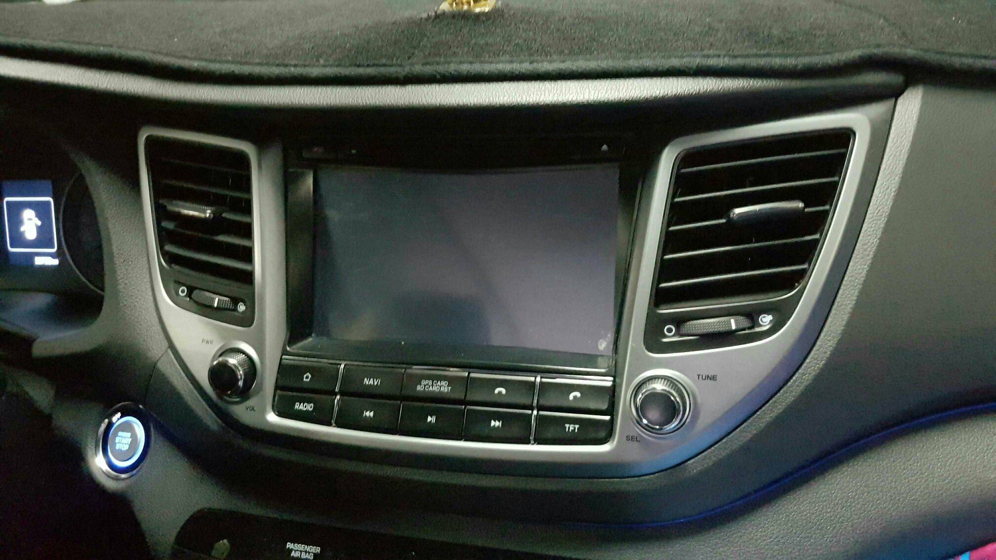

only way it will switch on without the rux is if you have an Al-NET headunit.wjat headunit do you have ?
I have an after market head unit
Sent from my SM-G935F using Tapatalk
---------- Post added at 05:39 PM ---------- Previous post was at 05:39 PM ----------
Without an AI-NET
that looks like a stock unit in the picture sir. if its aftermarket what brand is it?
Without an AI-NET
Yep! Alpine figured out a $200 RUX EXTRA superfluous REQUIREMENT to confuse us all with!
Sick sad and TRUE!! :-(
John Kuthe...
Yeah true buddy they just mailed ne telling that i will require a RUX. They should be selling it together with the pxa without wasting our time and money
