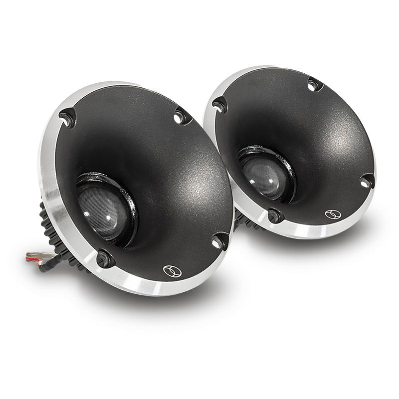

I can't do the larger subwoofers. I have 2 kids that sit back there and I need the room. I'll stick with what I got. I did however pick up a set of these tweets. I'm hoping I can fit them somewhere. I may have to customize my A-pillars.
Sounds (pun intended) like a plan! Excelsus have some very nice tweeters indeed! No issues with that selection at all!
