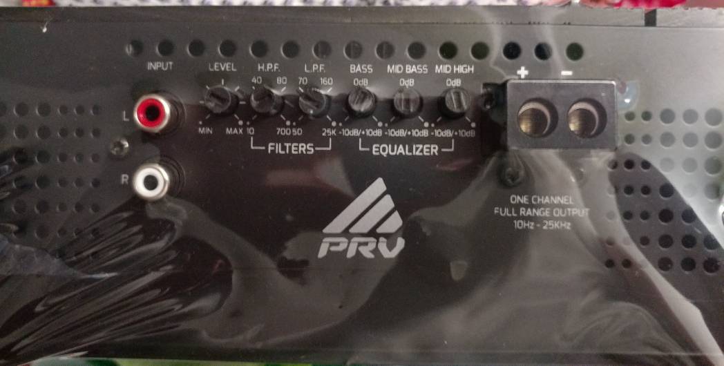

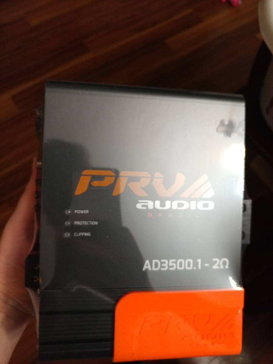

It is small. Smaller than my CT sounds 125.2. But this is very dense and feels well made. Nothing flimsy.
I hope tomorrow I get to install this. I hope to God that the fans aren't super loud!!

It's just really hard for me to wrap my head around that these amps actually do rated. They are so small.
Brazilians did two things right, produce big booty women and make tiny amps that do power

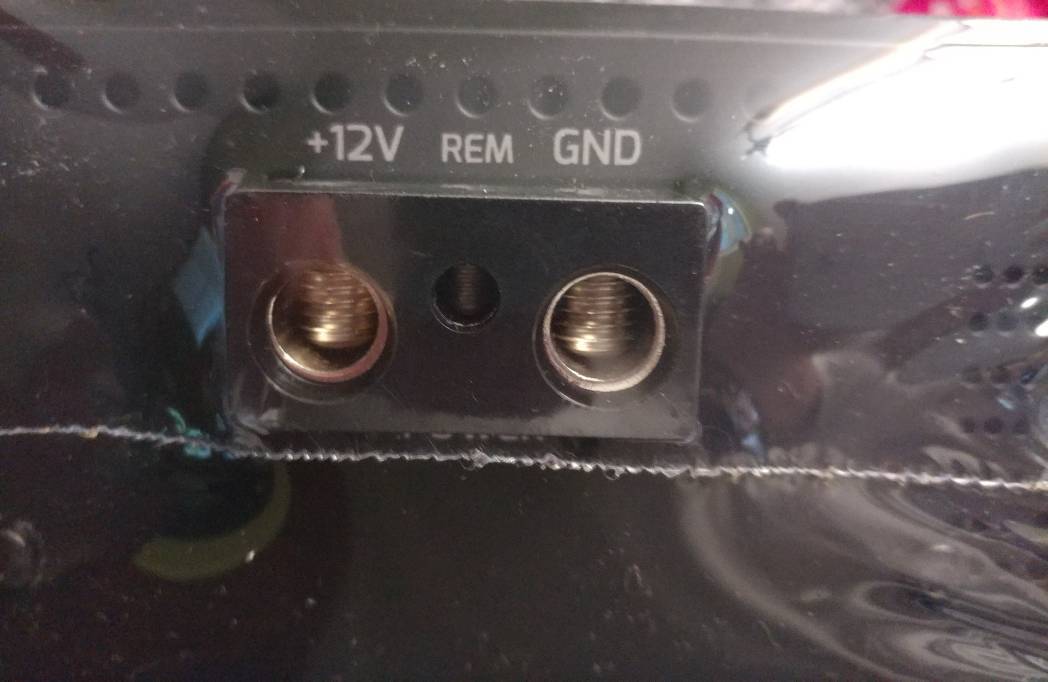

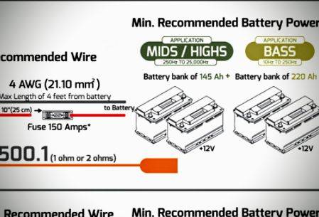

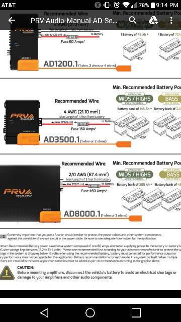

The manual, the part where it goes over power connections is confusing me. I know having a extra battery would benefit me but I didn't do it yet because I wanted the mechman installed first. I'm going to just do 0 gauge to a 4gauge reducer.
What do you think of this?

I cant read/blow that up The big 3 and two good batts with 0 ga supply would be fine till you get that alt in, but go easy on the gain..stay above 12v on a low note..

Put the alt in before the amp. Otherwise your going to be making a thread saying how my amp blew up.

That will be fine temp.Id run two AGM batts like I have if you have the room..with 0 ga supply and big 3 upfront batt run 0ga +to rear batt..)ga Ground at rear to the frame.come off - post to a solid distro block as well as a fused distro block make it easy to add a third batt later if needed,.Not sure what vehicle you have, but?I ran same batts in my CRV that are in my sig with a stock 80-90 amp alt with the ELD by-pass that most Hondas have, and ran my Matts @1500-1750 rms @2ohms mono on the daily..for 3-5 k its going to take a good 3-4 batts on a stock alt of 120-140 amp alt.to stay at 12v or better on alow note..you may see 11.6 on a low.Rpm of 1k-2k up in the 13s possibly?
I ran a short run 0 to all my sub amps..approx 18" from the distro fused block in rear..120 amp fused on ea..2-300s up front for two runs for 4 sub amps..changing to 3 after new alt on my rebuild
Be sure to get a 0,2,ga ANL fuse holder at the main batt..Id run a 200 be fine/shouldnt hurt anything on the 0 ga run to the rear..deff need a Fused Distro Block from rear batt/batts Poss?+ post from 0,2.- 0-4 ga..again, ANL fuses are my preference..Fuse for the amp there.Stinger make great Blocks and have never failed me over the years and Lord knows how many installs over the years.A solid Non Fused 0,2ga-0,4ga will be just fine as well,makes grounding so much easier

Its a 2011 Accord. 130amp stock. Big 3, AGM upfront 0 guage to the trunk. Distro for 2 two channel amps and a Clarion dpx15001. I don't have any issues with voltage right now. Stays in the mid 13s on big notes. I don't listen to decaf or anything bass crazy. Rap and mostly metal/rock. And Stern!!!
I got the mechman because I have put 150k on my car in three years and had a similar setup the whole time so its a preemptive upgrade.
I was going to hook it up today to make sure it works for one, and see how the fans are. Then install the alt and a battery in the back(now) ? Need to get a box built for my Sundown z12v3, or that OG XXX that's in the classifieds.

If you find yourself loosing out put it will be that ELD bringing you back down to 12v and kick back up once driving or running that RPM back up..It tappers from time to time to save fuel/a Fuel Economy feature that majority Hondas have and can get really annoying to say the least..LOL.Drove me Nuts till I found that Keep_hope_alive found a way to by-pass it to maintain voltage. I took the risk, and ran all the power I needed without doing a beef up on my roofing.Close to Creasing Im sure, but Ill never really know since its gone now..LOL..That joker Fired up every single day and drove me anywhere I desired
