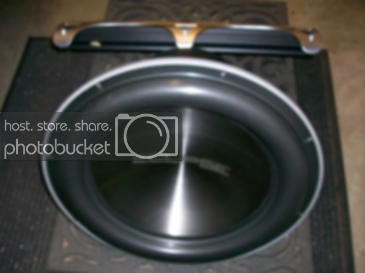

holy shit looks like someone used the cone for target practice
Oh and btw, the sub is in perfect cond.

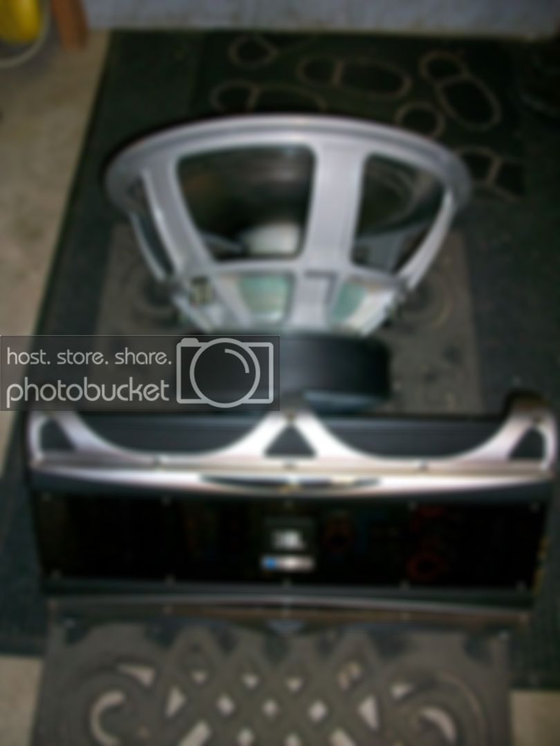

sry i tought it was the sub picture on the previous page.
either way it's not the same parameter anyway but thanks
