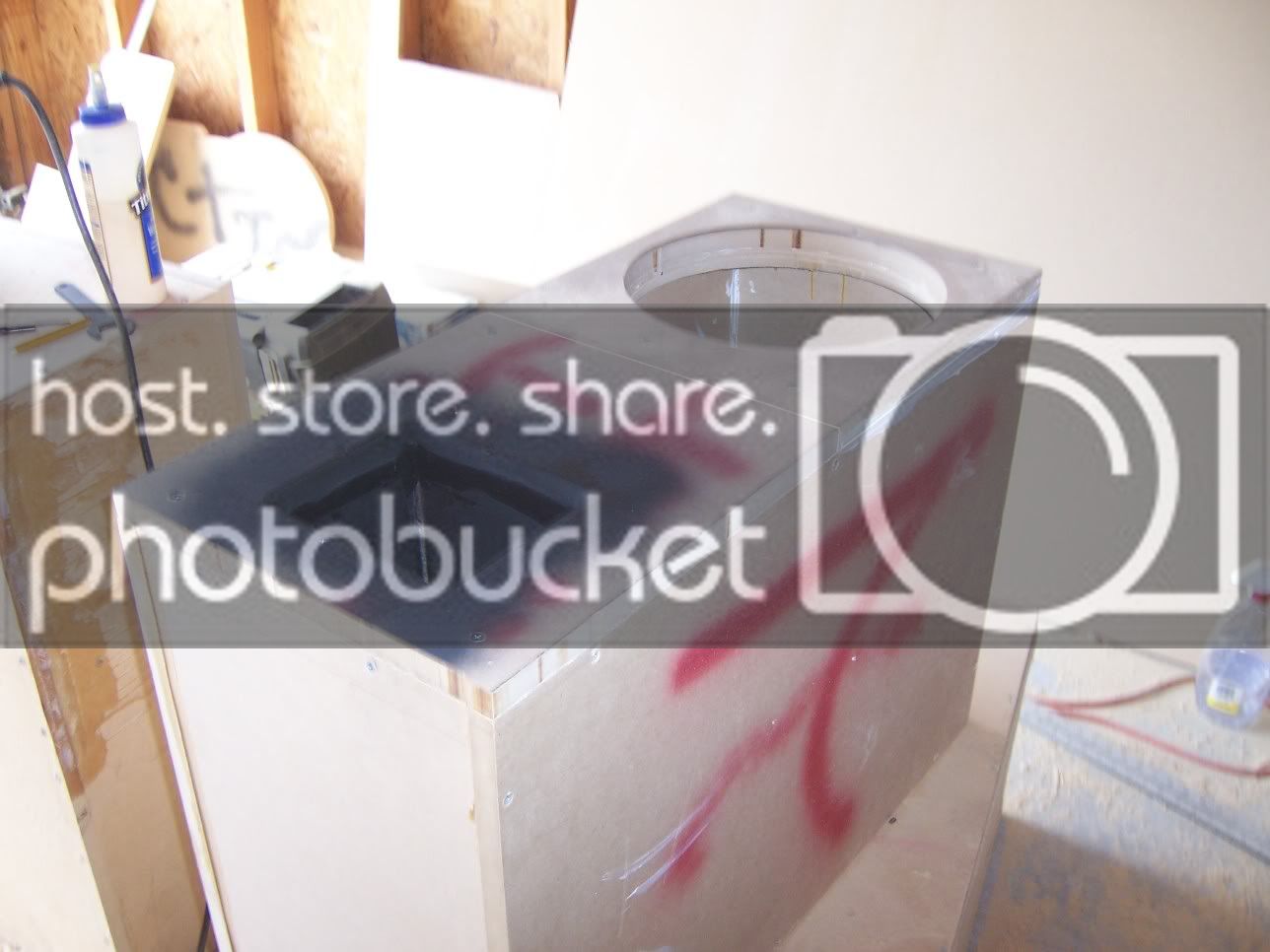

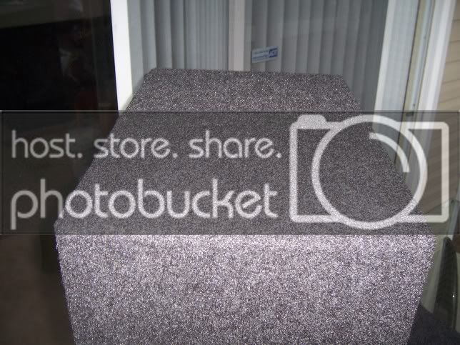

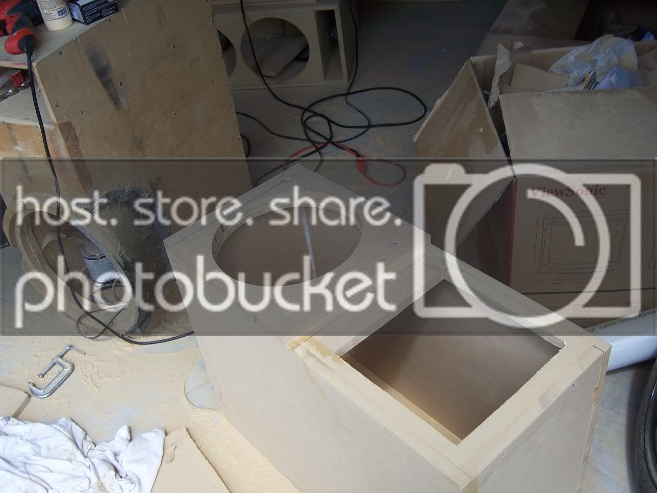

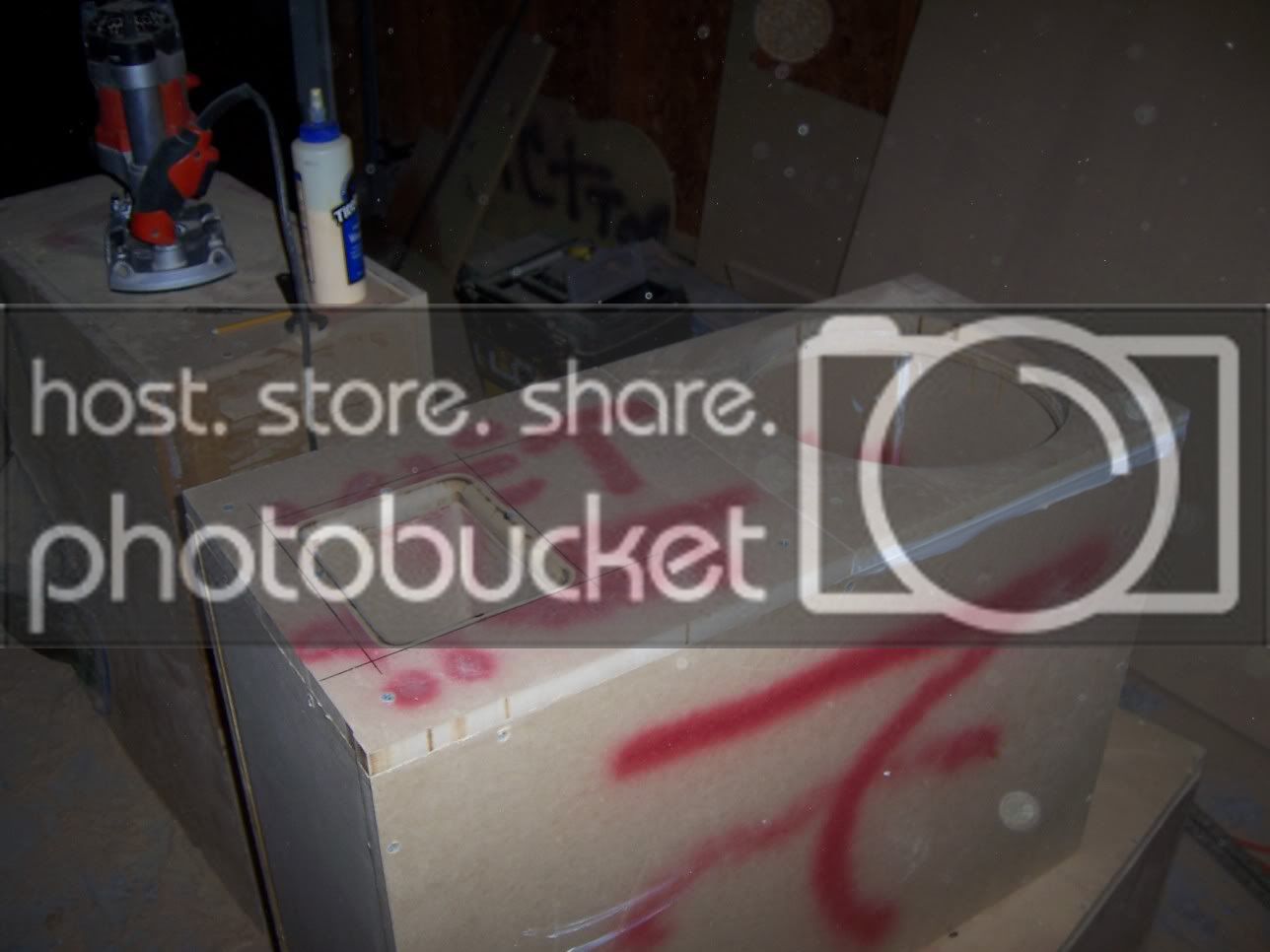

heres a good clean shot of the front of the box. in the end, the front is double baffeled. in this pic it is not.

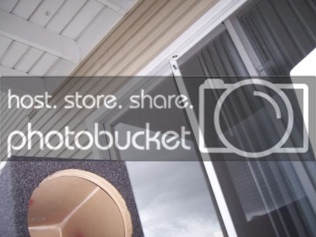

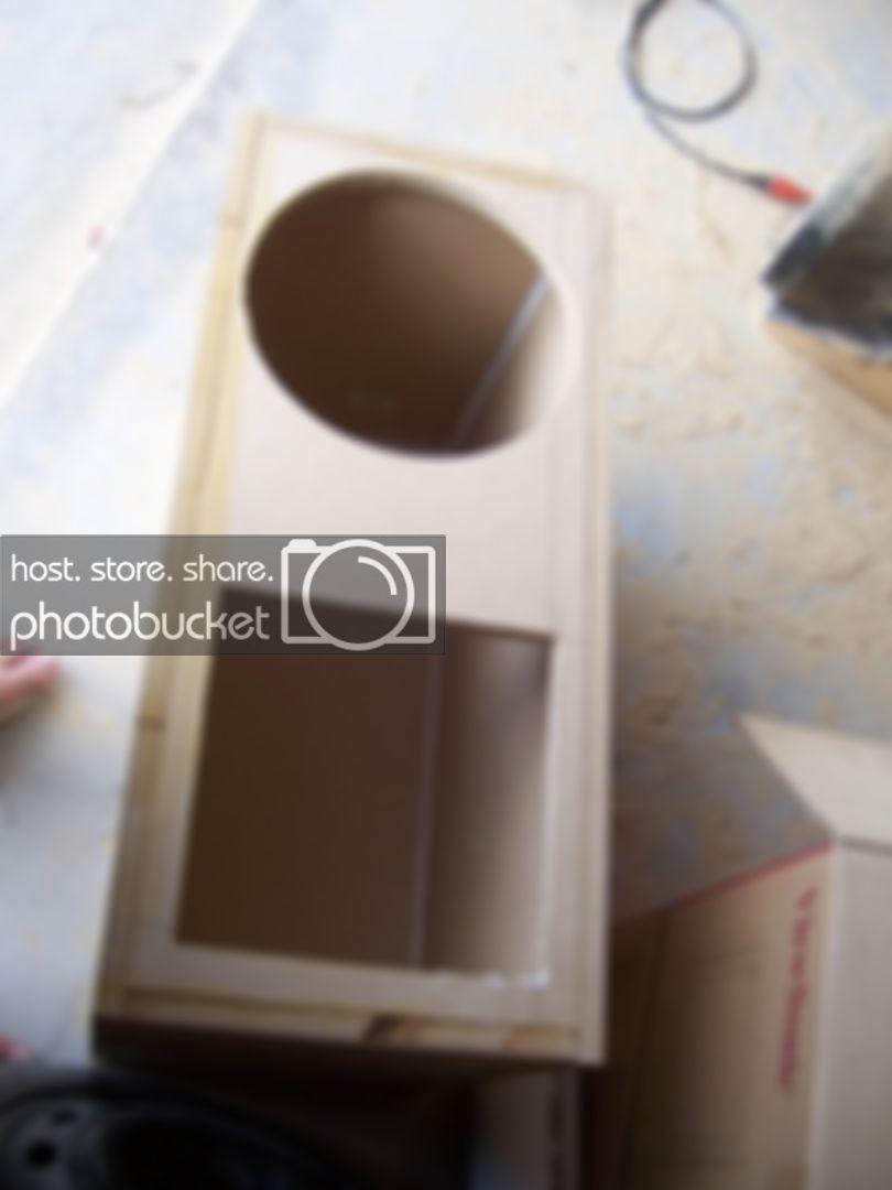

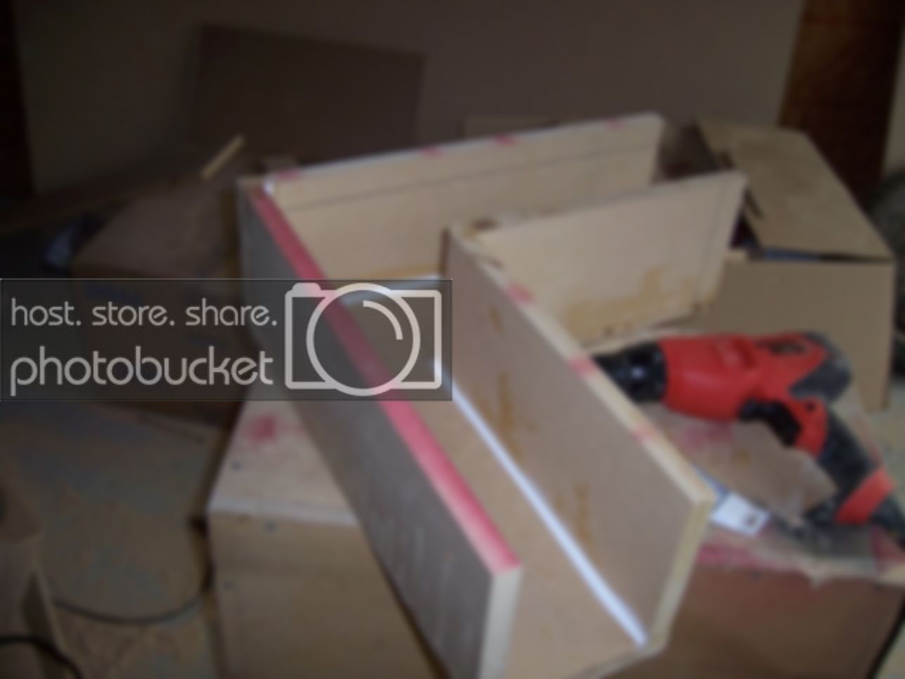

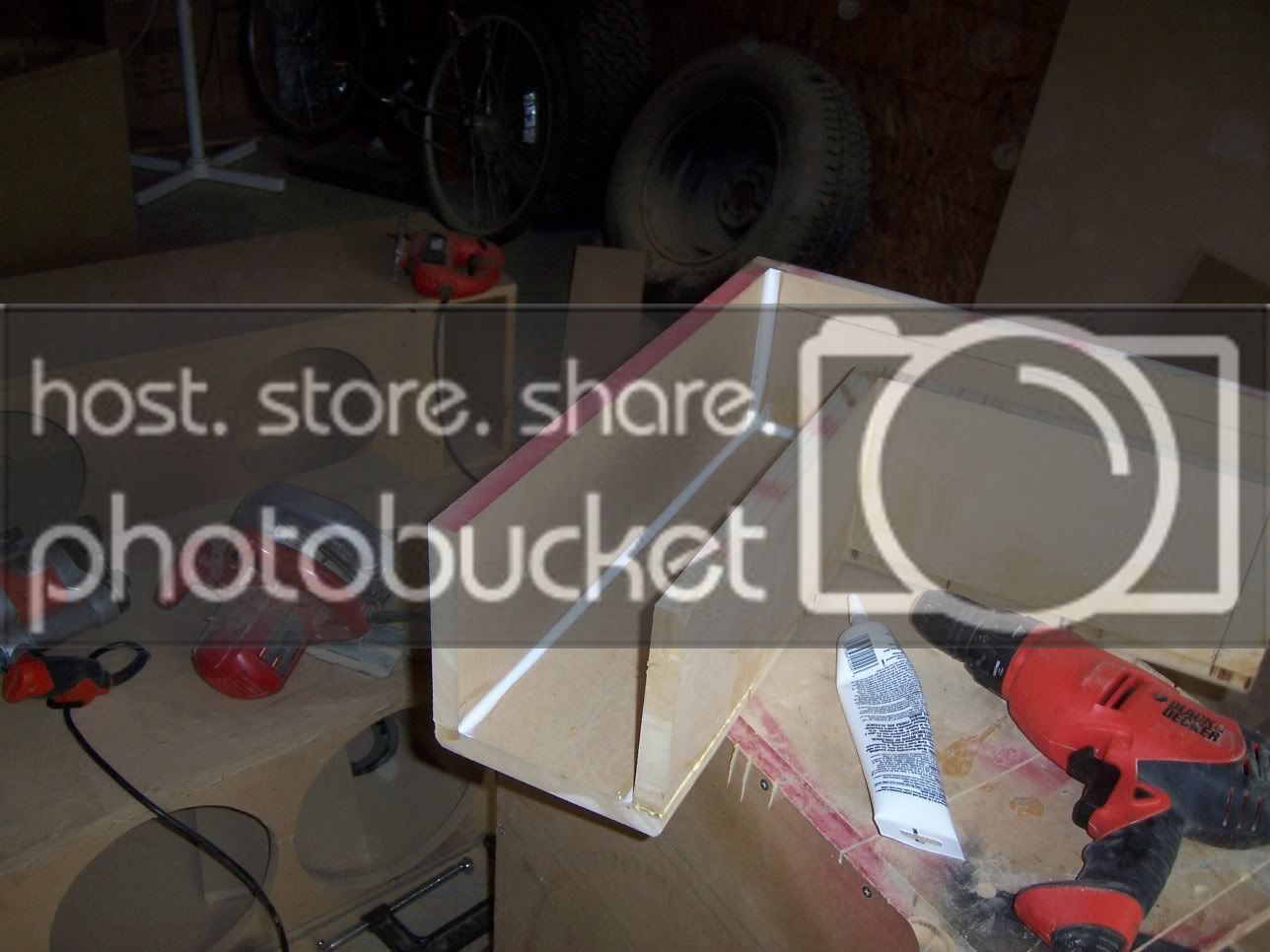

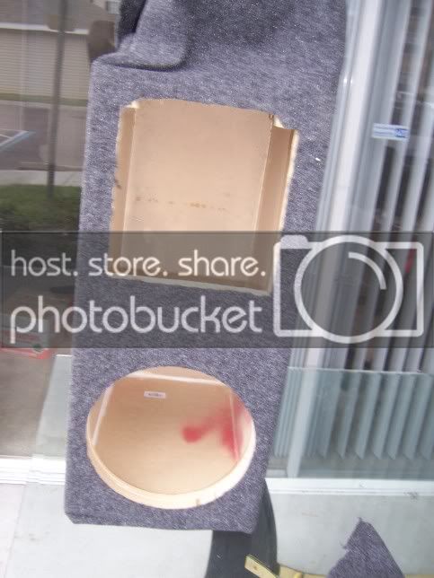

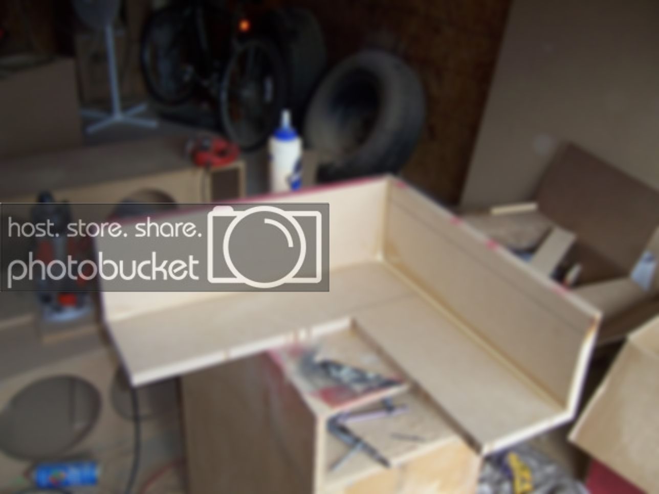

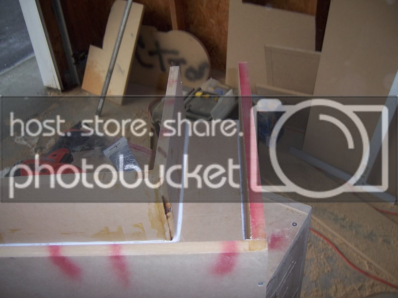

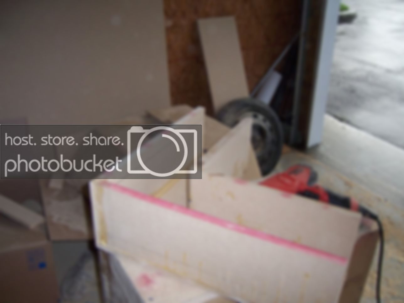

here is the beginning of the second baffle. I had to do it in 2 pieces (the second baffle) because one half, is the sub baffle, or where the sub mounts, the other half is the port, itself.

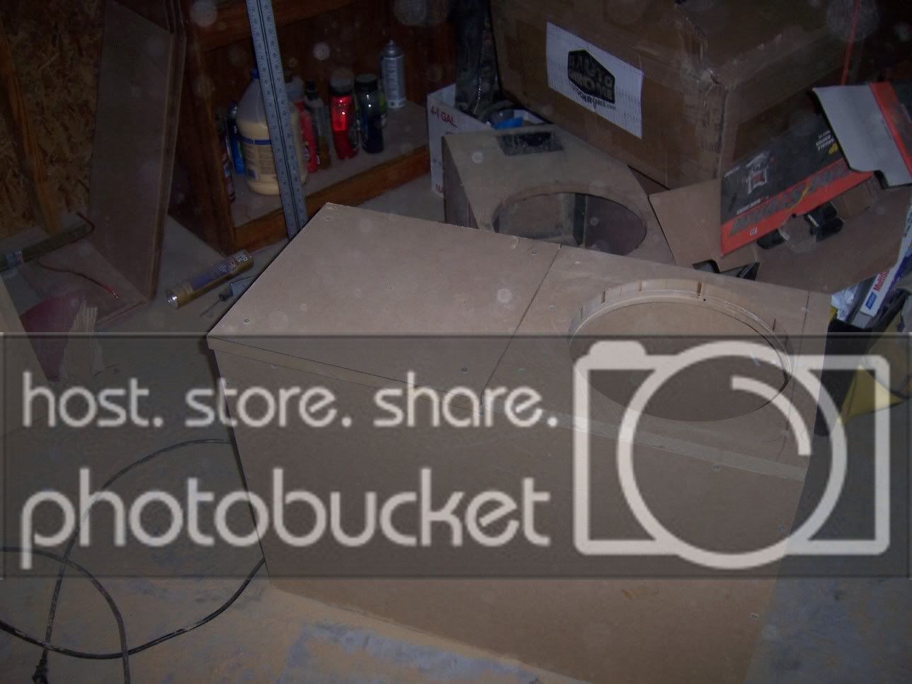

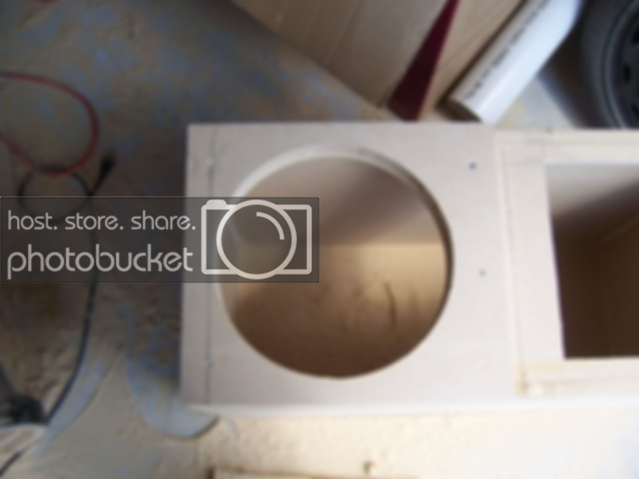

and the hole for the sub

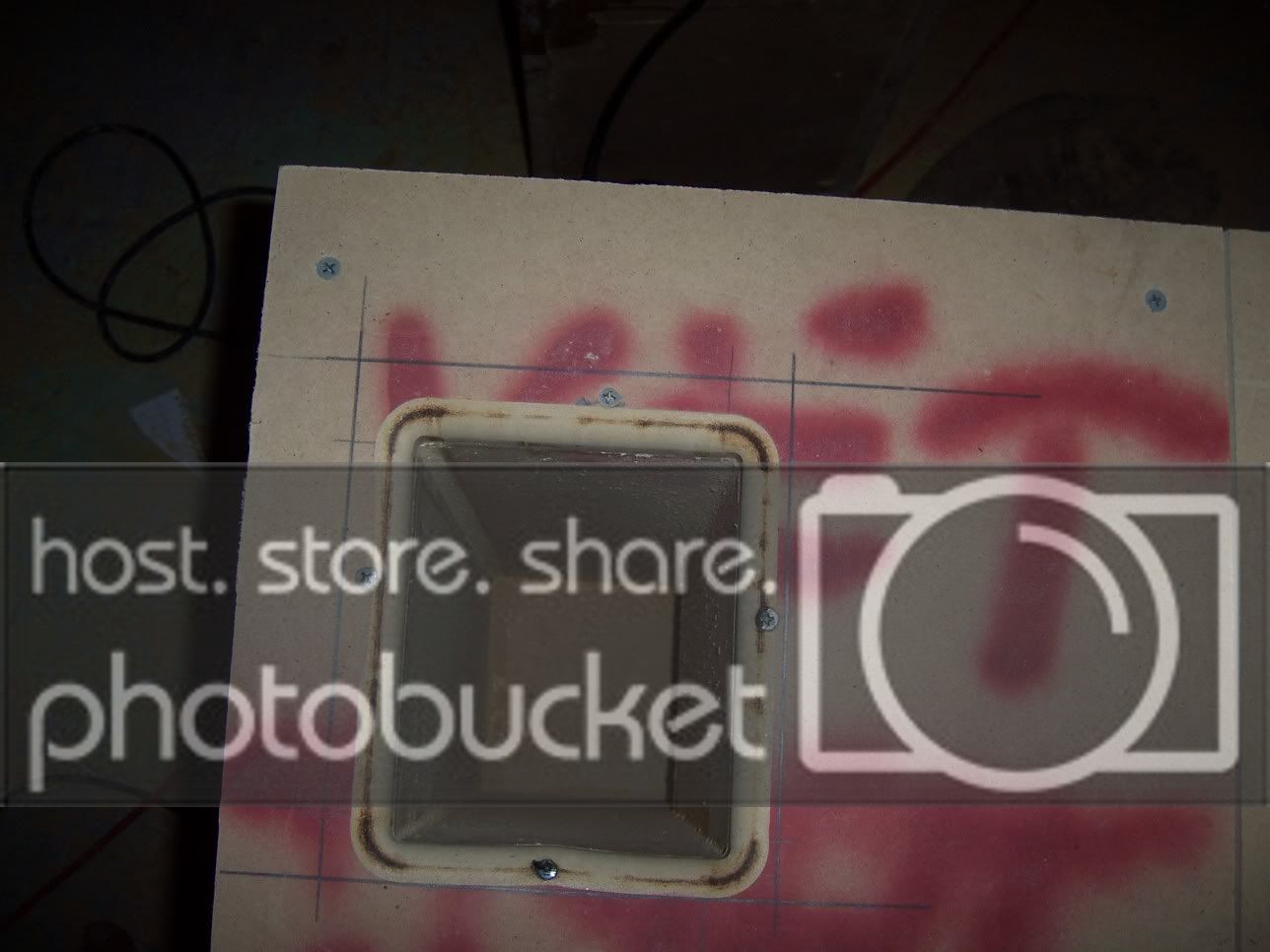

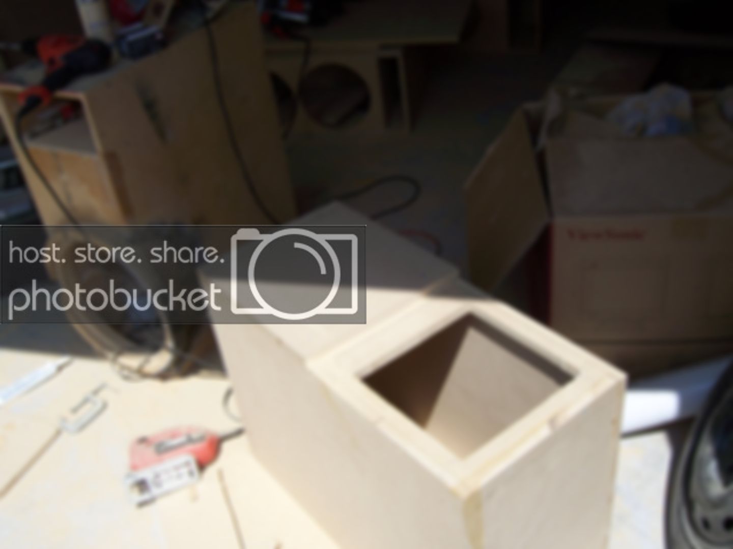

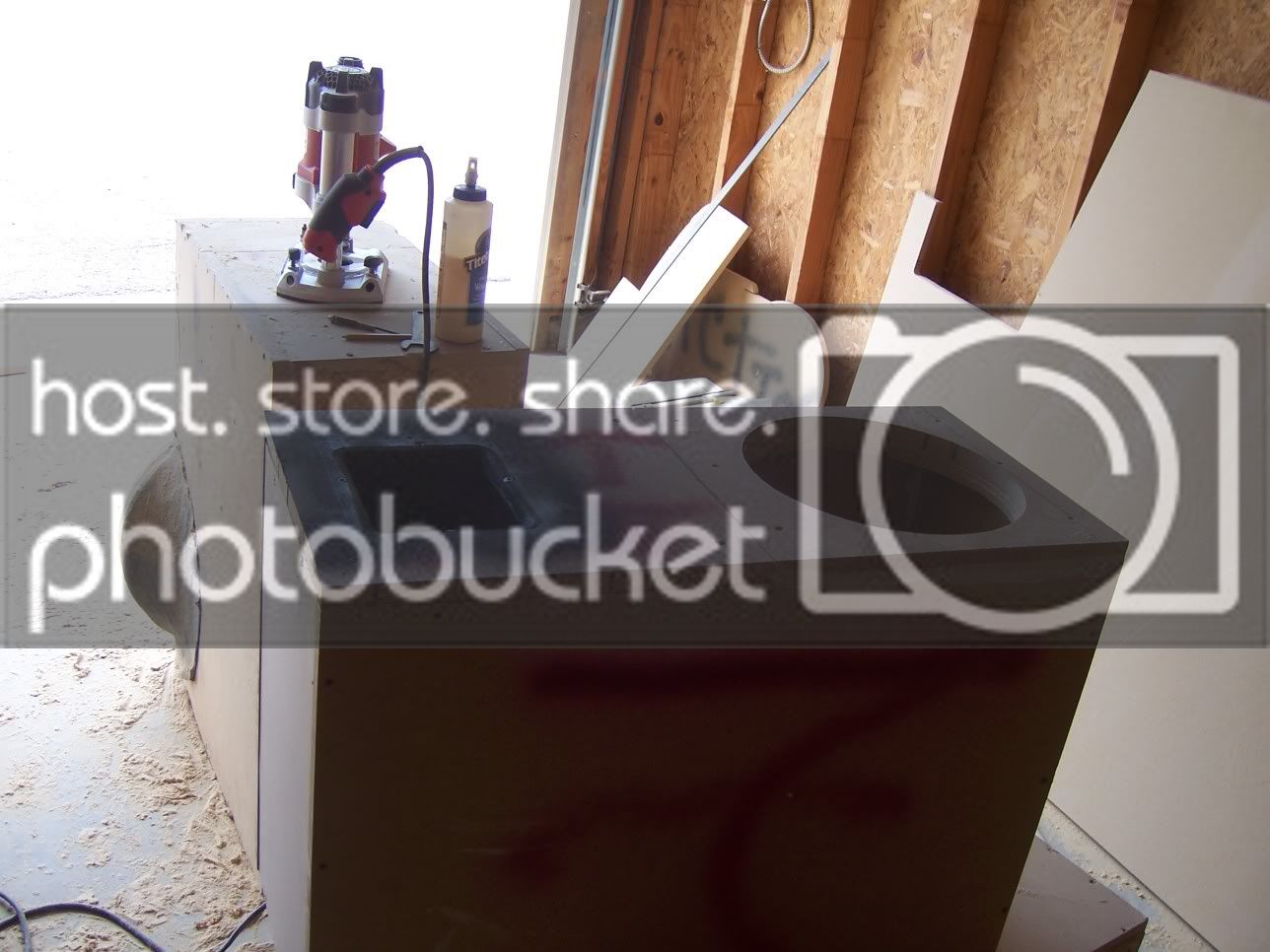

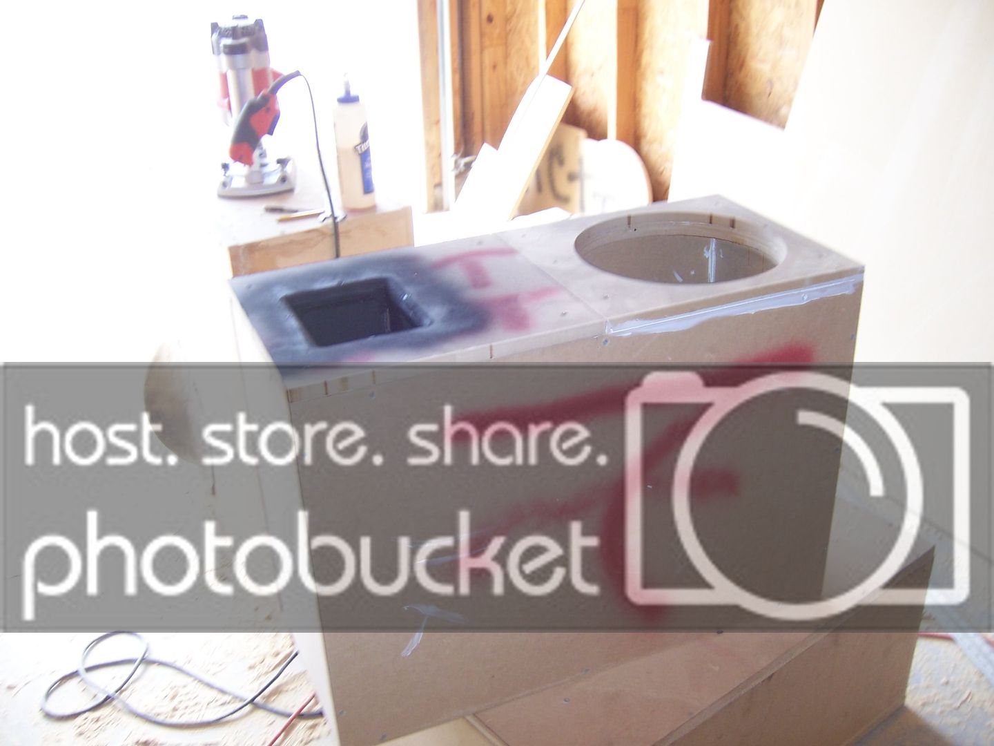

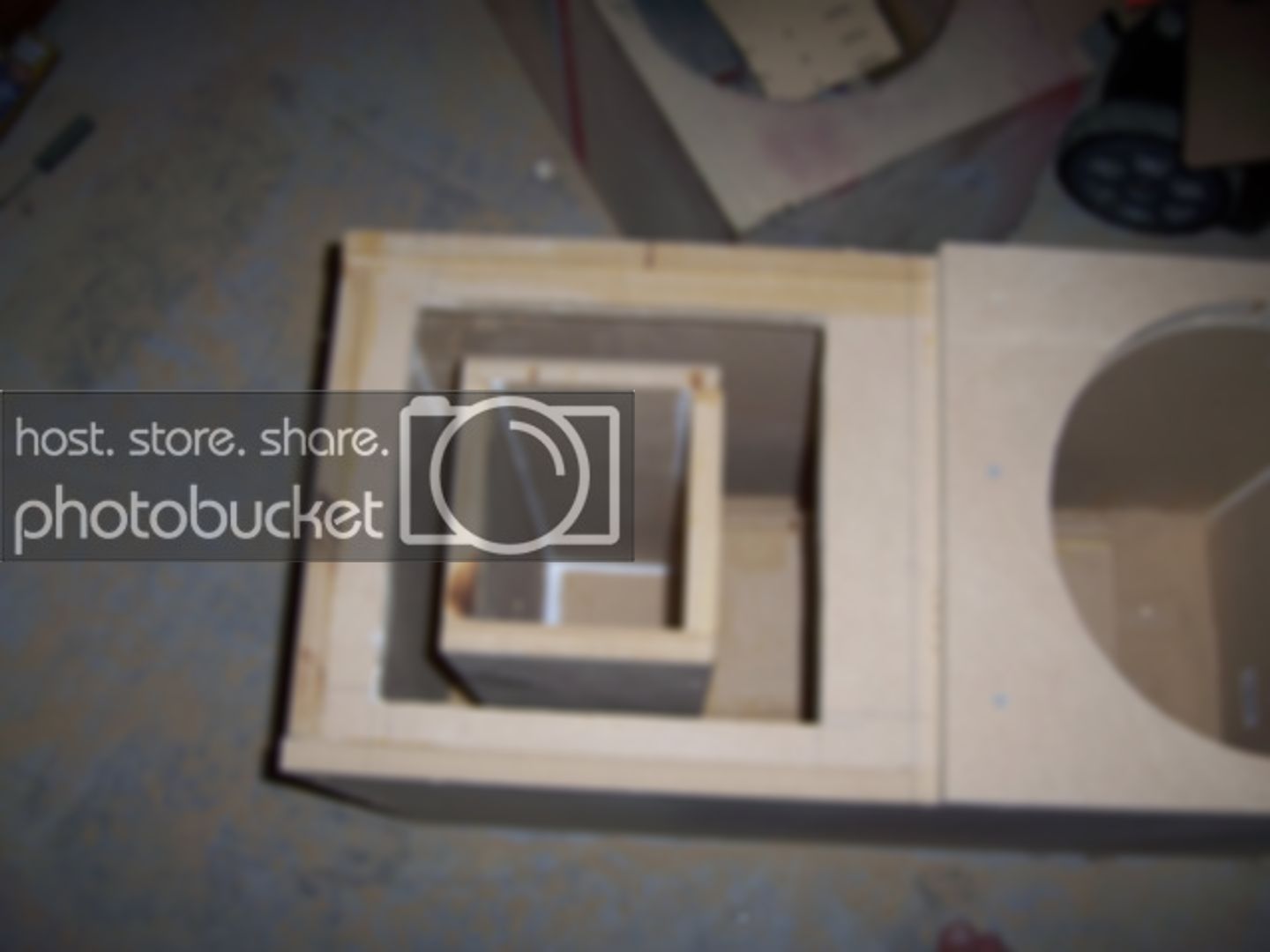

i had to build a port, with all 4 walls, as it is removable, so it must be a self contained port.
and here is what the port looks like, just sitting in the box. It was more of a test fit than anything.

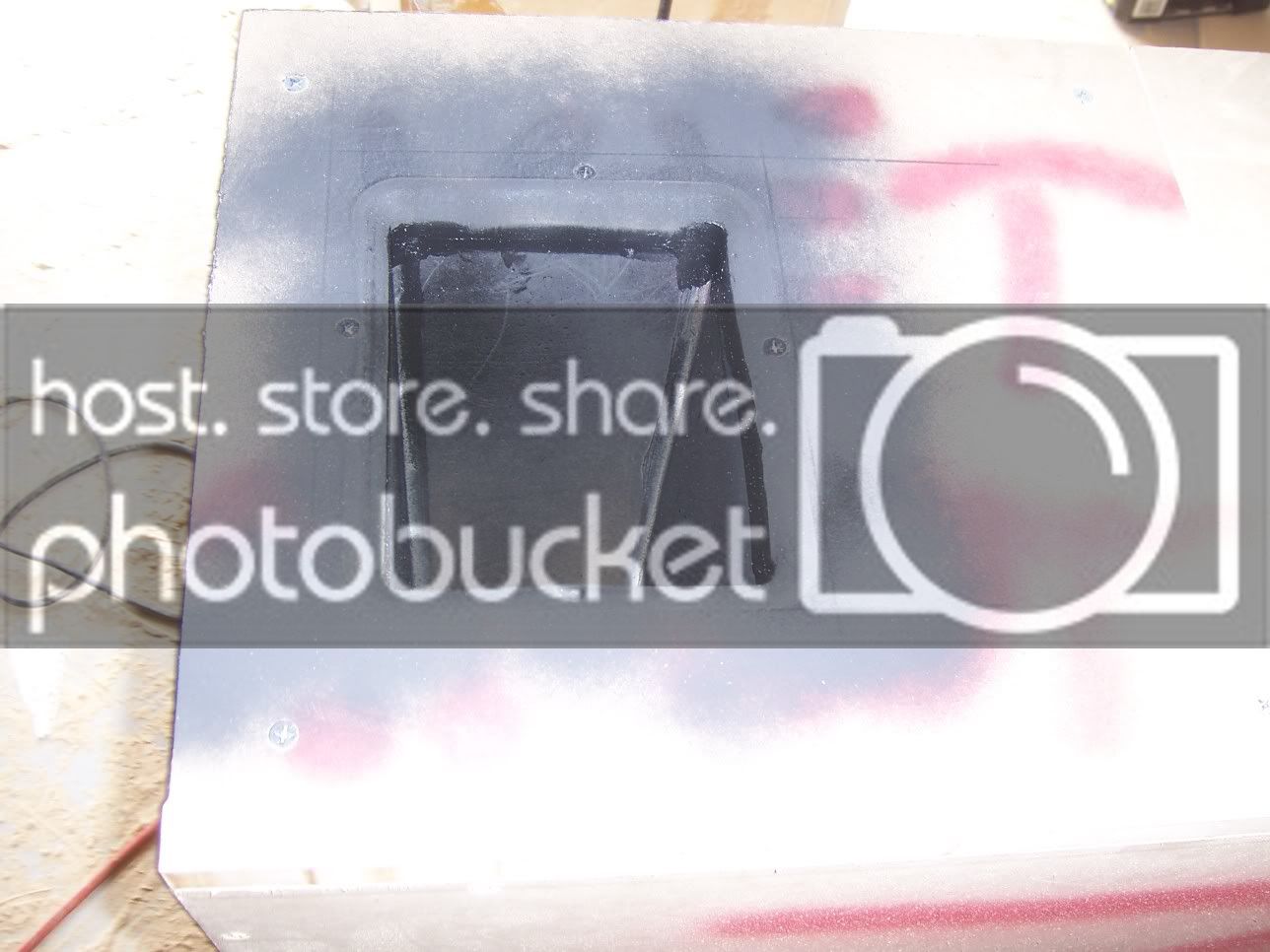

Now what we have here is the flush trim baffle for the port itself........the port is attached to this, meaning that yes, the port has its own baffle.
and here, is the port in the box, port is nice and rounded off, to help with port noise
heres a shot deep inside the box
the port is .5 inches from the back wall (as they all will be)
Painted it black......because thats just the thing to do

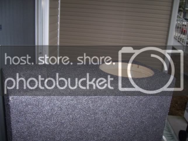

and the first hint of just a little bit of carpet....
even the test box has to look nice!

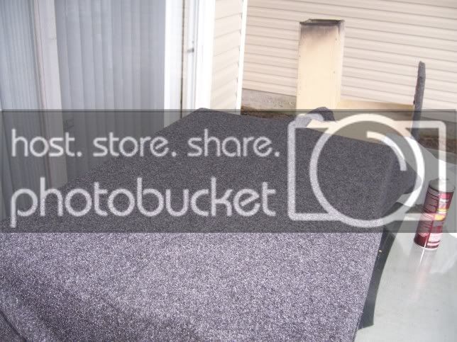

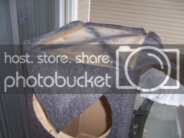

here are some more carpeted pics.
the front, and back, are both completely rounded off, but for some unlknown reason i didnt get any pics of the ***** rounded edges, but you can see most of it showing in the pics.
here you go

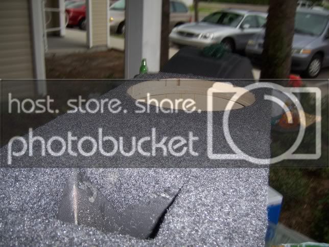

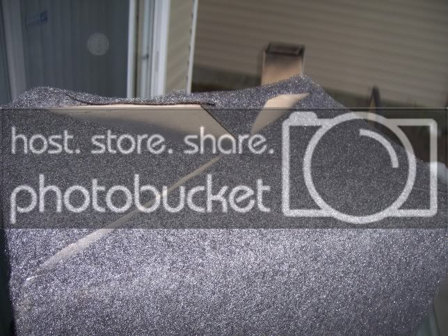

I obviously had to carpet the box, and the port seperate, as one is removable.
that line in the middle tha tyou see is the stepdown from the double baffeled section, to the single baffle (where the port sits)

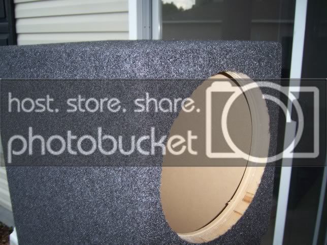

heres a good shot of the side..

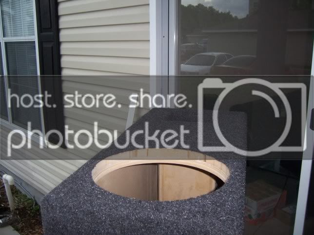

the front is finished....but portless
Second side
You can see the rounded edge here.....it makes for a much much better feel.

Rounded edges, but more important, weatherstripping will provide a good, non permanent seal for the port
Shot of the port attached to the box.
