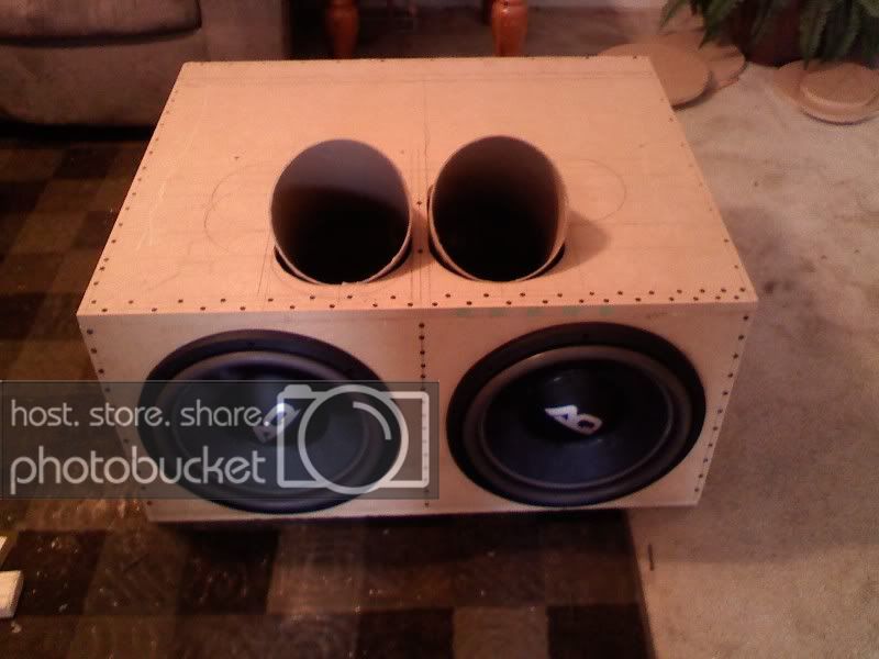

more pictures //content.invisioncic.com/y282845/emoticons/biggrin.gif.d71a5d36fcbab170f2364c9f2e3946cb.gif got it playin no vid tho //content.invisioncic.com/y282845/emoticons/crap.gif.7f4dd41e3e9b23fbd170a1ee6f65cecc.gif will have one soon. its LOUD for what it is. prolly around a 145 at the headrest right now and when it gets sealed and he gets his electrical up (he has one economy batt and stock alt) itll be around a 147 or so hopefully

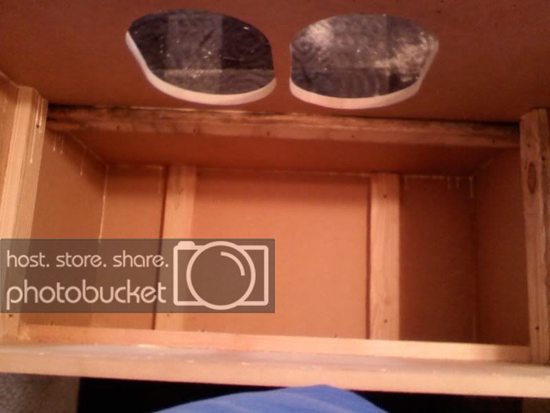

around the ports? they are already filled wit hot glue, the holes for the wires are too i just didnt get a pic of um finished. it will be great stuffed and beauty panels will be made for the top and front. itll be really nice when its done he is a perfectionist lol
NO noise. below 35hz could be improved but i needs to be sealed off before we retune the ports. its alot louder than i thought it would be since its open to the trunk still, i was like //content.invisioncic.com/y282845/emoticons/eek.gif.771b7a90cf45cabdc554ff1121c21c4a.gif

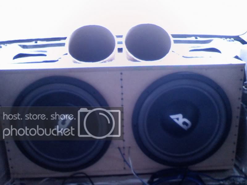

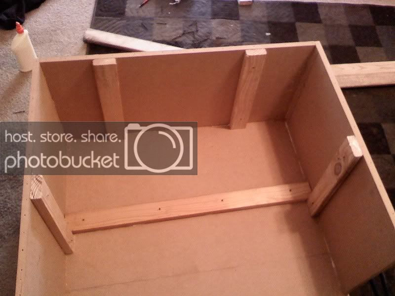

here are sum pics of the bracing and ish too we did. the front has a double baffle and we added a brace in the middle of the ports. also this setup has a TON to gain in it //content.invisioncic.com/y282845/emoticons/biggrin.gif.d71a5d36fcbab170f2364c9f2e3946cb.gif

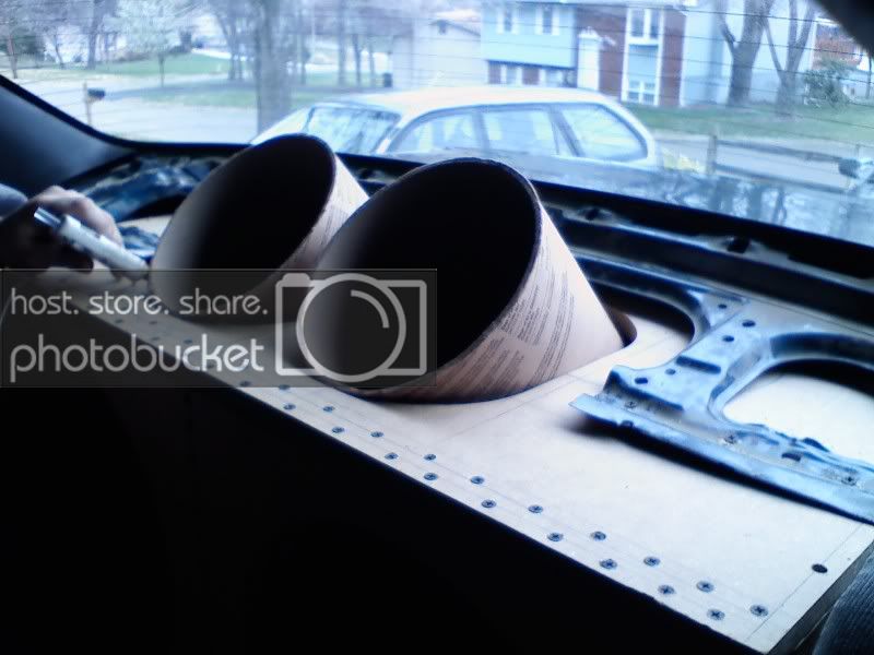

Sonotubes are weka, and dont work without reinforcement
I used the exact 8" tubes only 16" long, with the exact same subs, and they flex/vibrate like crazy. I personally scrapped the idea and just went slot port, but you may want to put 2 layers of glass around them
