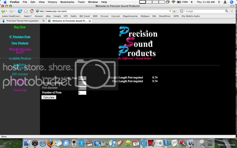

ok, same question different numbers to get reassurance from you guys //content.invisioncic.com/y282845/emoticons/smile.gif.1ebc41e1811405b213edfc4622c41e27.gif 32hz would be way too long, and i oud out i have more space since this calculator uses gross and not net so new numbers.
So I cut center piece to 3.74" correct?
