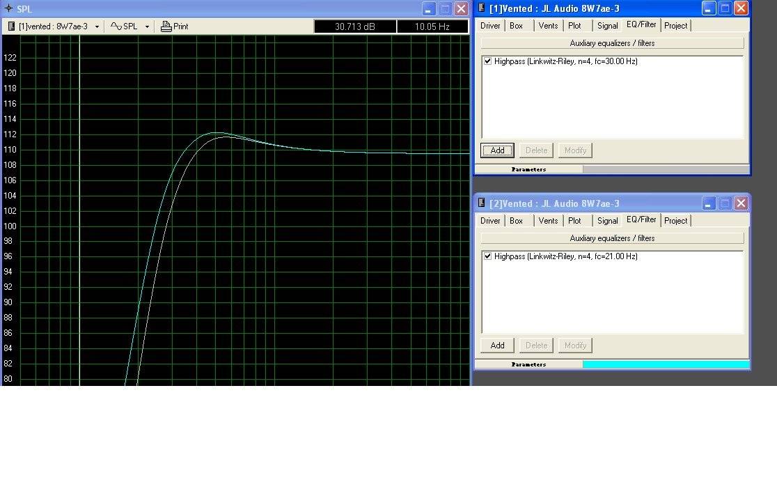

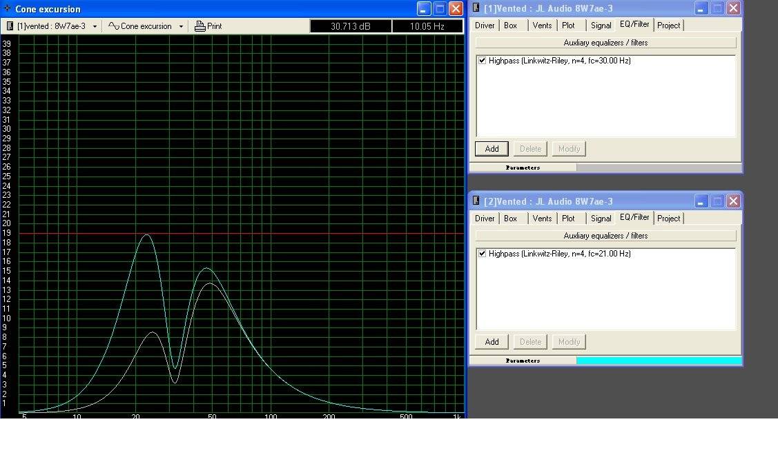

JL 8w7 in 1cube tuned to 32hz [Grey - 30hz ss filter 24db] [blue - 21hz ss filter 24db]
The 9 hertz difference in SS setting provides the 8w7 the ability to utilize ALL of is linear excursion where the 30hz filter basically cuts off it's balls. At 20hz the system set at 21hz SS is 9db louder, at 30hz it's 4db louder, and at 40hz it's 2db louder...and all while staying within linear x-max.
People don't seem to pay much attention to what a correctly set SS can do for a ported sub.
