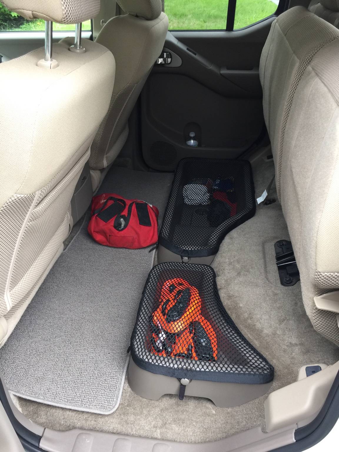

There is enough room and there are pre made boxes available for that specific application, but I have built in storage bins there that I have full of stuff. If I didn't need those then that would definitely be my preferred route as I know I'd get much better sound.
Pic of the bins with the seats flipped up. These are removable, I would have to find somewhere good to store all this stuff though.
I wouldn't get a pre fab box anyway. Way better off having CSCStang build you a box for that. Throw the storage bins in a tool box is what I'd do. TWo SA-8s or HDS208s under the seat would be exceptional
Now you've got me thinking more about going with two 8"s under there. One of my favorite systems I ever had was actually two Elemental Designs 8A's in a sealed enclosure. That system just sounded amazing. It didn't have near the output of my bigger systems but I didn't care because of the super clean sound. I still regret selling those things. Im guessing the most I could get would be about .5 cubic feet per sub under those seats. Would either of your recommendations do well in that size sealed box?

If I didn't have kids that needed to use that space I would be all set. I need to leave the seating space the way it is so I can transport the family. Also there isn't any room behind the rear seats for a full setup. I just barely fit the current powered sub behind there.
That picture you posted above, built a center console in the floorboard which would separate leg room from the left and right seat.
That should easily house a ported 8 or sealed\ported 10"
Mounting depth might be tight with those. I'll have to take some measurements when I get a chance. They look like **** nice subs though.
Mounting depth of an HDS208 is less than an SA-8, so i'd try to stick with the 208s. I've never hear them in a sealed box before. Give us the dimensions of the space you have and are willing to give up.
