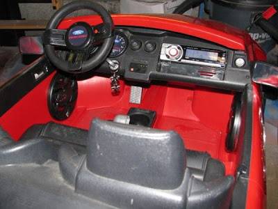

Sony CDX F5700 (40.00 ebay)
Boss 6.5 3 way coax ($17.00 Amazon specials)

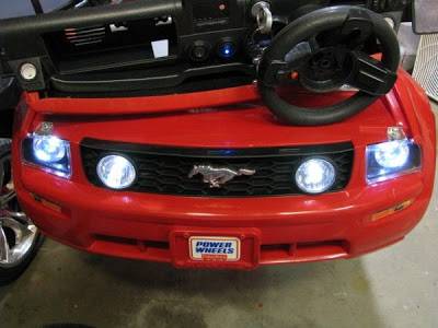

LED fog/headlights
LED component board taillights

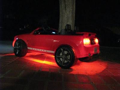

LED strip underbody lighting

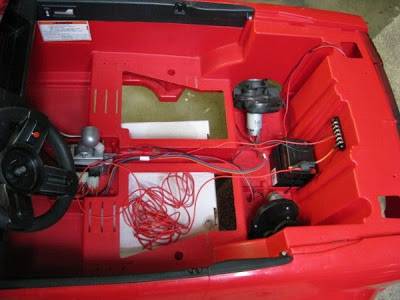

I wanted to keep the drive system stock and untouched for reliability. All the lighting and sound equipment was added to an axillary 5 amp hour AGM battery, fused and switched. This way if the car is left on, only the add on's die and the car is still drivable. The stock battery can still be charged by the stock charger but I also made adapters to be able to use a schumacher charger that I use for other things. If you are interested in seeing more of these types of modifications check out modifiedpowerwheels.com.

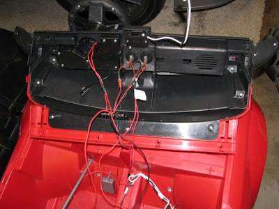

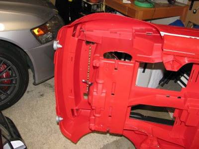

starting the wiring layout

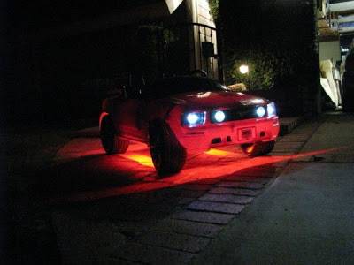

let there be light
not too bright but look good in the dark. have some oznium leds on the bench ready to go

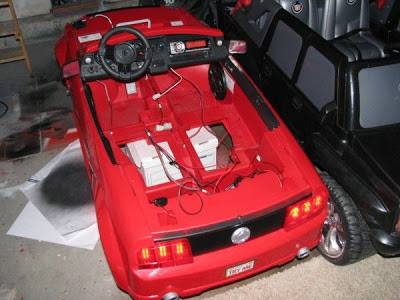

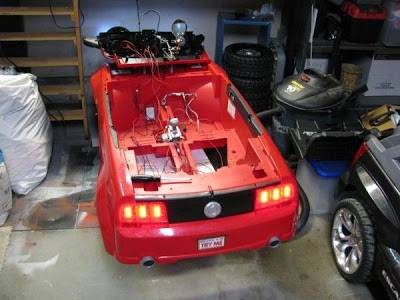

love using barrier strips with jumpers. ran one pos and one neg and ran all accessories off them

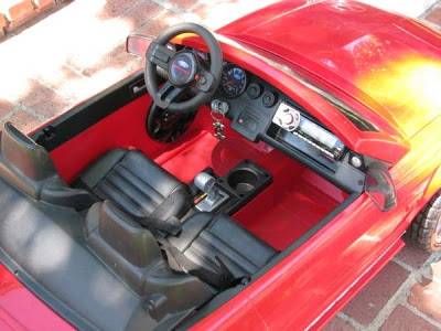

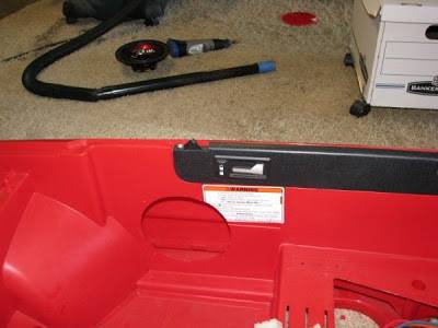

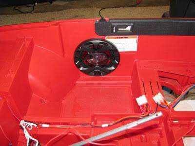

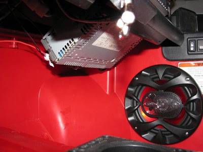

speaker work in the door. cordless dremel ftw
bought these because they were red, the fit is perfect, the sound...they're red!

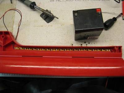

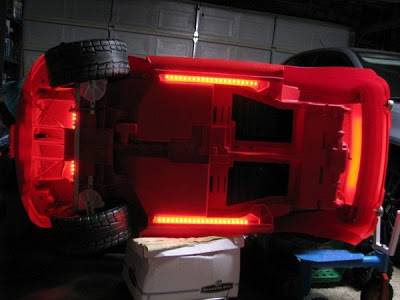

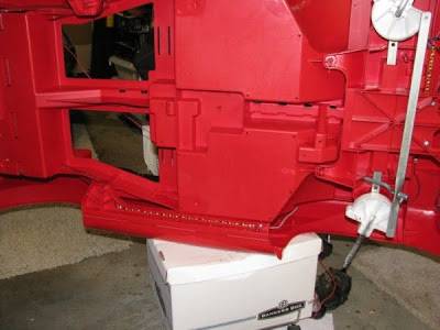

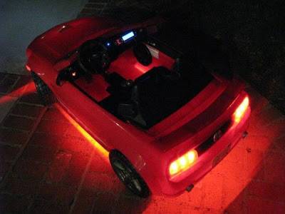

rear underbody LED strip and aux charge port

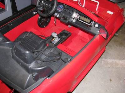

basic work done, cleaning up the wiring and finishing the details
the switches in the center vents control the lights and undebody LEDs, red LED toggle switch left of the steering wheel turn all aux on and off.
underbody LEDs
rear charge port

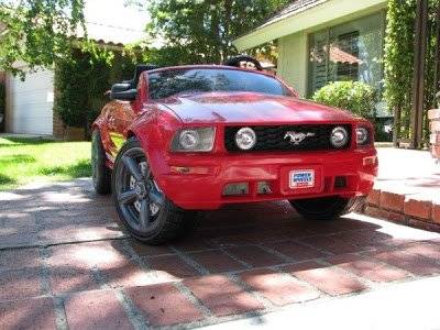

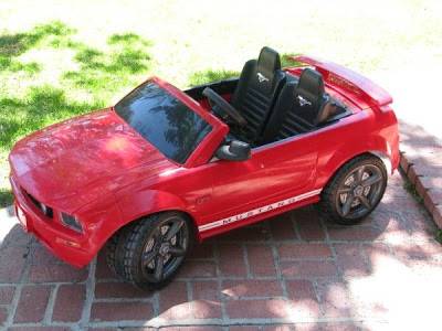

ready to go
FM antenna hidden in rear passenger fender

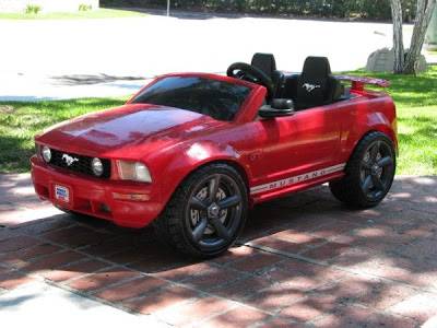

wheels were painted gunmetal and the brake rotors silver.

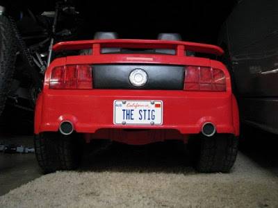

custom plate. a little big but all I could find in the current CA style.

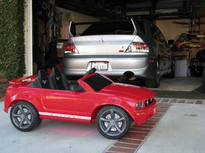

fostering a little father son rivalry

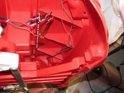

Looks like you have good output on the Hummer, plus the strobes are cool! What did you use for the underbody lights? Here are the LED strips I used, they are sizable as you can cut at every 3rd LED.
side skirts
front clip lighting
wired all 4 strips together

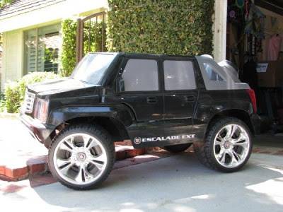

We have one of those in our camp ... Alexis Hill - 2009 USACI mini msx spl World Champion ...
I was watching videos of that one the other day, nice job! I have seen custom systems in the Escalade but nothing like that, wow. I didn't know there was a class for kid cars. Do you have a build thread? I would be curious to see how everything fit in there, and what kind of batteries are you using? How long can it play? So many questions...
lulz shell be competing with dante and the best soon enough
Awesome bro !!! Its our only true Spl vehicle for now.
I hope the whoever goes up against her in her class can put up a 180.9 or better on the board. She is one of only about 4 vehicles in the world that can do it ...
Nuff said about this ... I did not mean to threadjack ... very sorry to the op ...
No build log that I know of ...
14.4 volt system (4 batteries) feeding 2 Linear Power 4.1hvs, 2 digital Designs 12s (not sure of the tuning freq, somewhere around 77 htz) ...
12 volt wheel chair battery feeding vehicle and head unit ...
30 sescond burst of 180 db ... but can play music all day long if hooked to an Astron. Normal drive time ?? not sure, thing weighs close to 700 lbs ...
the equipment / bracing is heavy ...
