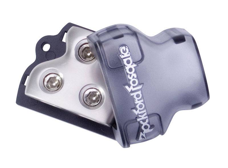

which is better?
what is the difference in each one ?
I'll buy Rockford Fosgate Amp Kit Dual RFK1D http://www.amazon.com/gp/product/B009VTDWCY/ref=ox_sc_act_title_7?ie=UTF8&psc=1&smid=A3LLMZ9K72U9P2
but the distribution blocks do not bring fuses
do you recommend me change for one with fuses?
how good is the brand xscorpion? http://www.amazon.com/Xscorpion-DMANL3024G/dp/B008UY0OZO/ref=sr_1_1?s=automotive&ie=UTF8&qid=1419521603&sr=1-1&keywords=DMANL3024G
The blocks are the only good thing rockford makes anymore but check out tool maker metalworks before.
no matter if they do not bring Fuse the Distribution Block
Why do you need a fused one?
someone told me that by putting Distribution Block with one fuse for each amplifier (two) would protect more
because it only has one main fuse kit 300 amp
Rockford Fosgate Amp Kit Dual RFK1D brings a single fuse
You really only need to fuse the main run off the battery unless you have rear batteries. A fuse will not pop fast enough to keep a amp from blowing up. It will pop fast enough to keep cable from catching Fire and burning the car down.
then I do not need a distribution block
with bringing the kit is sufficient
