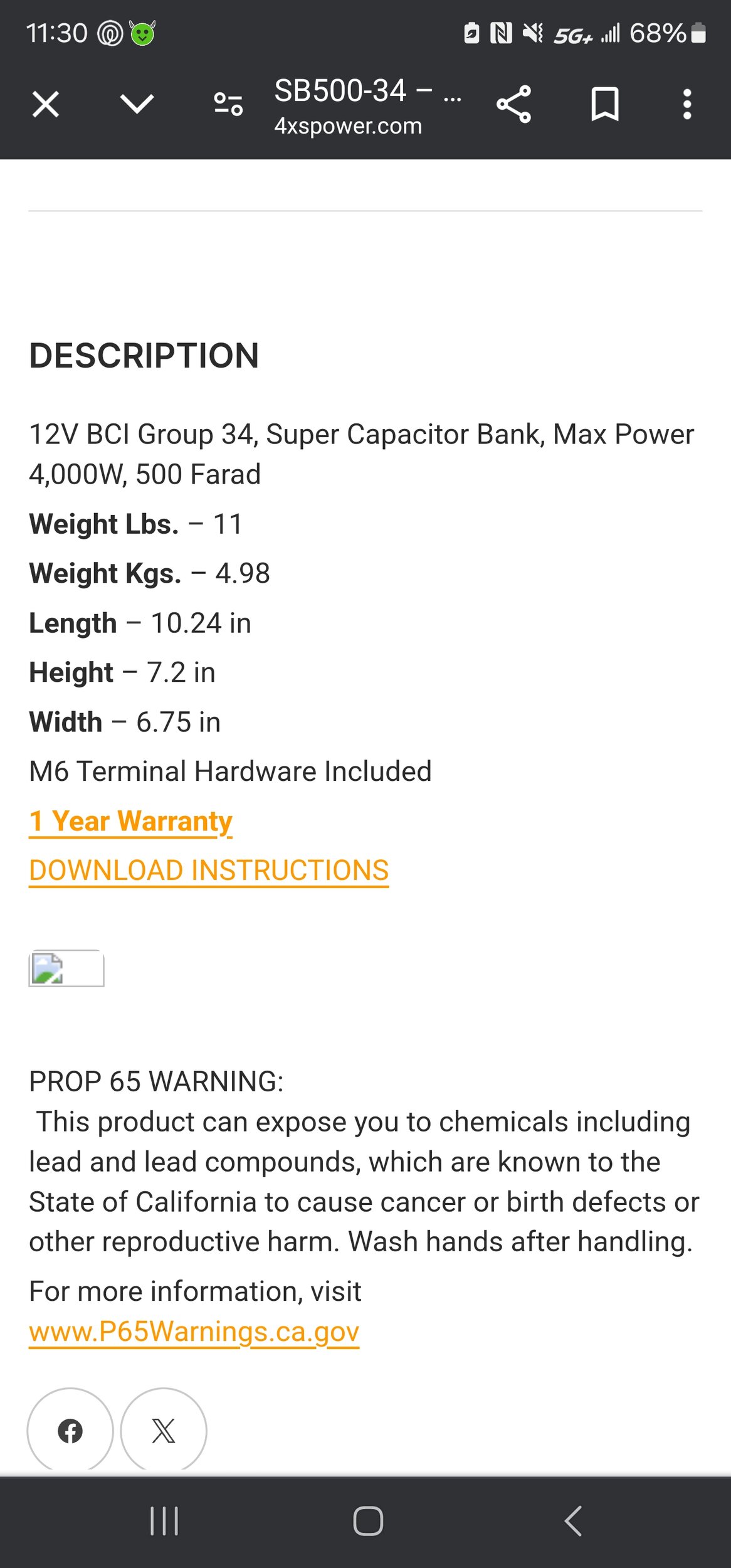

So I have a XS SB500.34 power bank/battery hooked up for my audio system it has max power is 4000 watts so does that mean I don't need to upgrade my alternator unless I go over the 4000 watts or what does that actually mean and when should I upgrade my alternator. I'm trying to learn more about car audio so any information will help
Here's. Reference image
What amplifier(s) are you using?
What speakers?
Is this your main battery or is it a 2nd battery?
If it is a 2nd, how are you wired up?
What if any other upgrades to electrical do you have (big 3)?
Run the biggest AGM you can under the hood, the parallel runs to one of these - should be everything you need and then some...

That’s the little single 6.5 inch enclosure. The Savard did just as well as the RDS. These subs do well in ported or 6th orders but not as well...

With 6500 rms.. you are still going to need some battery bank and/or supply for that demand

Doing the Big3 and a better battery is going to help that alternator from working its azz off. HO Alternator is nice to have. id budget that in...
