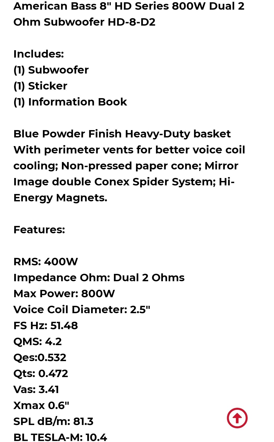

So, my 8's have an Fs over 51. So, how low should they play? Just curious. You seem to be the forum genius.

I got my design about how I want it. I'm just thinking instead of the manufacturers port area recommended 43.75 I should go maybe 55.00 total port area on the box I'm building at 34hz to get the full potential out of my subs. What you think man?

I’d have to design it some to know for sure. I think you’d be alright with 55 if you mean 4 cubes net.
