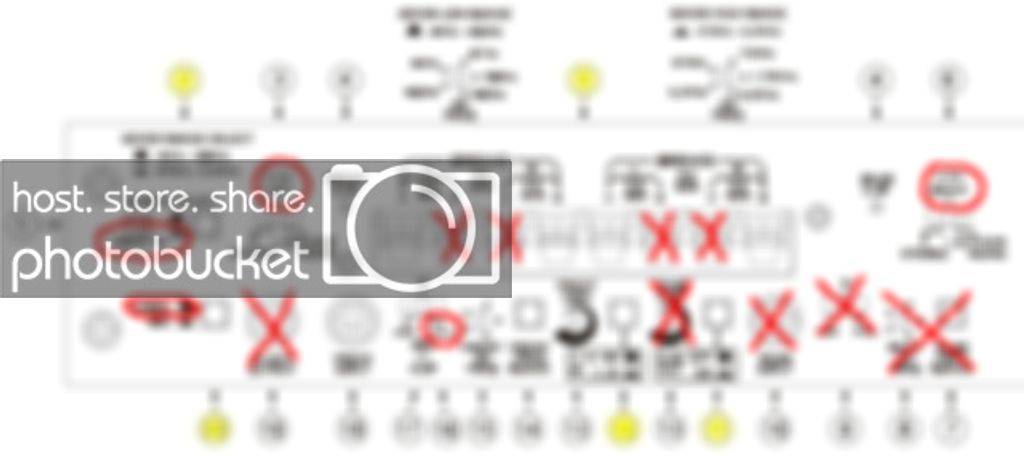

So I have Rockford Fosgate Punch P1000X5D 5 channel amp. Other than my sub running off the sub channel, I have my front components being ran off my two front channels (75w to each) and my rears are vacant as I'm just using my HU to run my rear speakers and plan to keep it that way. The specs for this amp says 250 watts RMS x 2 bridged at 4 ohms. Am I able to do this with the components that I have? If so, how would I wire them? If it can be done then wouldn't that mean I would be getting roughly 125 watts to each component set? That would be nice as that is what the rms is for my components.

Don't use two sets of RCA's to run one set of components. If the amplifier is bridgeable it will have input management to allow you to use the same left and right RCA to run in bridge mode.
I guess most amps will have that option. But my jl amp doesn't, in the owners manual it says, if you want to run a pair of speakers bridged you have to use 2 ''y'' splitters.
Okay, but still use only one set of RCA's. Left into a Y splitter for a bridged set of channels and right into a Y splitter for the other set of bridged channels. JL is so 'awesome', I'm surprised they don't have this very simple feature built into the input stage.
