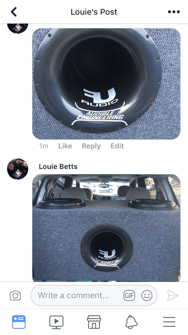

2 15s 10.4 cubes 10" aero tuned to 26. Show play some lows.
27 ftw! I wish I tuned mine lower. How much output would I lose by extending the port internally obviously losing some airspace but if I feed it more power to make up for the smaller volume will it still wang?
