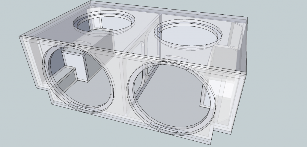

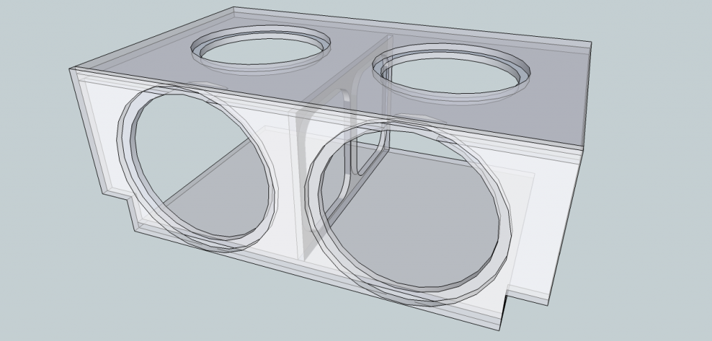

Anyway, here's what I sketched up for the box changes. Unfortunately, @Buck is not in the best of health, so he's not available at the moment. Hope he's doing well. In his absence, I gave it a try. Only sketched what I would change.
Original:
Changes:
These things will JUST fit.
