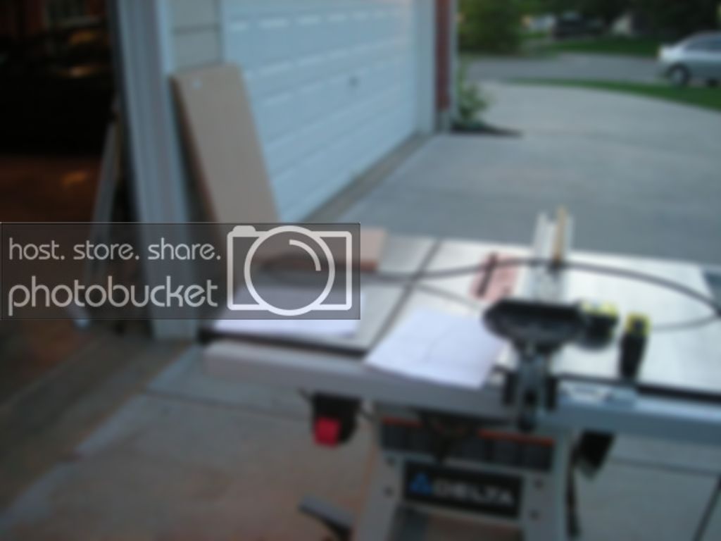

Gettin started..

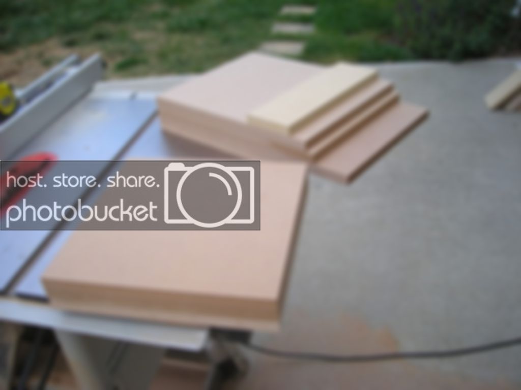

All the pieces cut minus the top and bottom..

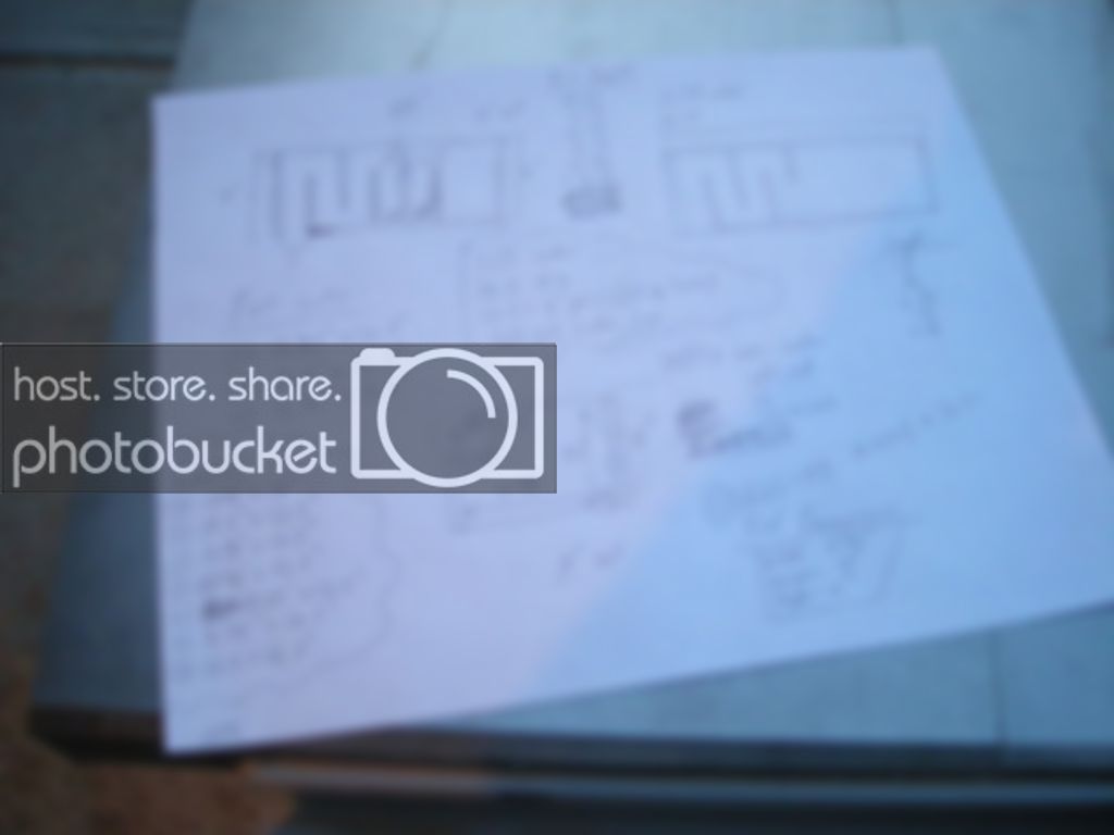

Some of my calc's and math for the box...

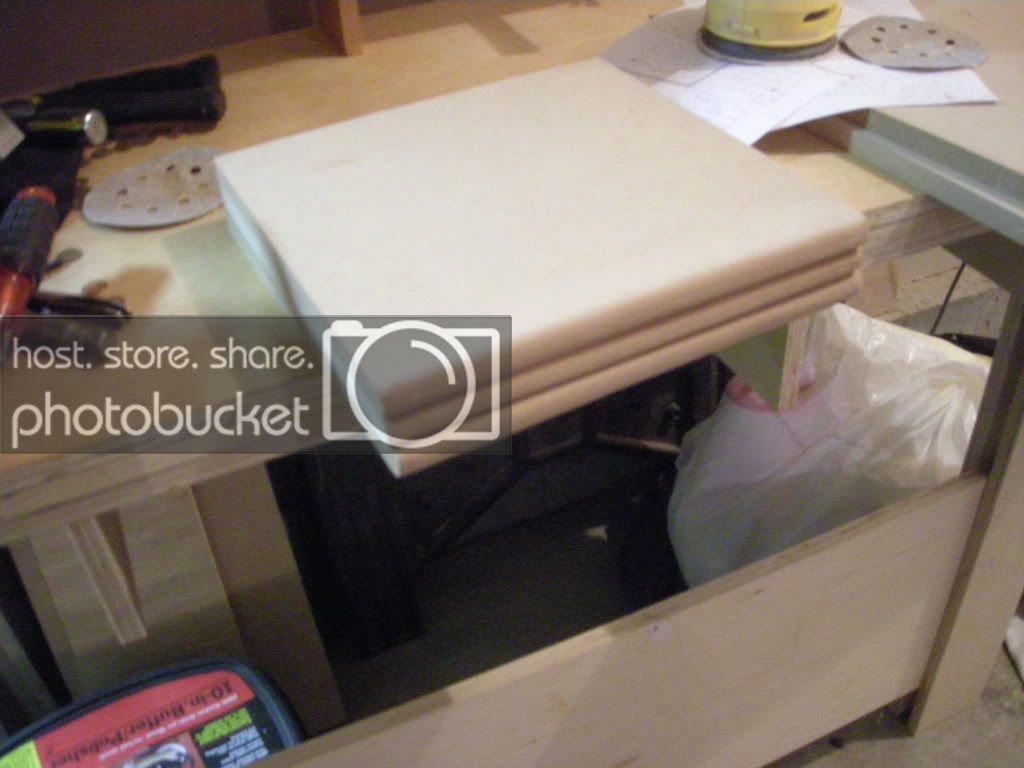

Port pieces rounded over...

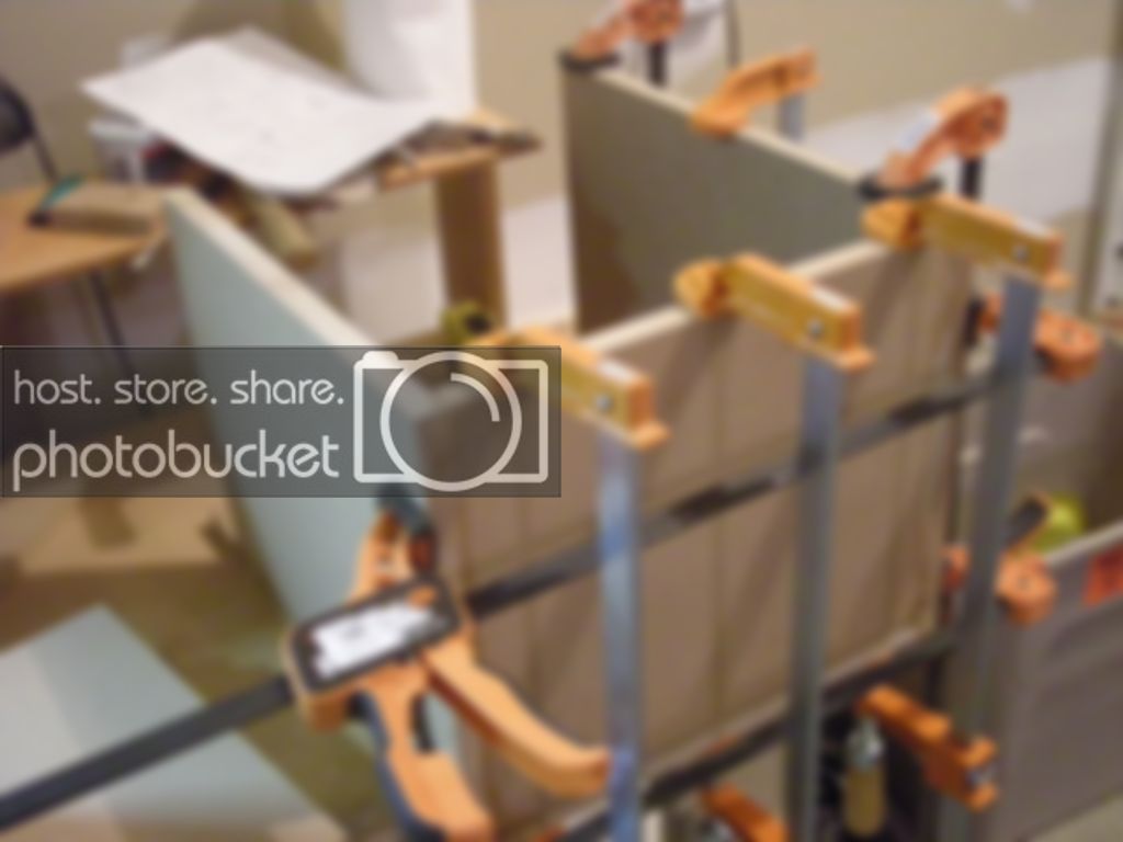

Got some new clamps //content.invisioncic.com/y282845/emoticons/smile.gif.1ebc41e1811405b213edfc4622c41e27.gif//content.invisioncic.com/y282845/emoticons/cool.gif.3bcaf8f141236c00f8044d07150e34f7.gif (jorgensen, baby //content.invisioncic.com/y282845/emoticons/woot.gif.aaa6090e619a97b6090d16dd863c5a69.gif)

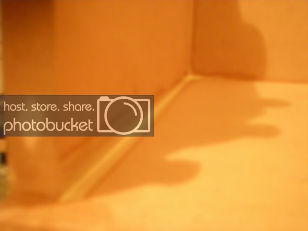

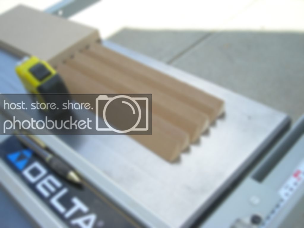

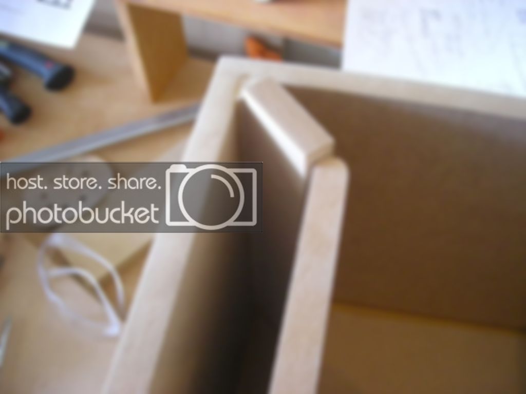

Cut out the 45 degree inserts...

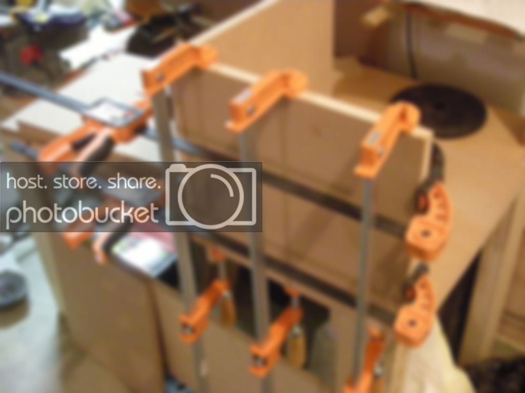

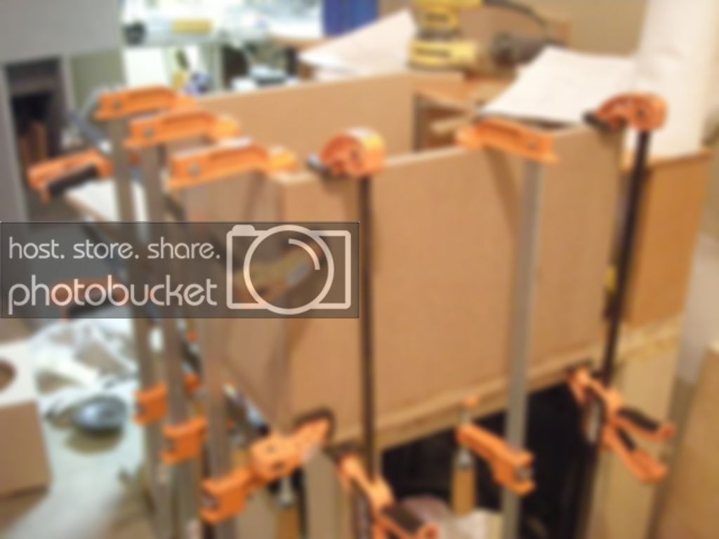

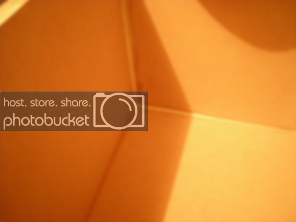

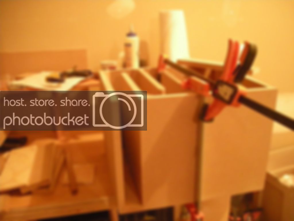

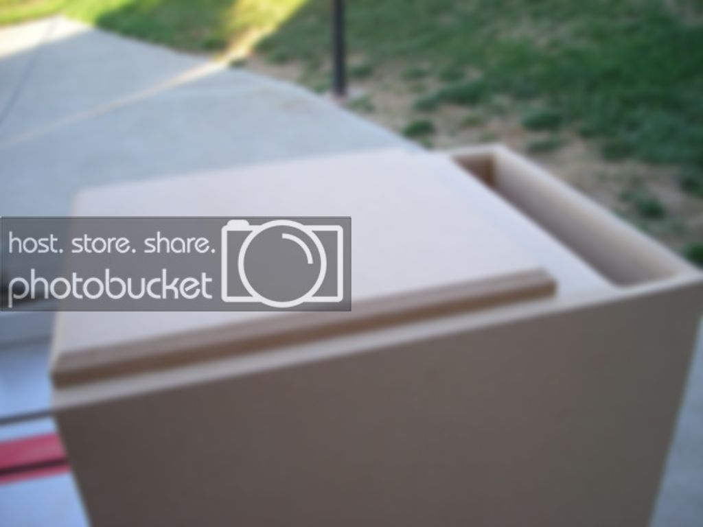

Couldnt clamp the 45's in the corners with no space so I cut this piece which slid down and used the port-piece for support and forced the 45 degree insert into the corner untill the glue dried //content.invisioncic.com/y282845/emoticons/smile.gif.1ebc41e1811405b213edfc4622c41e27.gif..

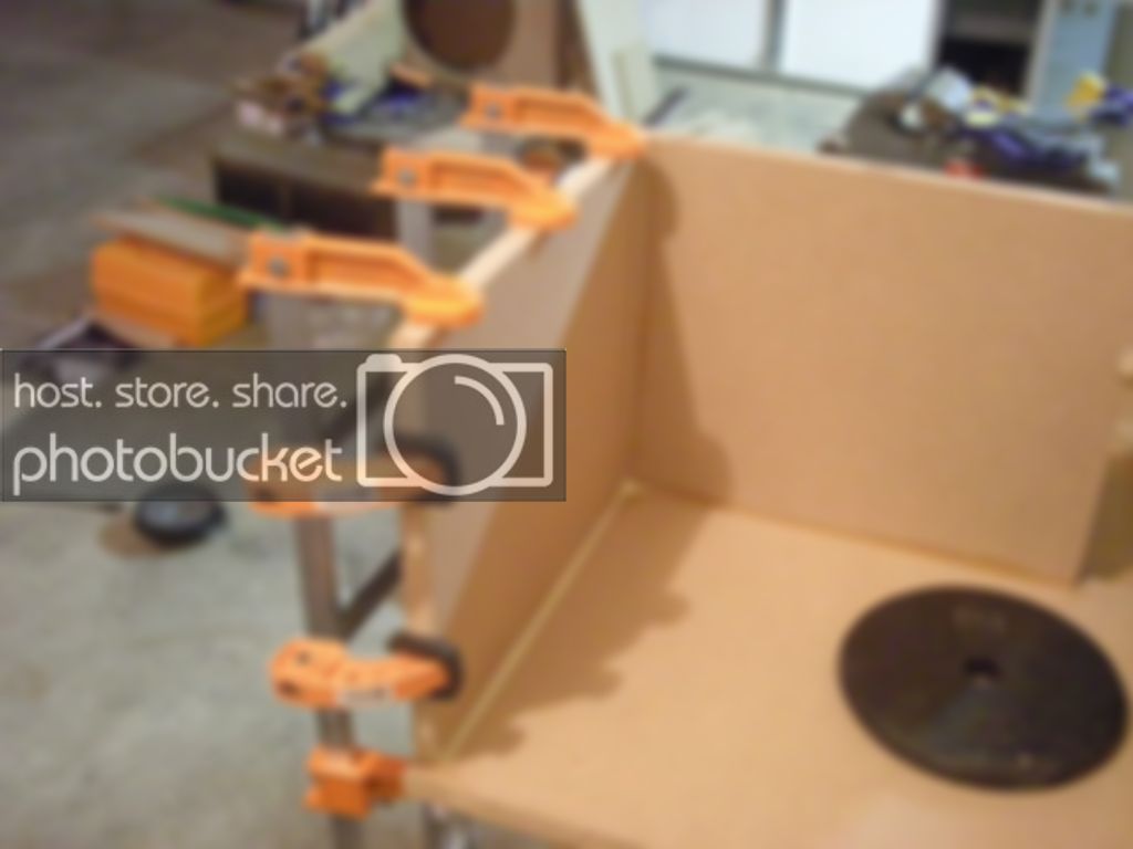

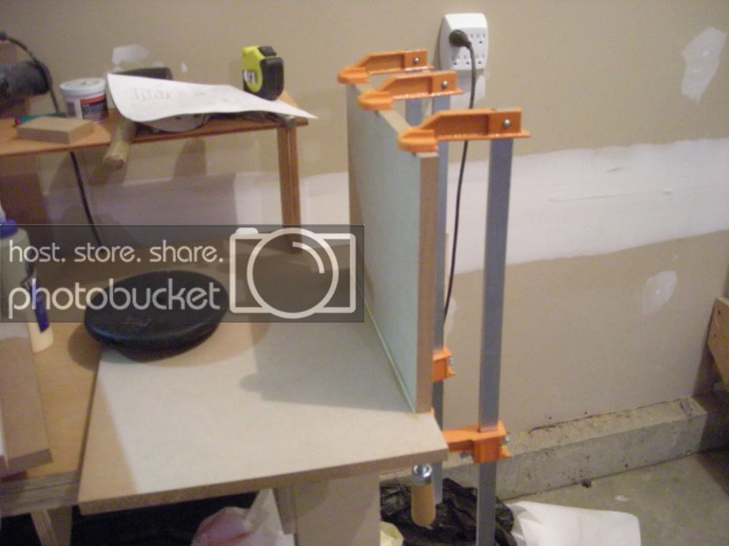

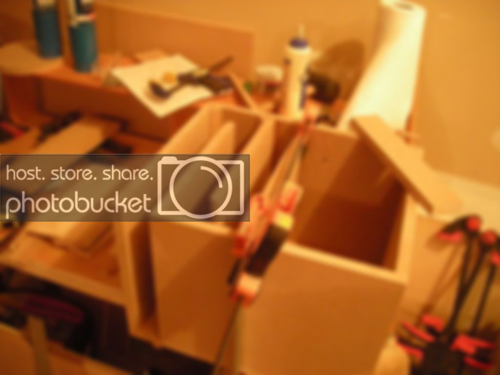

As is sits right now...
Getting there, but we've been having power outages (southern ohio)...it's been really bad but specifically my neighborhood is the only one in the area with power //content.invisioncic.com/y282845/emoticons/smile.gif.1ebc41e1811405b213edfc4622c41e27.gif//content.invisioncic.com/y282845/emoticons/woot.gif.aaa6090e619a97b6090d16dd863c5a69.gif...only lost power for 2 hours today, thankfully

Thanks guys, and yea...sketch-up is usually what I make my enclosure designs on to get perspective with...but this one was all on paper that I sketched-up really quick.

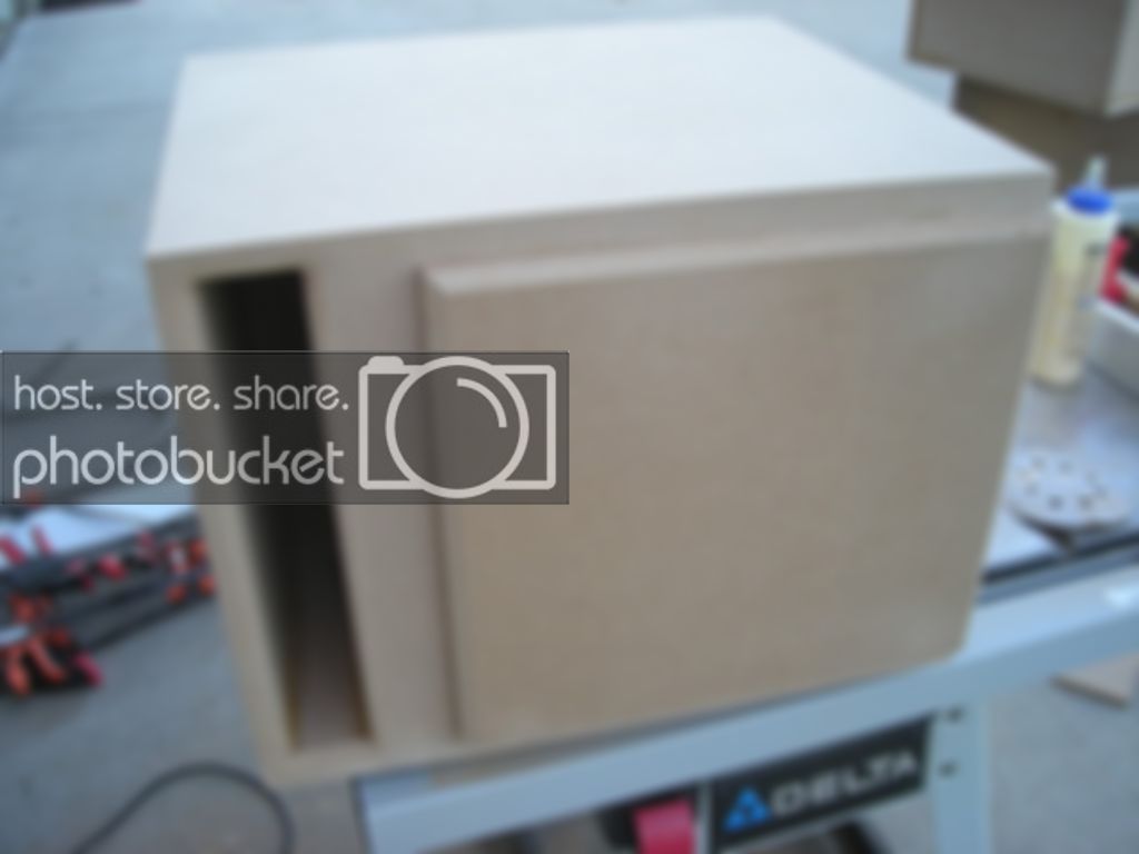

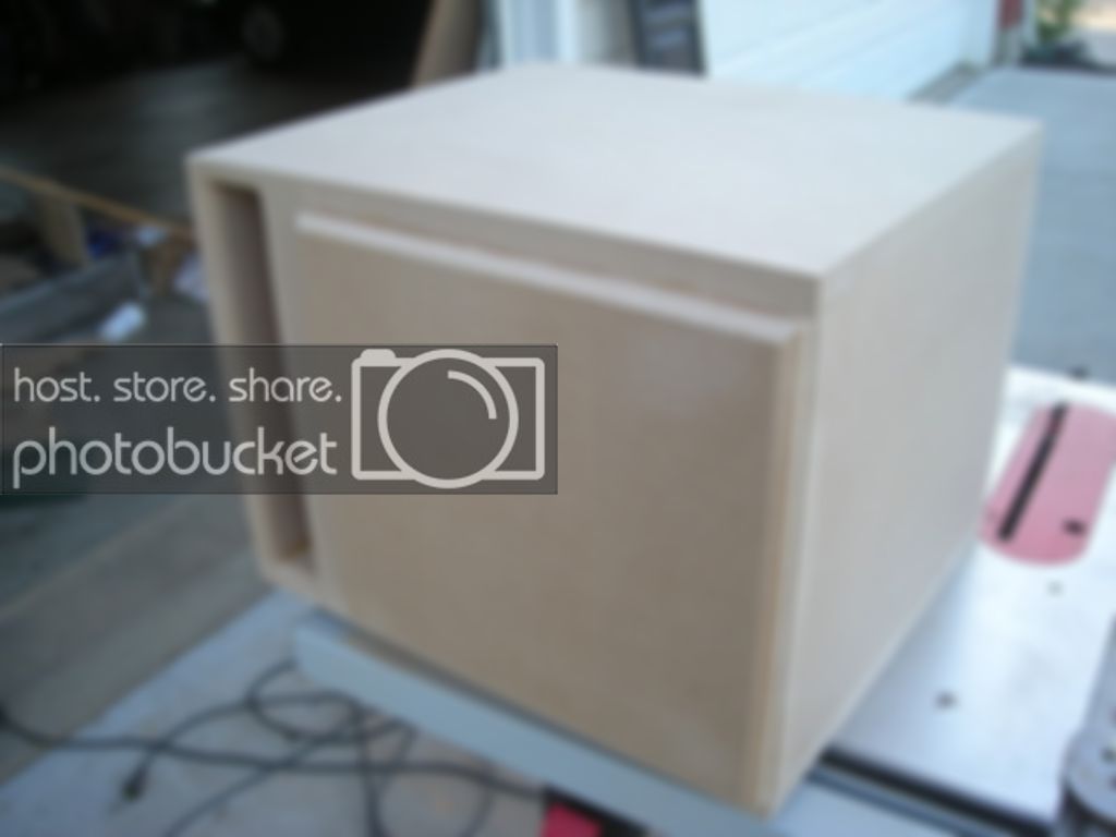

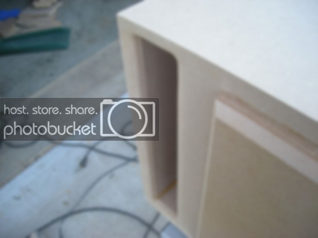

Just glued and clamped on the front double-baffle piece, rounded over the port opening, and chamfered the double-baffle (and cut the hole out)..
Here it is..

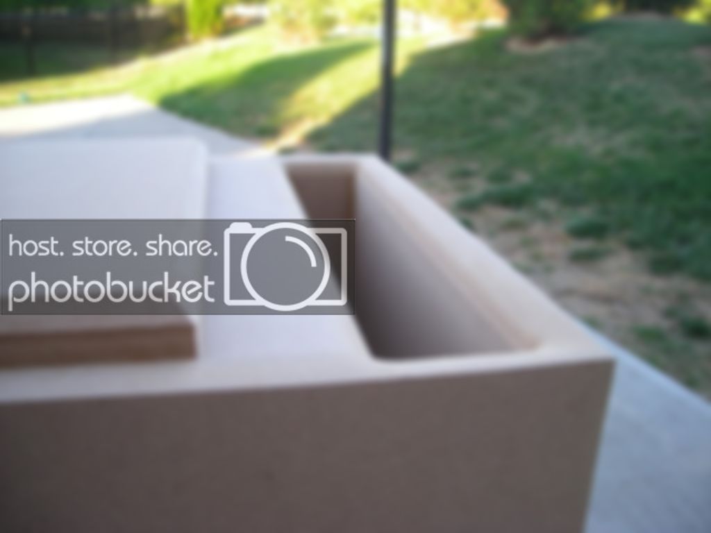

Rounded over the port..
