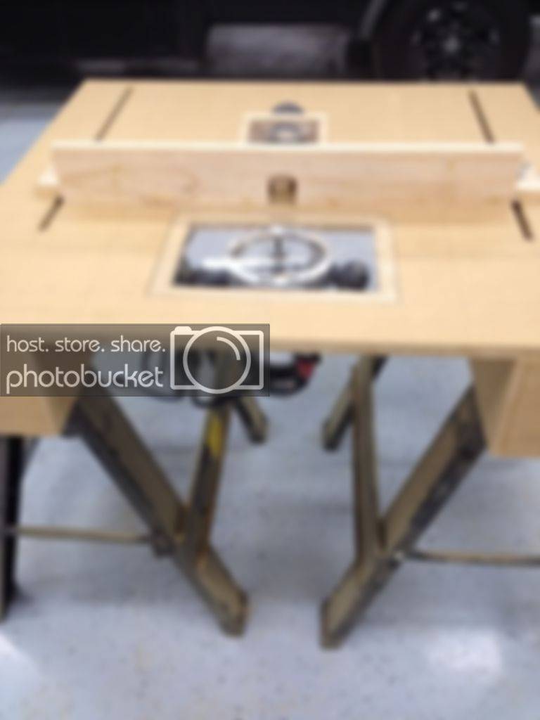

For those that need a larger router table then what you can find at the local hardware chains but don't want to spend the $300 plus or have the floor space to keep it, this is one that I built for a current build I'm doing. Thought I'd pass it along.
The sawhorses I picked up from Harbor freight for $30.00. I made the "planter boxes" out of 1/2 MDF to give them some more height.
The fence was built out of scrap wood and plexiglass I had. THe plexiglass box was implemented so could hook up a shop vac but still see the router bit when I was doing close cuts.
Simple and easy 1/2" bolt with a wing nut to adjust the fence.

3/4" MDF for the top, slots cut out so the 1/2? bolts will slide and keep the fence somewhat square to the router bit. Remember, because the router bit is not a strait blade, the fence doesn't have to be perfectly square like on a table saw.

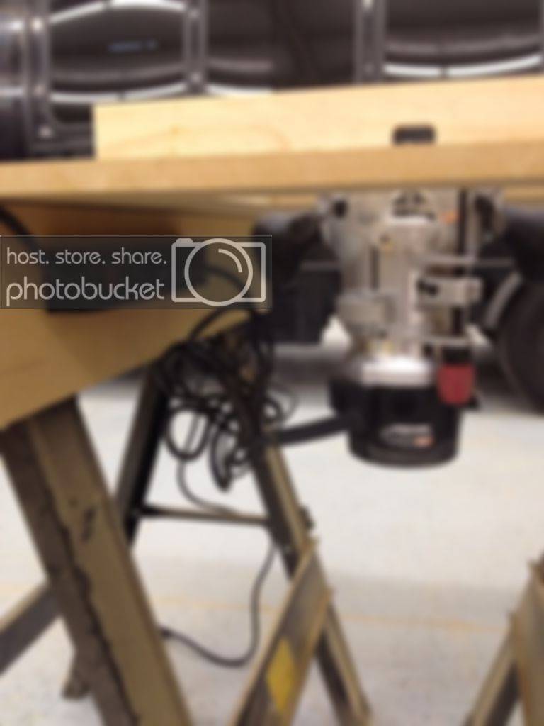

mounted a power strip to the side so I could plug both the router and shop vac in and have one switch to turn both on and off. Make sure to position the router with the bit adjustment facing you so it's easier when you need to adjust the bit height.

and the finished (for now) project.
Big enough to handle most any job yet can be broken down and put away in less then 10 minutes.
