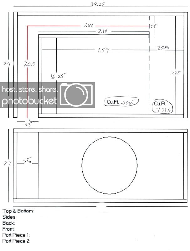

port problem
So if your external height is 24 inches (2 feet), that gives you an internal height of 22.5
At 112 sq inches of port you would want a port that is 22.5 inches x 5 inches.
My advise would be to make the box wider and not as tall.
If you were to be looking at the side of the box that has the port, the sub would be mounted to the left or right of the port depending on which side of the box the port is on.
This is not to scale!!! I did not feel like going onto my other computer for sketch up...
