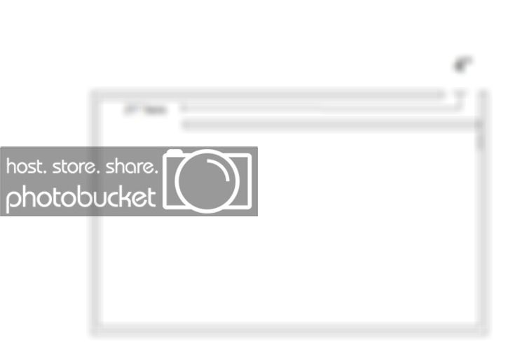

TMali 10+ year member I Can Dance If I Want To 2,887 15 New Hope/Big Lake MN Feb 11, 2010 #1 with a bent port where do you measure on the corners? my port needs to be 21"s long but where do i measure from?? Click to read more...

K kmanian 5,000+ posts CarAudio.com Veteran 8,890 63 Grand Cayman Feb 11, 2010 #2 the middle between the 2 you have listed

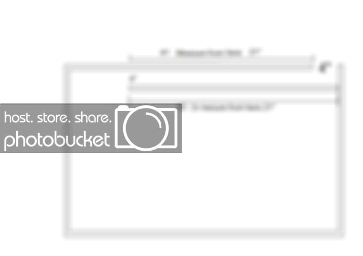

OP TMali 10+ year member I Can Dance If I Want To 2,887 15 New Hope/Big Lake MN Feb 11, 2010 Thread Starter #3 So like this then
Ronny 10+ year member CarAudio.com Elite 734 13 Grand Forks, ND Feb 11, 2010 #4 So like this then Click to expand... Yes, right down the middle.
