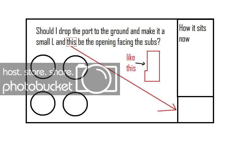

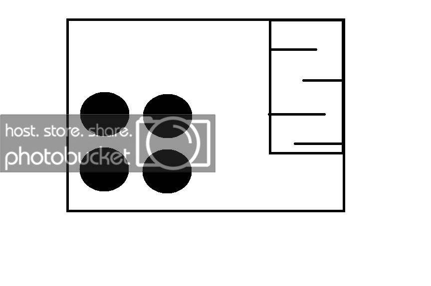

My box is 26.5" tall.. the required port length is 33.45" to be exact.. besides sticking out of the box 7"+ can you add walls inside the square port almost like a maze inside the port to make the length longer?

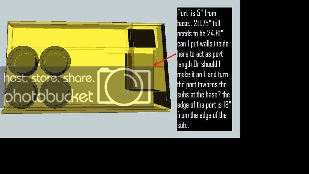

This is what I did for a port since doing a long L-port would come in contact with the sub
this is what I had in mind I didn't want to do it in sketchup since it takes a second
---------- Post added at 09:04 PM ---------- Previous post was at 09:03 PM ----------
that is the front of the box subs firing forward port up.. you can see through the box at the port but its working its way up
If you bring down the 20" dimension for your port around to 15 (thats 45 sq. in of port area, 3.5 cubes is ~42 sq. in minimum) then you cut down 10" on your port length if you are aiming for 33hz.
