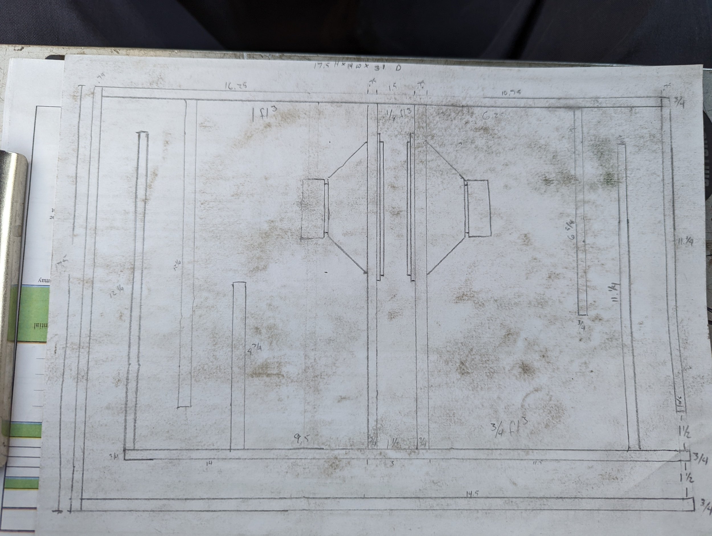

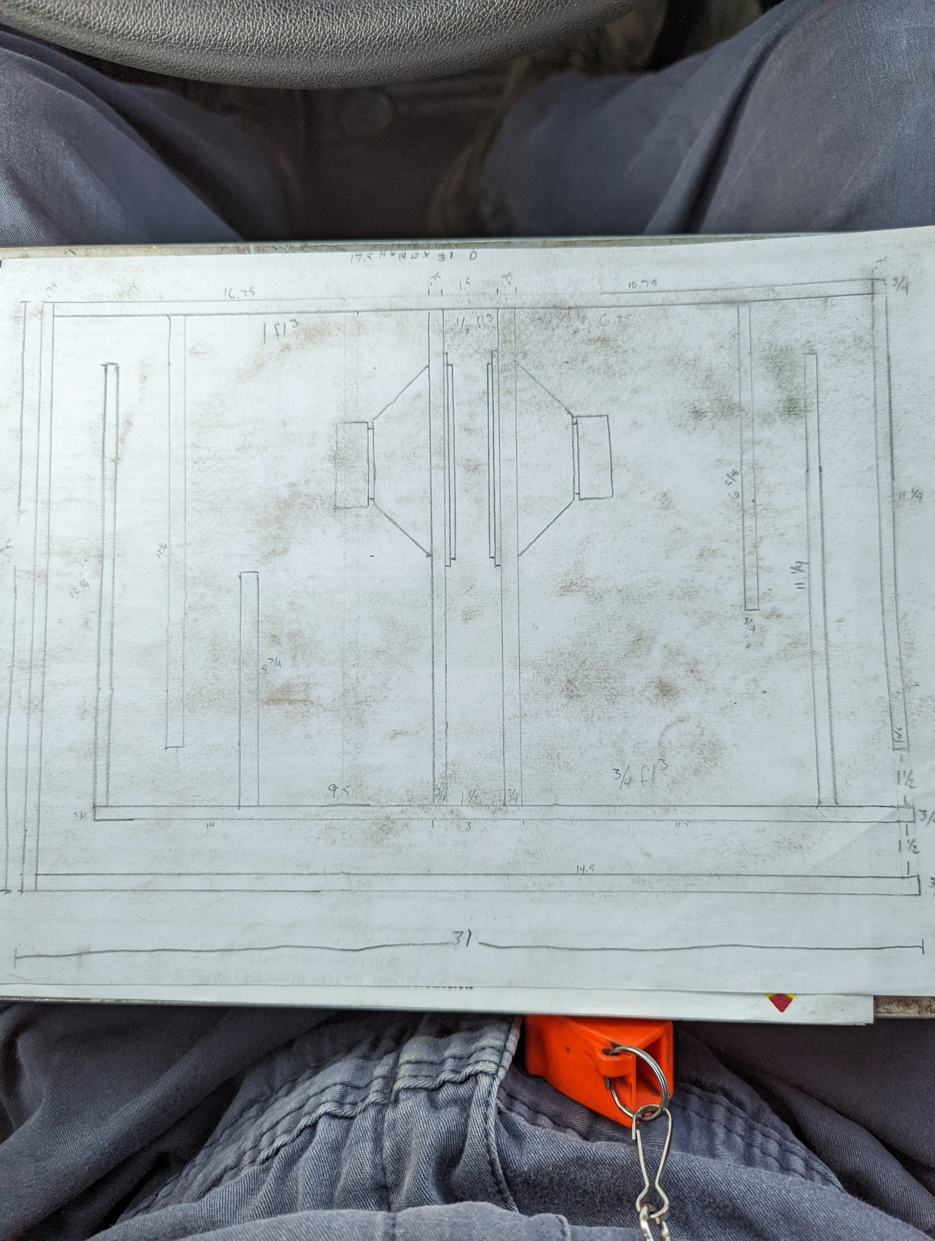

Ok proof your advice wasn't a waste of time.
I went out and bought a 6" PVC Pipe. $55.
Cut it at 34" 2.6 Cubes after Port displacement.
FS of 712: 28.26.
Tuning to 28HZ.
