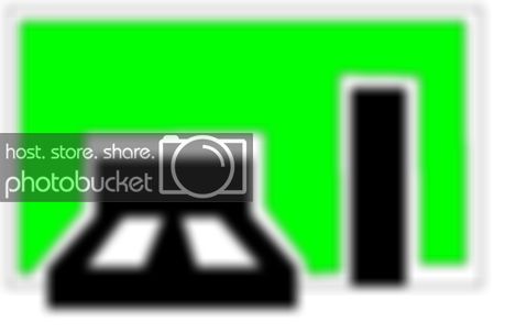

Ok, another question, sorry for all the questions but this is new to me and i cant find these answers... When i account for the size of the enclosure, which i want to be 2.2 feet cubed, is that 2.2 the green area in this picture?
Or this picture?
Ohh, and how far from the sides do i need the subwoofer? And can i make this port upfiring with the sub in front? Because with the dimensions of my car, i cant fit both the port and the sub on the front panel.
