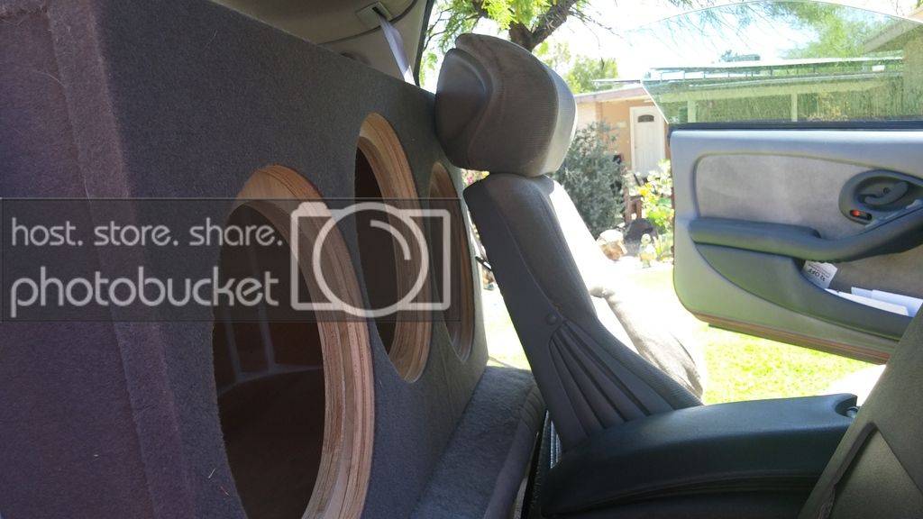

Well its going in a hatch and ilthe box is too big for the tiny space so heres a pic of a mock up with the empty box
Idk whether to face port on driver side or passenger or maybe even face subs up or they can be faced at an angle towards the rear hatch glass

this is actually a good question but will be hard to get a sure answer due to each vehicle being different, some vehicles do better subs and port firing off trunk, some are better sub back port side. The most comon is sub and port forward into cabin and seal off trunk from what i gather. The porting through rear deck is one that i see people do the least.

To give you some insight, it is my understanding that the direction of the subs is irrelevant in a ported box. You can essentially think of it as the port playing the music, not the subs. Having said that, I'm not sure which direction the port should point in your vehicle. I've only had subs and ports always point toward the rear of the car. My gut feeling says that you shouldn't have the port firing up though.

I feel like you still need to give the subs room to breathe though. If i made a wall for my trunk but only gave the subs a few inches of space between them and the seats when their up. Id be willing to bet that'd have an effect. Wether it be cancellation or peaks or something..
Ive never done an install like that but i would think that it wouldnt be so much as room for it to breathe but enough room that at full excursion they dont bang against the seat and cause an issue with the sub
Yeah, I would agree with that. As long as there's enough clearance for them to reach full excursion, should be fine.
