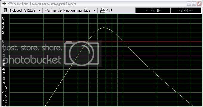

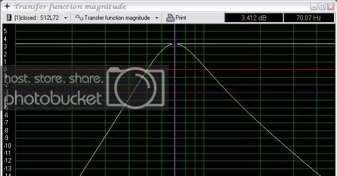

Sticking strictly to the numbers...a 2.0 cube box filled 50% would be 1 lb of loose polyfill,,, saying that you actually acheive the supposed 30% increase, that is (at BEST) making the sub think it is in a 2.6 cube box. Win ISD Shows you the difference on paper...
2.0 cube-no poly fill
2.6 Cube - 1 lb polyfill
