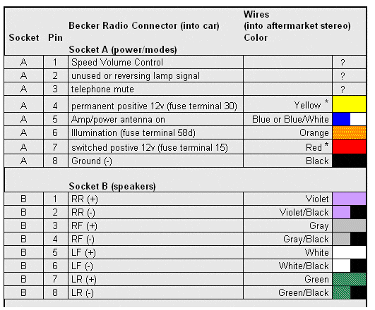

Here is the stock Harness diagram if needed:
