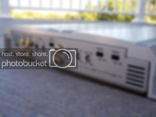

I have the following:
Eclipse EA3532 5/4 Channel Power Amplifier
with ChannelFlex Crossover plus Subsonic Filter
Kenwood KDCX697 HU
PHOENIX GOLD RSD5CS Components for the front
On the manual, it shows the amp is capable of running at 4Ω bridged 120 rms × 2 (Front/Rear). I'd like to run this exact setup for my front components. Is this doable? I am thinking I can run 120 rms to the left front component and the other 120 rms to the right front component. If this is possible, how would I wire the speakers wires to the amp?
Another question, would I need both pairs of RCA from the HU to the Front/Rear input to amp? or I can get away with just running a pair of RCA from the HU to the Front input of the amp?
Also, what setting on the amp should I set on the amp to make this possible?
Thank you
