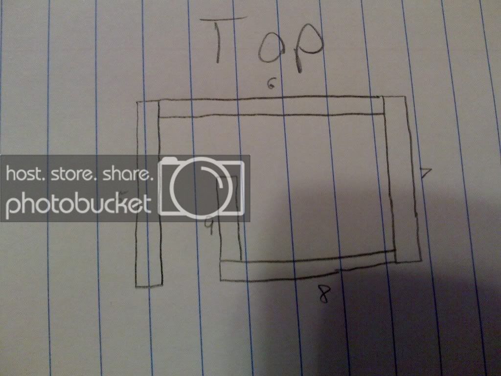

hey guys im needing some really quick help! i planned on using subwoofer tools to design my box but their site isnt working on my computer and i need them asap! the box needs to be 5 cu ft tuned to 38hz
30 wide by 17 tall by 25.5 deep it had 69 sq in of port area since i raised the xmax more than what it really is..
btw the sub is a mach 5 audio spl-15
i'll post pics of the box when its done too i just gotta get my designs back!
thanks in advance for any help!
edit: had a 0 instead of a 9 for my port area
btw the sub will be mounted facing the rear along with the port //content.invisioncic.com/y282845/emoticons/fyi.gif.9f1f679348da7204ce960cfc74bca8e0.gif
ah i believe i just figured out the port.. i think it is supposed to be 15.5 tall and 4.5 wide.. that would give me 69.75 which is what i had for port area.. so .75 on top and bottom of that gives me 17 inches tall (my main worry) so i think i might have figured it out.. im going to spend a few minutes and do the math again to double check myself.. thanks for the help and if you would like to draw them up for me or continue to help me with the designs that would be greatly appriciated!
ok when you look at the top view of the box how deep back should the port go? thats the only length im missing..
i'll load a pic of my drawing.. please forgive the sketchyness!
but its number 9 that i need help with!
come on ca i thought you had my back! //content.invisioncic.com/y282845/emoticons/frown.gif.a3531fa0534503350665a1e957861287.gif
well i gave that a shot but i couldnt get the tuning freq high enough since you cant change the sq port length #1 highest i can get the frequencty is 32hz //content.invisioncic.com/y282845/emoticons/frown.gif.a3531fa0534503350665a1e957861287.gif i know i gotta shorten that length but i dont know how much.. lol
bump.. all i need is 1 length figured out! i would do it if i knew the math but i dont //content.invisioncic.com/y282845/emoticons/frown.gif.a3531fa0534503350665a1e957861287.gif
if you dont wana do it you can tell me how and i'll try to figure it out..
