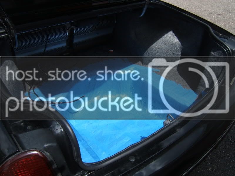

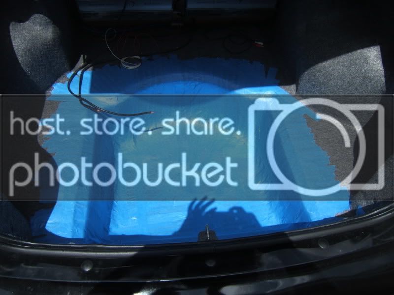

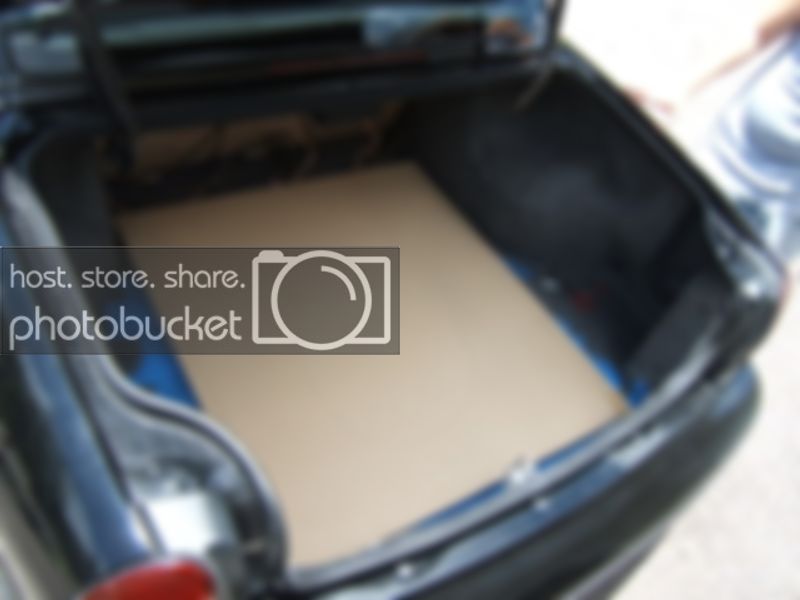

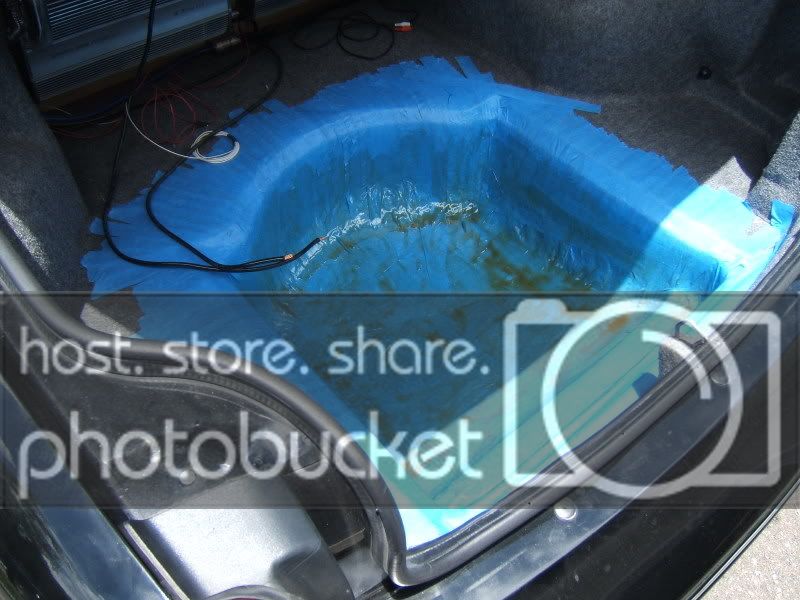

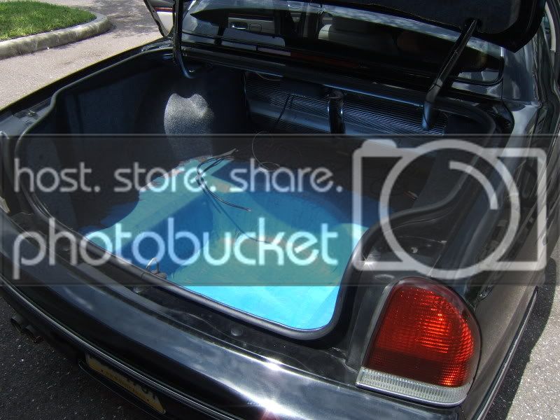

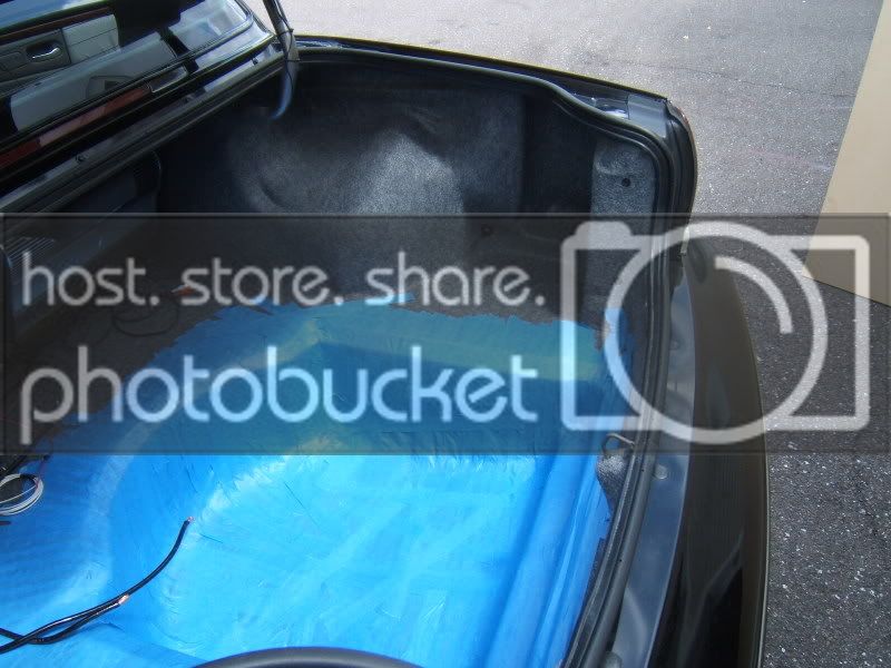

Started the project off by taping off the entire spare tire well. spare was a full size spare on a 16 inch rim

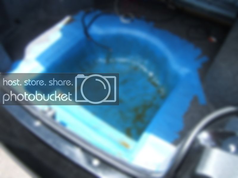

A single layer of resin in most places, just to get a base idea on how much resin would be used

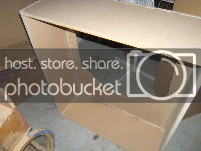

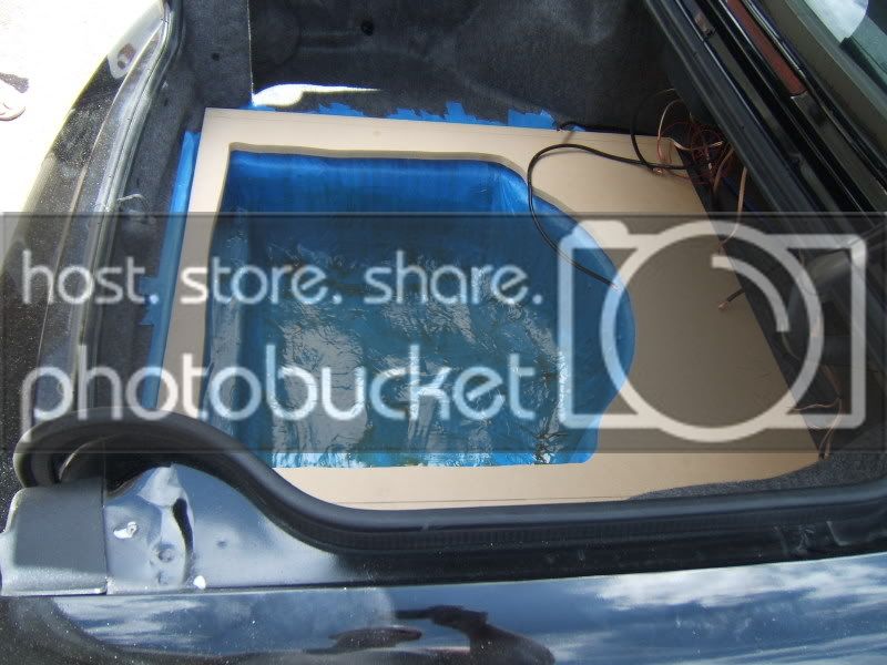

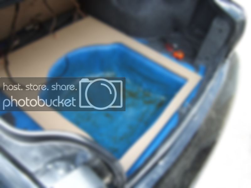

Here is the itial test fitting on the bottom piece of the box

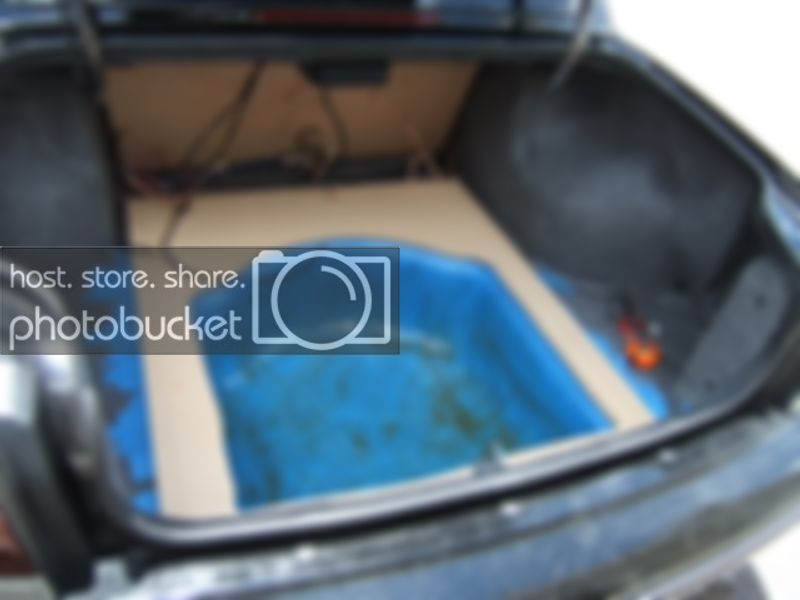

More pics of the beginning portion in Tampa.

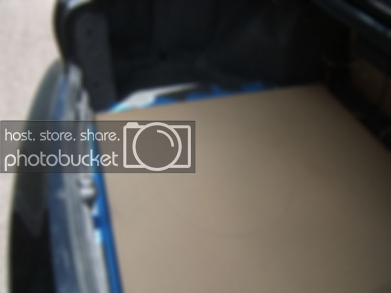

bottom test fit of the wood itself, just still getting an idea of how everything may work itself into place
thats a pretty big F'er right there

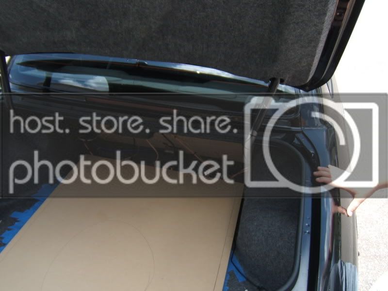

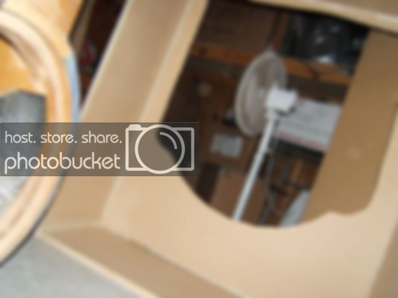

here is the first pic of the cutout of the trunk fitting piece (bottom)
If you notice, it looks off center, ill explain why later.
last shot of that one.

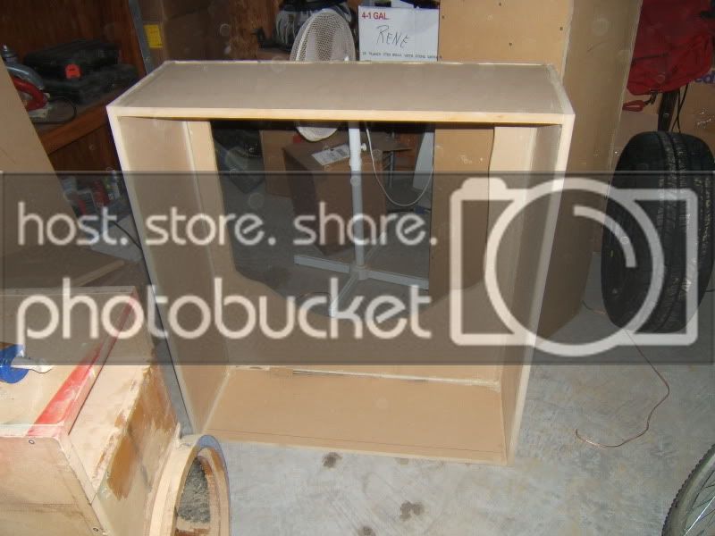

I build the botom/sides of the box, and sadly it was too tall. Not too tall to fit in the trunk, but it fit right between the two pieces that come down in the back when you close the trunk (which is why the piece looks off center, because as is the spare tire well. It itself is off center) there are 2 springs on the inside of those hinges that i didnt realise existed until we test closed the trunk, and it just did not work. they came down on the box themself, and there was no way around it, the box had to be smaller. I didnt get any pics of this, but i did come up with a remedy for it. I had to trim one inch off of the entire box, which allowed those hinges to move freely, and allowed the trunk to close.
here ti is after that cut
