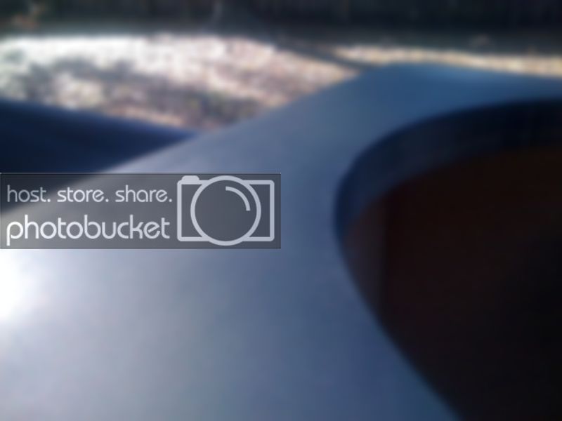

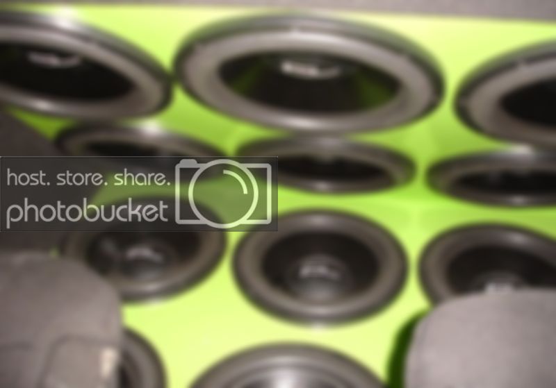

Pictures of painted boxes

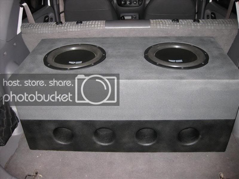

That looks sharp, what'd you use?
How did you get that look? Looks like what i do with rhino liner but colored.
I mix my paint to match what I want, and I mix ceiling texture in with it. And just roll it on. Covers very well and looks nice, and is actually durable.
you mix the tecture in and let the paint soak and settle with the tecture for 30 min before you use it.
I use mediam size texture, the more you add, the more tecture there is. I also put about 2-3 coats of primer on too.
Everything is rolled on, except for the port which is rattle can. My way is definately alot cheaper than liner
