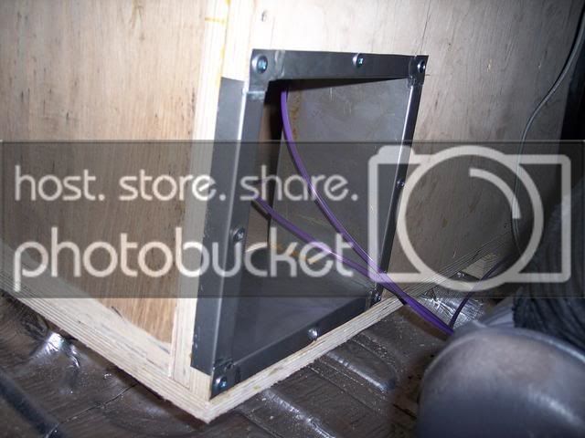

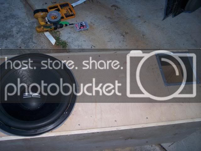

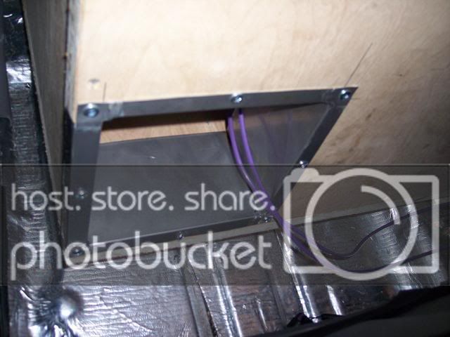

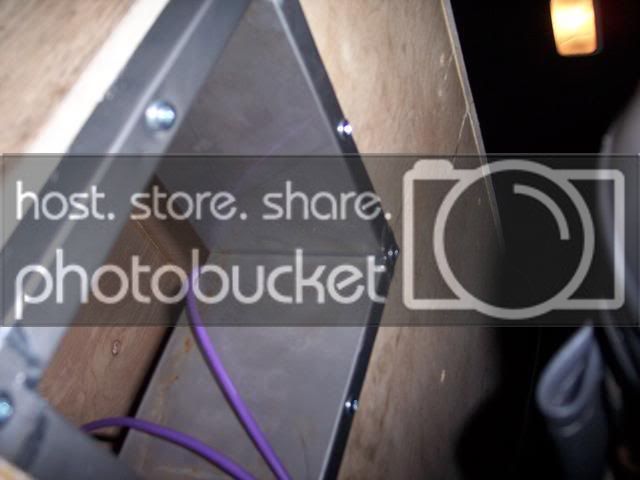

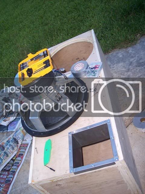

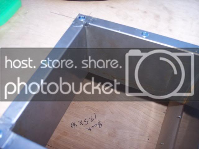

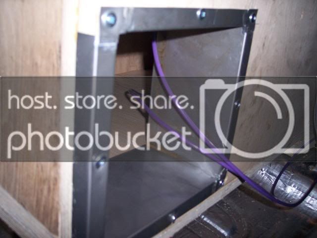

made this port out of stainless steel in my sheet metal shop, it's 24 gauge, it doesn't flex at all, i hem'd the bottom edges, you can stand on it, it doesn't move, it's exactly 4.98 inches deep, 8 inches by 8 inches.
i can make more of these ports, if anyone wants one.
this setup bangs hard. very smooth response. fairly impressed.
pics in 2 minutes.
sure, i might need to clean my truck.
and buy a carpet.
that rust it shows is surface rust. it only goes on one side, and i ****ed up and put that on the side that shows.
not going to make any difference though.

pretty short port, tuned really high?
yeah man, 48hz, it's where my truck resonates at.
i am making another port at 28hz tomorrow with a 6x6 hole, that will have a 4 inch flange on it.
pics of that tomorrow.
that should get hte lows banging more.

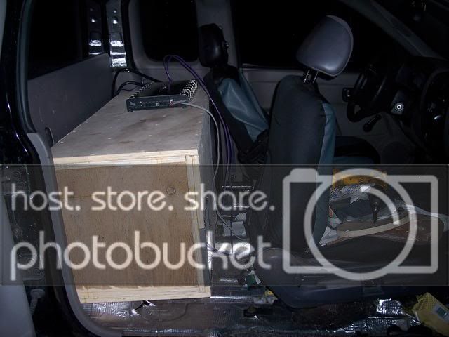

good luck with your electrical! this one is dropping me to 11volts on every bass hit.
and it's got a 160amp alt in there already. and a fairly new ACdelco.
they are some serious power hungry amps.
wood not work for ports anymore?
Metal resonates differently than wood also //content.invisioncic.com/y282845/emoticons/wink.gif.608e3ea05f1a9f98611af0861652f8fb.gif Just a though
Just alil hint for ya if your trying for SPL....and seeing that you tuned to ~48hz, you prolly are:
Try sub and port up....sub on passenger side, port on drivers //content.invisioncic.com/y282845/emoticons/smile.gif.1ebc41e1811405b213edfc4622c41e27.gif
