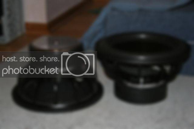

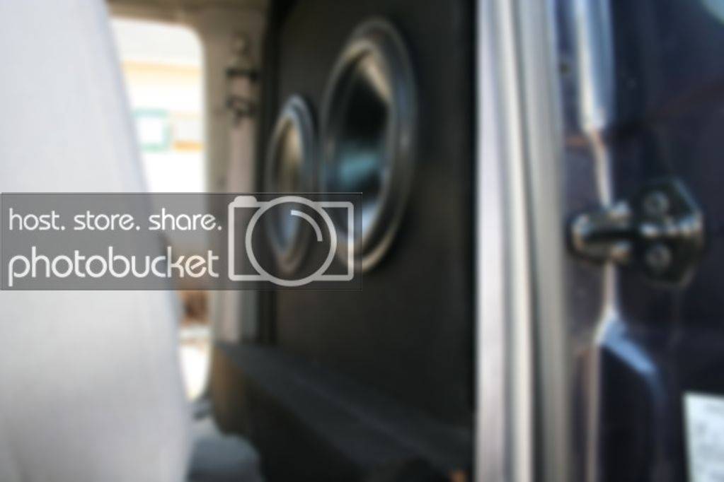

well i thought id post some pics of my build now that is in and done. all the equipment is in my sig:) but here are some pics of the subs, amp, then the wall in and done.

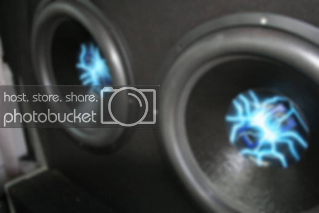

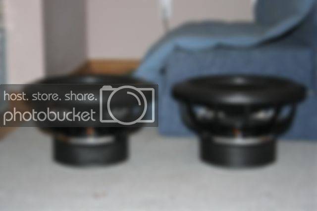

the subs (2 15" DC LVL4 XLs)

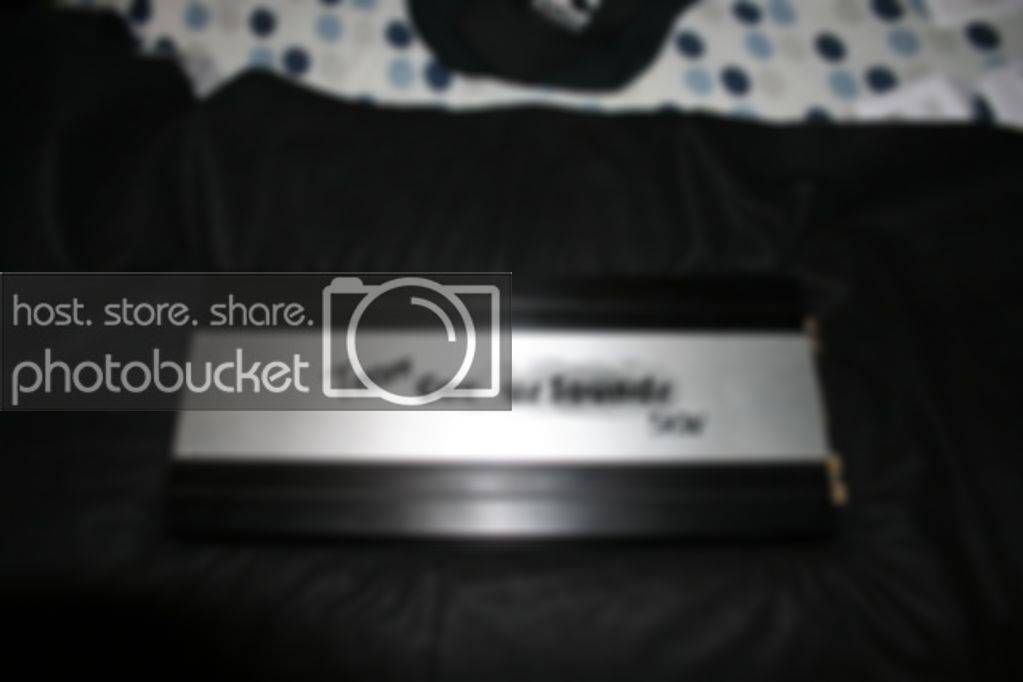

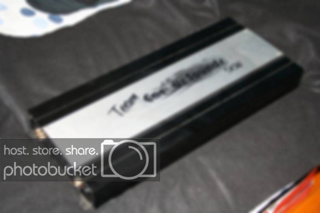

the amp (Cactus Sounds Team Cactus 5k) 5600+rms

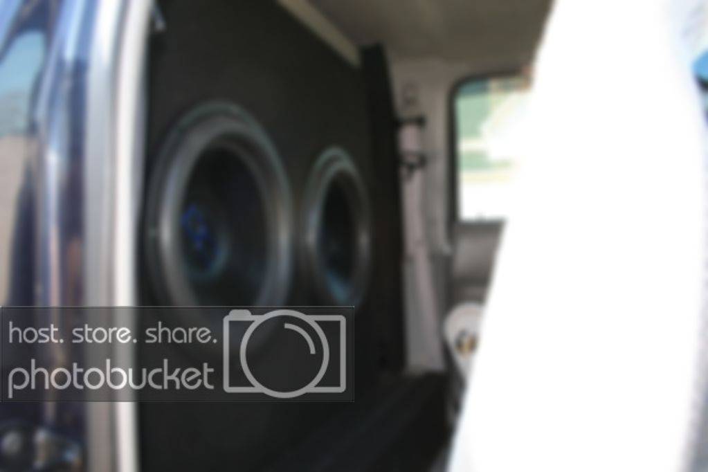

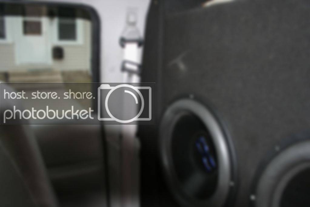

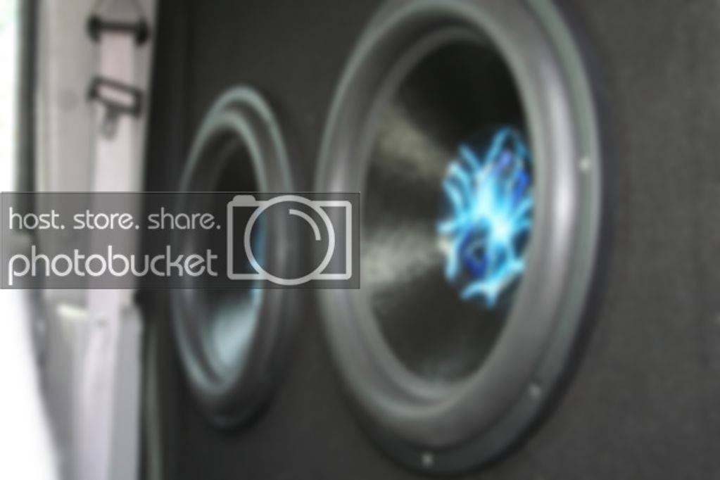

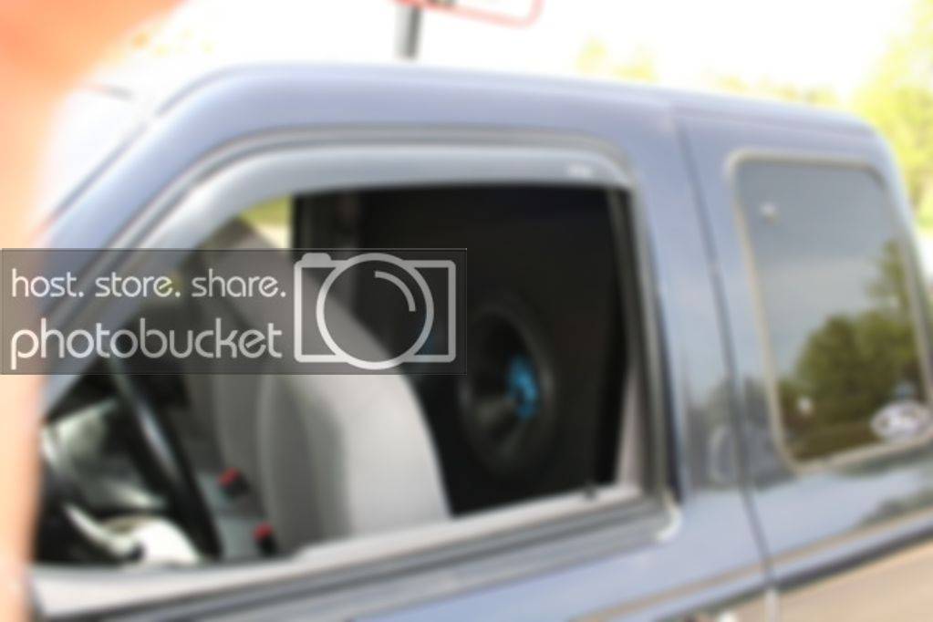

The wall, 8cubes before subs, bracing displacement. 105sqin of port tuned to 32hz
these last pics were before i got the airbrushed dustcaps, still same subs and everything.
as far as numbers go, back when i had my Hifonics XXV Colossus in there(1700rms) per sub it did a 147.2 on music at 37hz sealed legal on the dash. hoping to see that number go up now that there is 5500+rms in there. but all in all im very happy w it, its doin wat i built it to do. great for daily demo vehicle. its does decent numbers for 2 15s, but like i said i hope that goes up w the added power from my cactus 5k. well see wat it does now this coming saturday at the first comp of the season:) thanks for looking guys, let me no wat ya think.

Nice and clean build, very nice. Dustcaps are very original.
thanks bro! when i had the Colossus in there they were D2 subs running 2ohms, and when i bought the cactus i sent em out for D1 recones to get full potential outa the amp and subs, and i seen the new dustcaps that rusty at DC was offering and i had to have em lol. like i said tho im VERY happy w the build/install.
Normally I don't like stuff like that (dust caps).
But I have to say I like those dust caps a lot, as said above, very original, probably look pretty sweet when they are movin.
