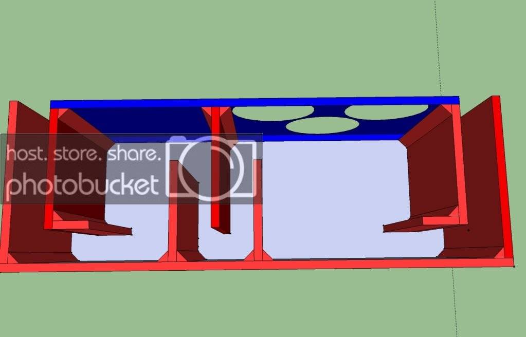

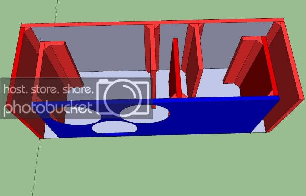

ive started the blue prints on my new box and unfortunately i cant fit all four Atomic Ap 8' in there so i started messing around with 3... heres the print.
i JUST received an email from Garry Springgay, i had contacted him a few weeks ago about doing some testing and analyzing of some build houses.. anyway.. hes the master when it comes to this Double Chamber Reflex's and he shed some info on this Build!!!
looks like im going alittle bit bigger yet.. 5.7 cubes for 3 8"s
this is gonna be deadly!
