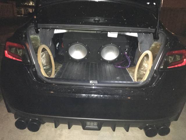

Pics! 2015 wrx fiberglass enclosure progress
Began the cutting process today, most of it is pretty thick, but I do see some areas to work on

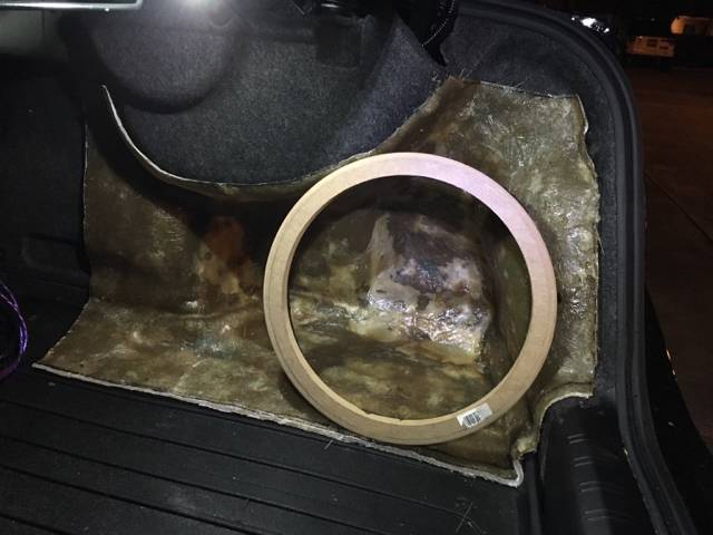

So Iv ran into a problem. The drivers side enclosure was cut too short. Is there any way to fix this?
Drivers side:
Passenger:

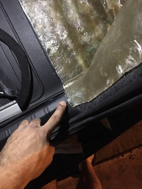

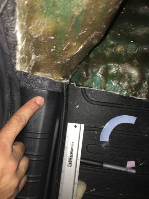

I'm thinking that maybe when I put the ring, I can makeshift some kind of solution... Maybe I should re-glass that area?
I know... I'm an idiot.
The glass is so thick in that area though. Do I just place it over and make it thicker? I don't really have any grinding tools thin it out. Will the resin have a strong enough bond?
It bonded with itself before didnt it?
you could could try glassing just the part you need and then taking your initial large piece and your small piece and putting one or two layers between them.
or just add more glass to your enclosure and fill in weird spots with body filler. Most of it will be inside the enclosure anyway so weird humps will make no difference.
depending on the resin you used. some companies mix wax into their resin so it dries a different way and you have to sand it a little to get it to bond again.
Yeah I guess it did, that was when it was all wet though. Like I mentioned, I don't know much about this stuff, so it's all a learning experience for me.
I'll probably try etching the edge of the enclosure so the resin can adhere to that surface better. Then put the enclosure back into the car, tape up the areas I need to add in, then put some heavy layers of glass. I'm trying to salvage as much airspace as possible since my initial testing didn't hold the full 1.5 cu ft of packing peanuts. Probably closer to 1.3

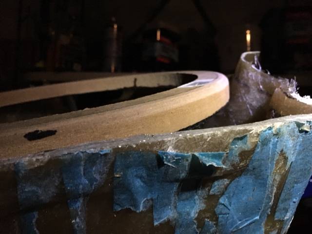

Progress! So Iv gotten as close as I'm able to with matching the enclosures. There's less than a quarter inch between the 2.
I glued down the speaker rings pretty symmetrically.
Hopefully by this weekend, I can get my front piece down and glassed up! Really happy with the progress so far.

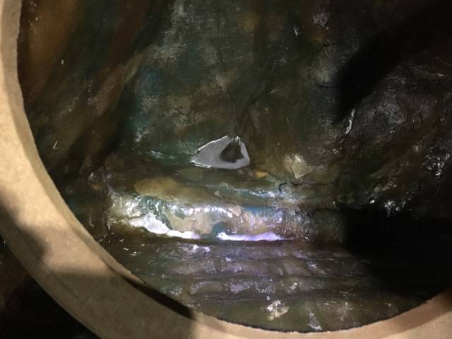

One small issue is like to point out would be when I resined on the ring, a good amount of it dropped and hardened at the bottom of my enclosure, causing me to loose a bit of airspace in my already tight build. Any of you think it's worth fixing? If so, how?
It's that blob in the middle of the picture.
